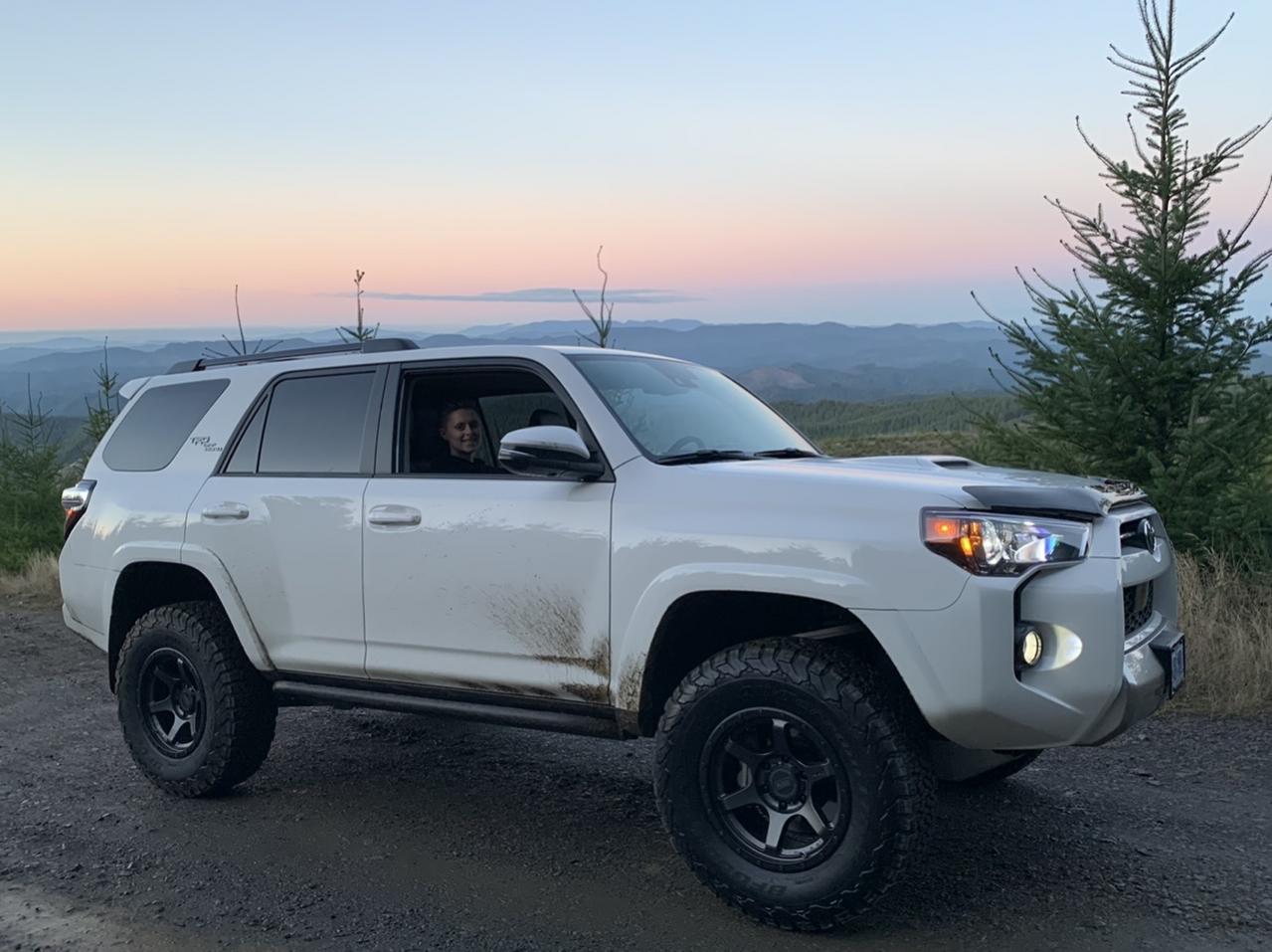

-12 offset, 8.5” wide rim width.
I do have 295/70r17 so this sticks out 5mm more than a 285/70r17 would.
I went ahead and did the BMC at the same time as mounting.
Personally, I think -12 or -10 is the perfect offset. I wouldn’t be happy with 0 I think. Many people run -38 but I don’t like that tire sticking out look.

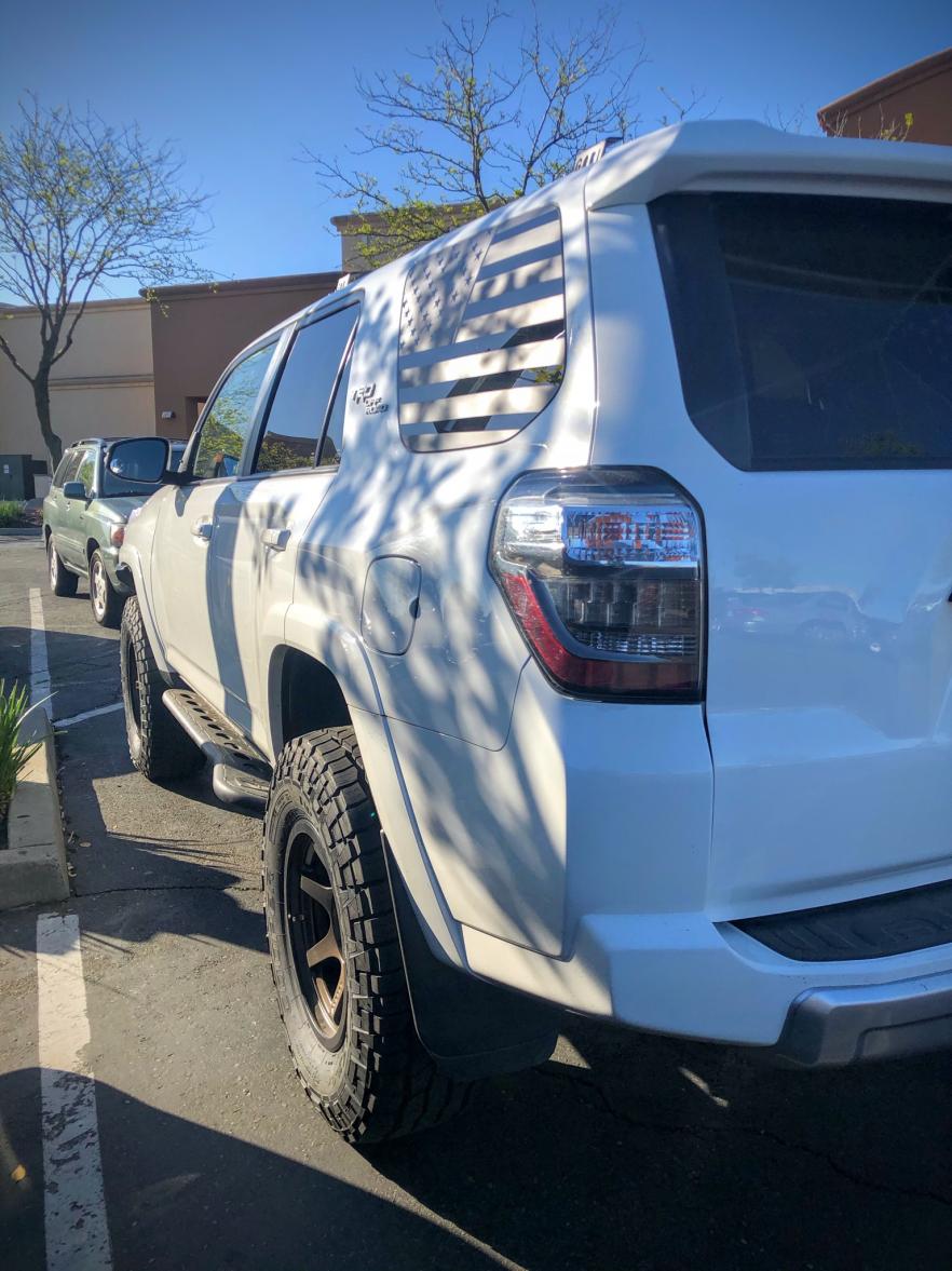

Purchased a set of RR2-V on an early BF sale. Gunmetal finish with Black- Specs are 17 x 8.5, -12 OS. I was looking for something without bolts, but price was too good to pass up. I’m glad my bolts are black, they don’t stand out. Quick delivery... Ordered on Thursday, shipped on Sat. and received Wed. RRW was out of lug nuts in black, so I purchased M12 x 1.5 ET from SCS- fit was perfect.
To prep for possible rubbing on/off road, I’ve trimmed the bumper, pushed back fender liner, removed front mud flaps and performed a BMTrim. No rubbing at all.
One week in, I like them a lot. The stance is perfect to my eye. Got off road this weekend. I’m slinging a little dirt/mud, but the sliders and rear flaps are catching most of it.

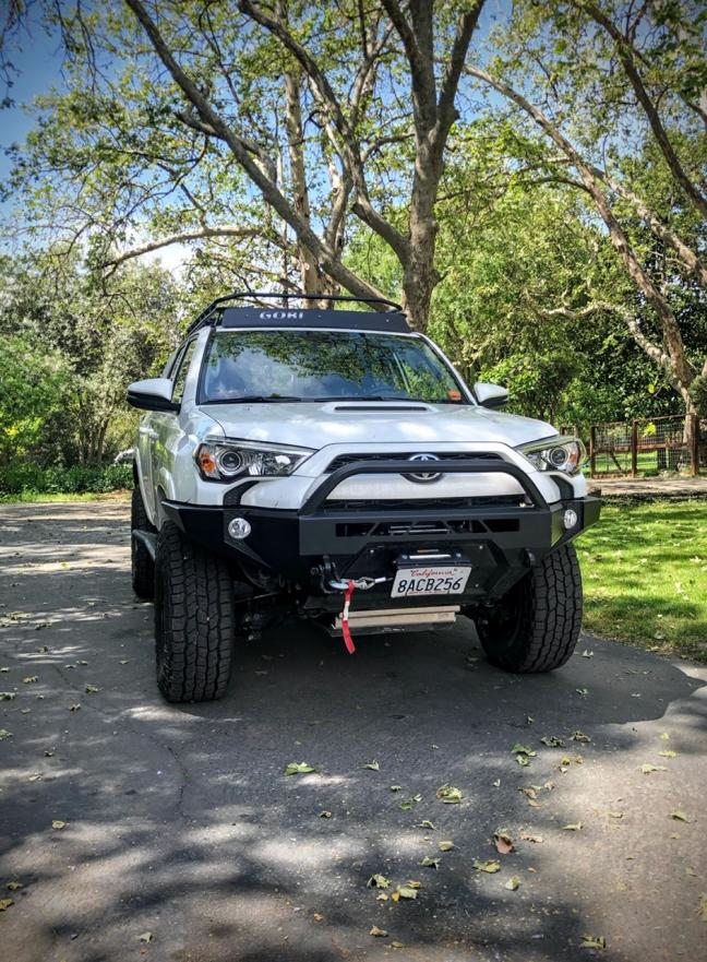

I have the RR2 wheels in bronze.

That prob wasn't me lol. I live in Colorado. And that's an old picture which I no longer have those wheels.

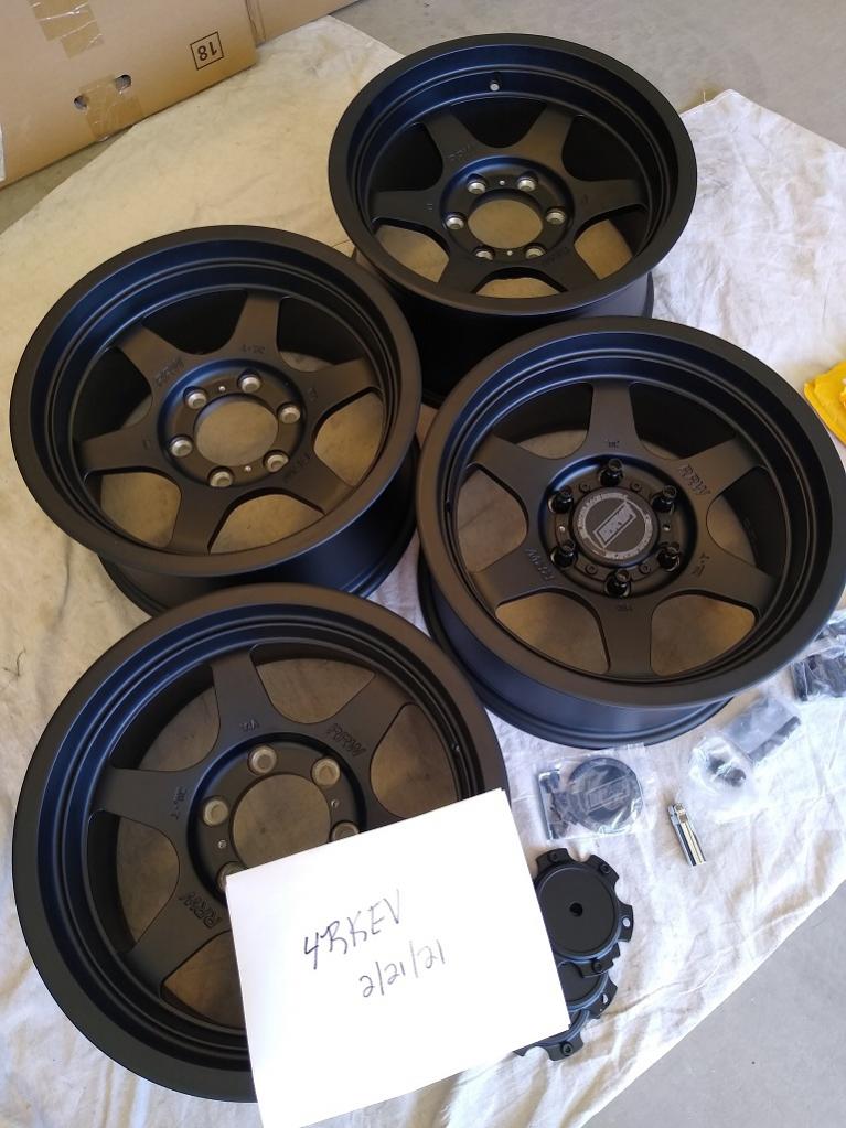

I have this set that took around 6 months to get. While waiting f5's came up for sale so these have been sitting in my garage for a while. I am hesitant to sell since they look so good.
