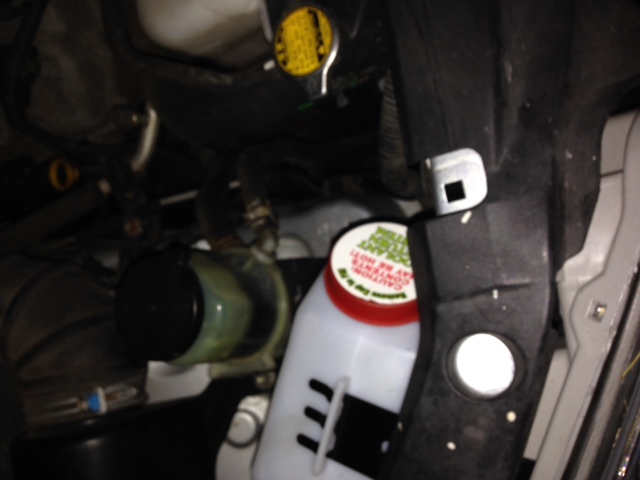

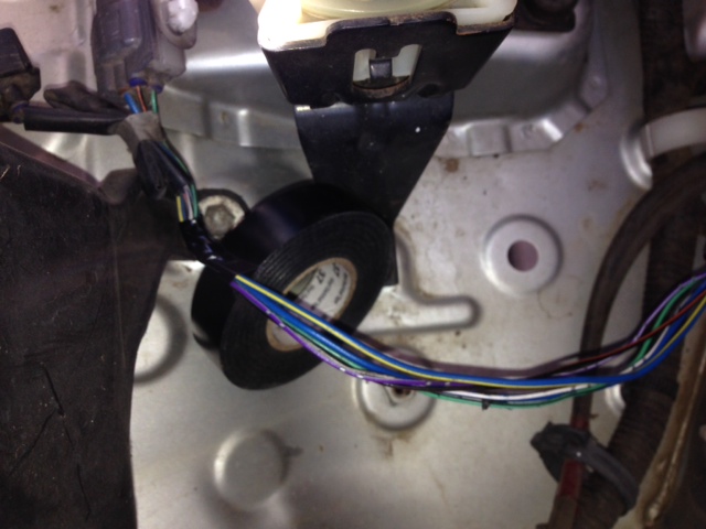

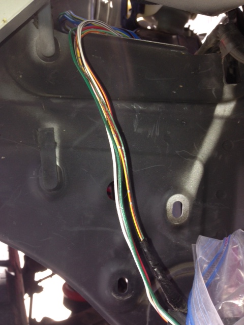

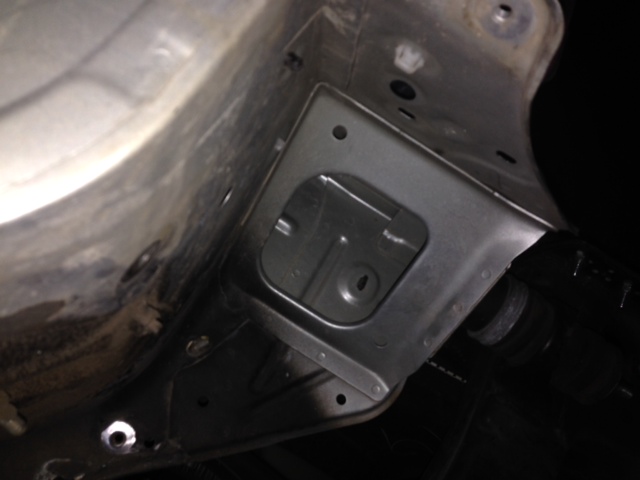

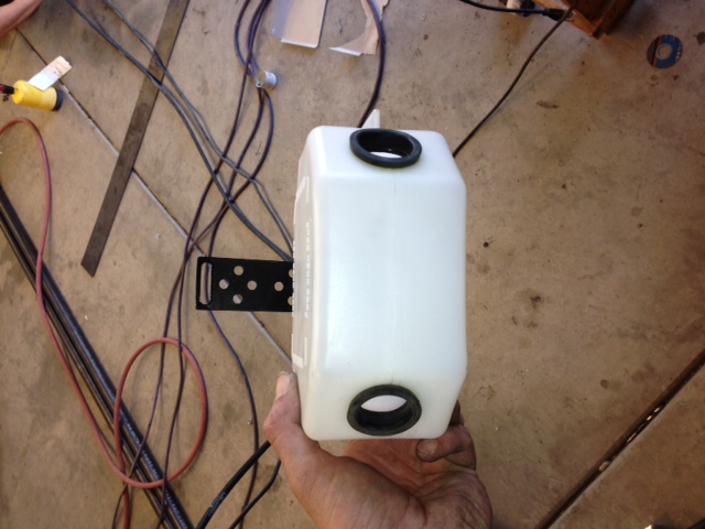

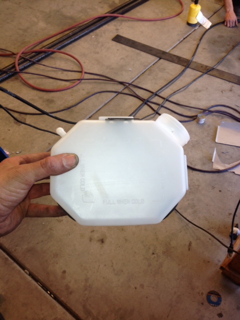

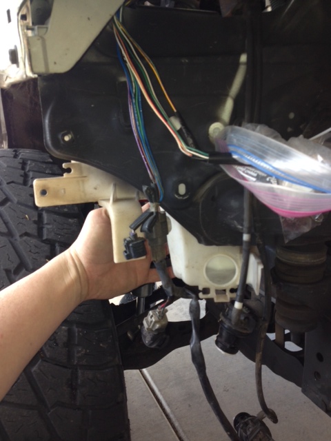

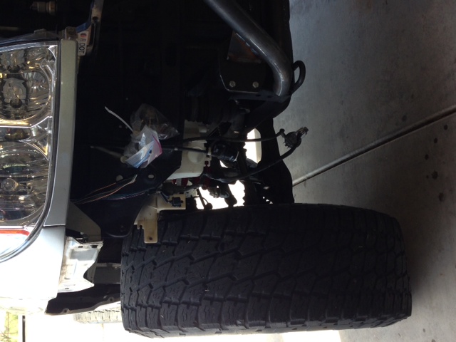

Decided with lack of a front bumper covering where the windshield wiper fluid container is located that it was time to move it. searching near and far and only finding a few really complicated forums covering it, I'm going to pass on what I learned this weekend. I drilled holes in the bottom of the new container to match the old ones, reused the same rubber grommets, had to cut the shrink wrap to separate the wire bundles and wrap the fog light/wiper wires back up. I purchased the new container at a local parts store its only 1.5 qts not the gallon that Toyota had. Plenty of room for a bigger one but i'm in sunny AZ and didn't see a need for it. super easy fix. now for the 4x4 square access hole to get to the body mount, I cut new metal to cover it up to prevent mud from getting in it.

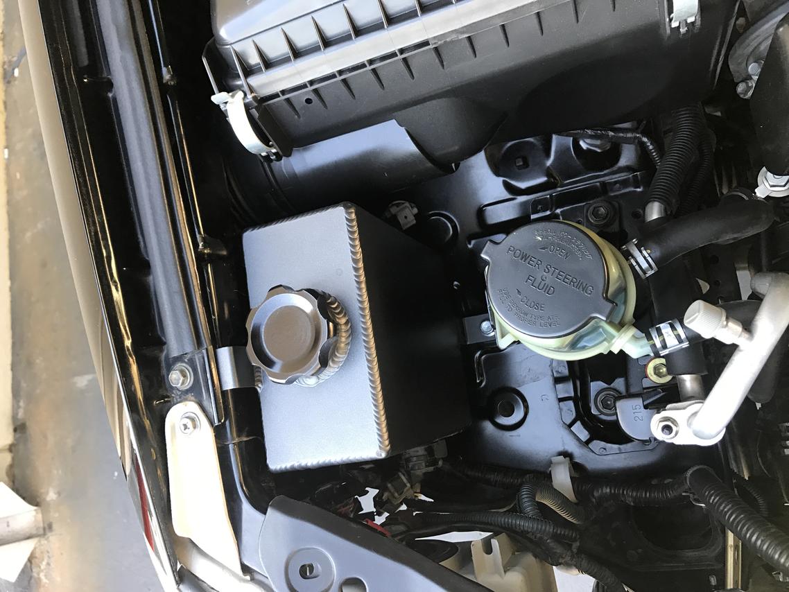

Here is my current set up with the relocated reservoir.
Dude that is tits :smokin:
Nice set up from RockSteady MotorSports. A bit pricey but looks like it's made to last for years with no real modification. Only holds half gallon of fluid compared to stock one but i'm sure that's still enough.

Bought one a week ago actually, will be adding a larger power steering reservoir mounted off the side of it eventually too.
