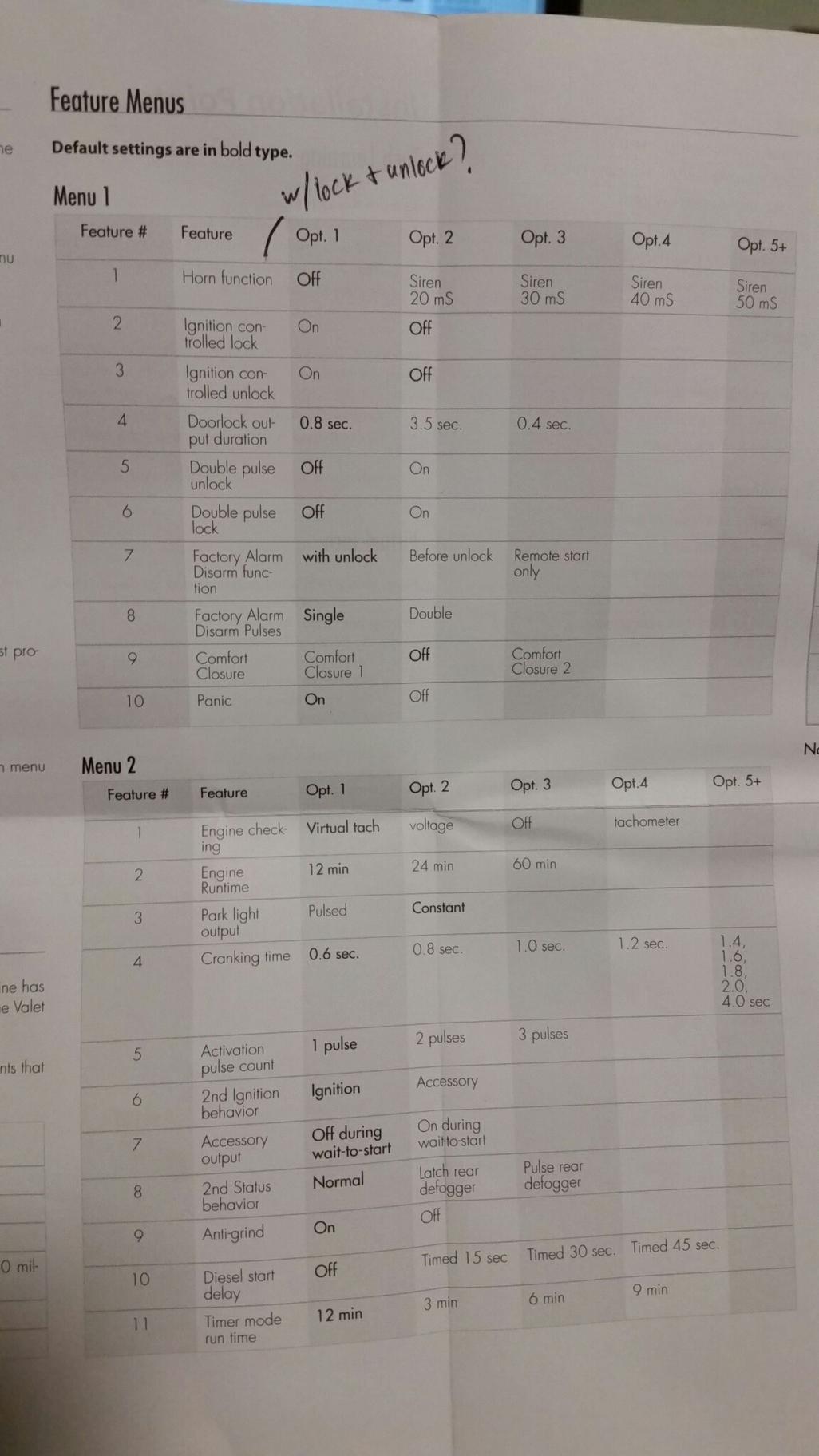

What I was trying to do was program it. But it's getting late and I'm not going to have my horn honking all night figuring this out.
Programming questions for the menus:
1. horn function. does that mean it chirps with lock and unlock? or just when doing remote start?
2. double pulse lock or unlock. what is this?
3. park light output says constant is the default yet my lights don't come on at all.
And If I'm reading this right, the valet button gets held until desired menu honks, then again until feature honks, then again until desired option honks.
