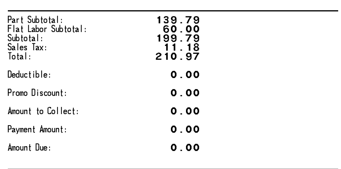

The safelite estimator put it at about $325 after taxes...... I'm debating on just pulling it myself, cleaning it up, and reinstalling it myself. ....
