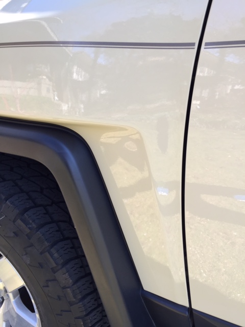

I have not tried this myself, but my dad got a scratch on the wheel flair on his FJ. The plastic is similar to the inside of our truck, maybe a little softer. He took it to a body shop and they heated it up with a heat gun and then laid cheese cloth on it to get the texture back and played around with it until it matched. I have to say it looked pretty good when they were done. Let me see if I can find a pic.

Be SUUUUUUPER careful if you try the heat method. Just a little bit too much heat with the heat gun and you can really mess up that interior. That being said there are some people that can make it look really good.

here is a picture after the repair. I can't tell where the scratches were, but was told they were on the outside lip on the down part of the flair.

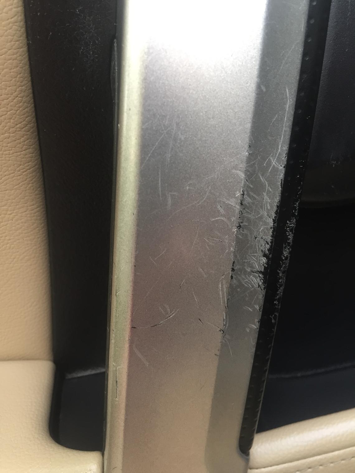

scratches on interior plastic door handles
Help! Is there any way to repair scratches on the interior plastic door handles of my 2013 4Runner?
