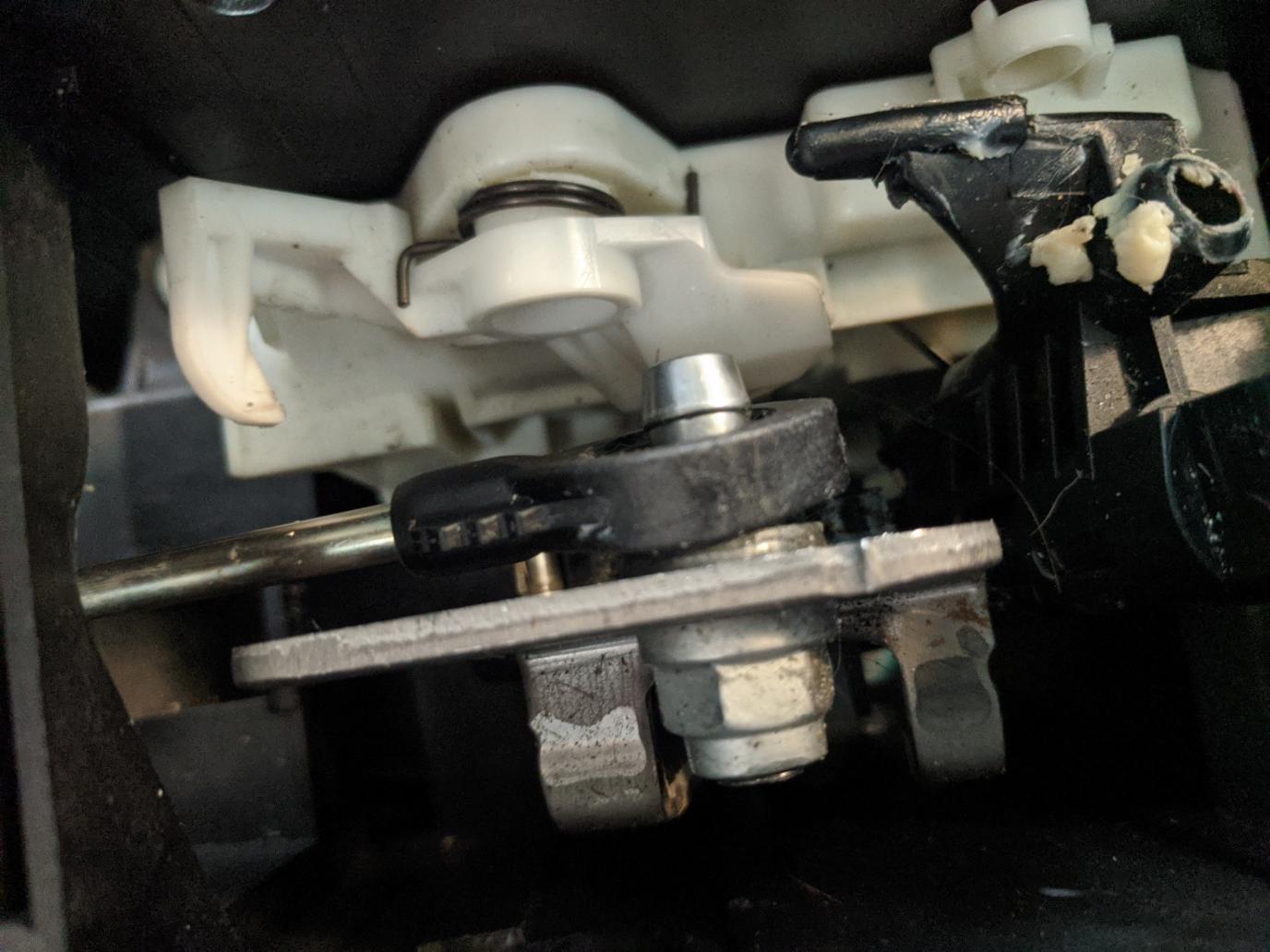

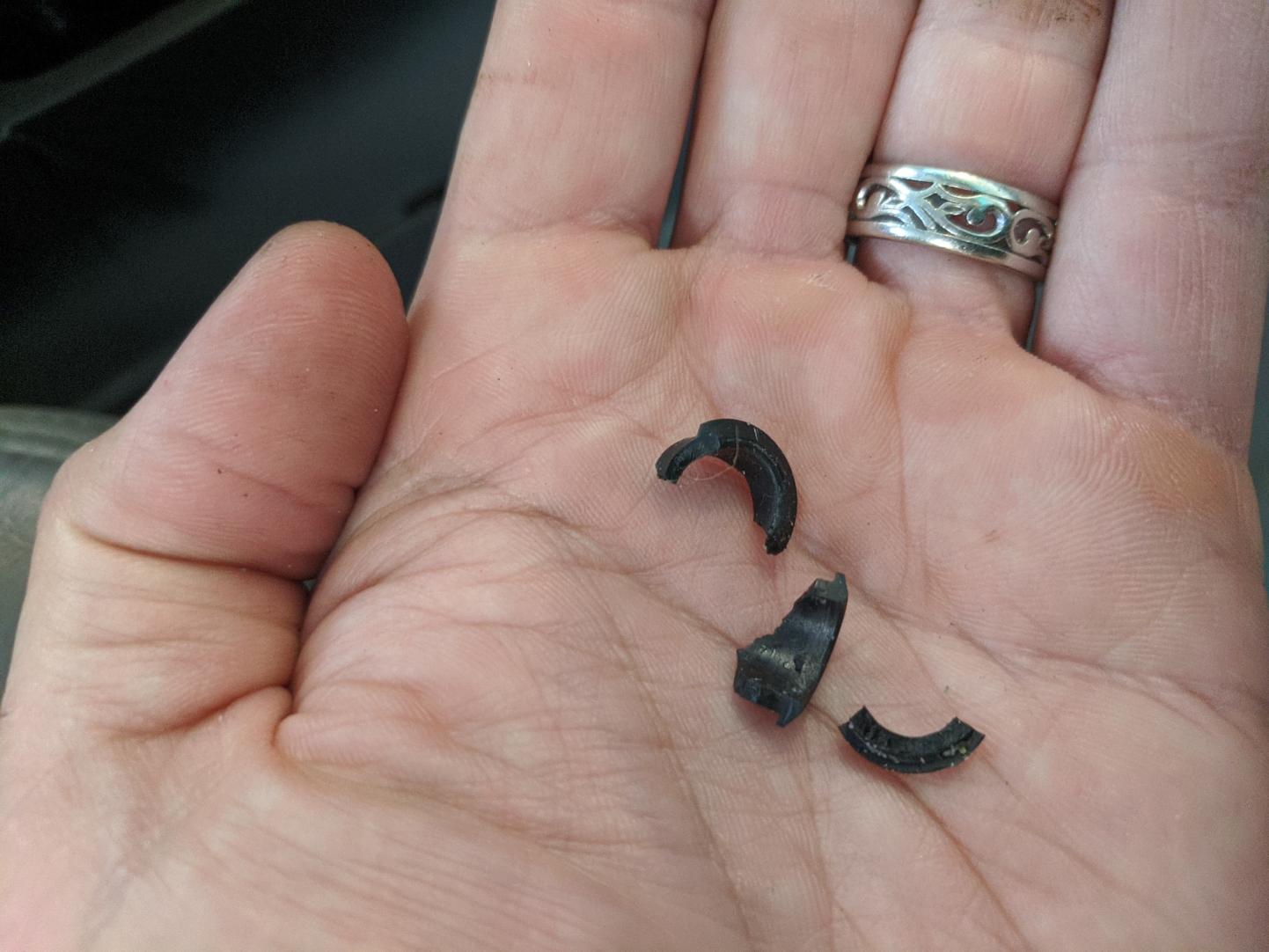

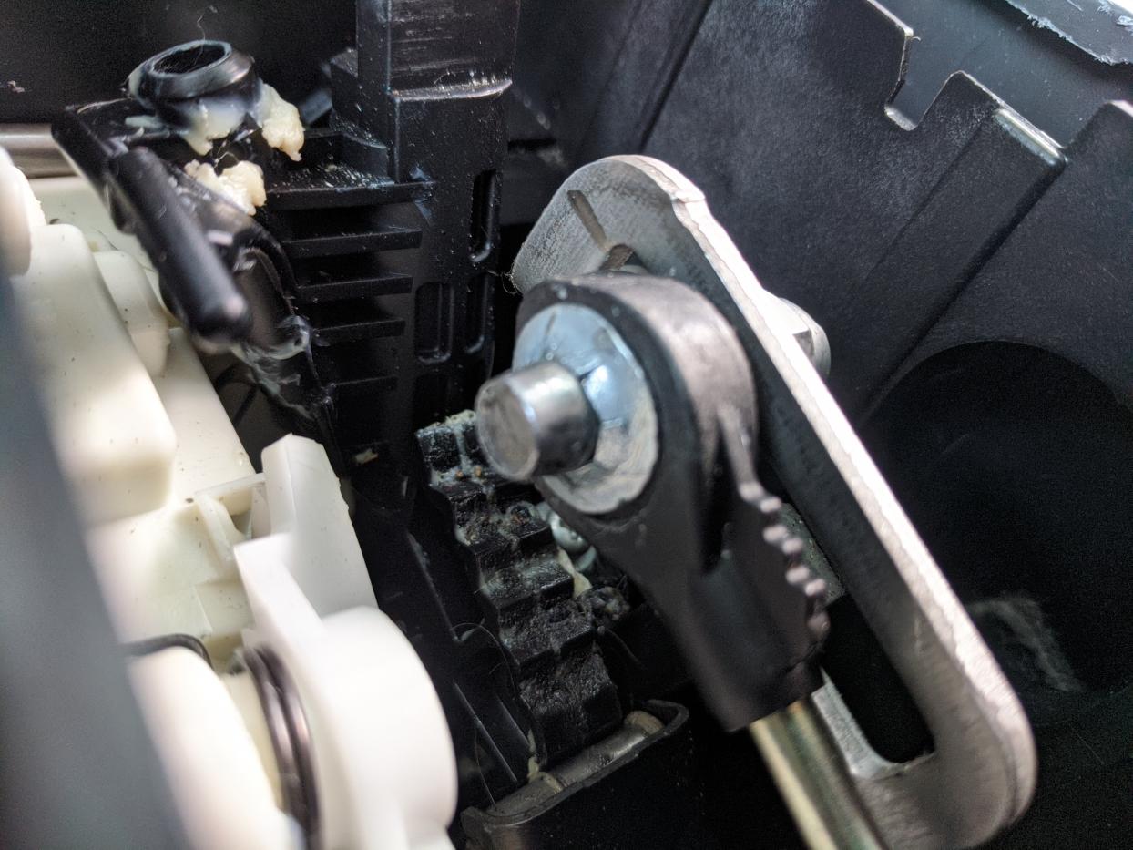

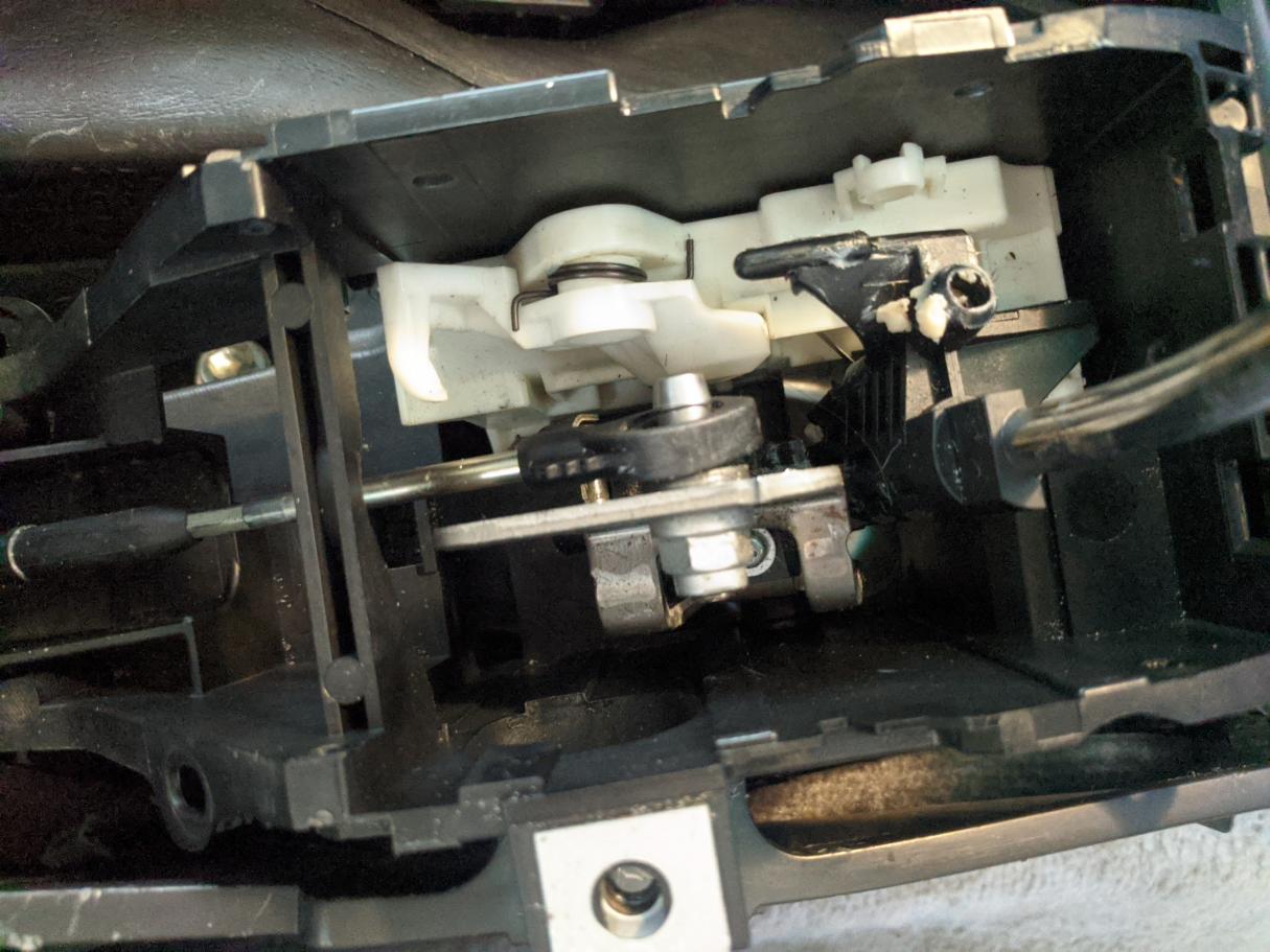

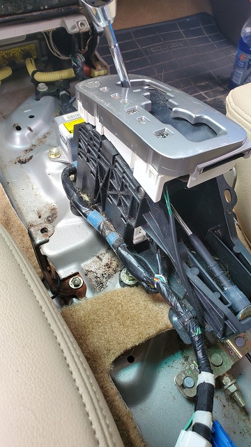

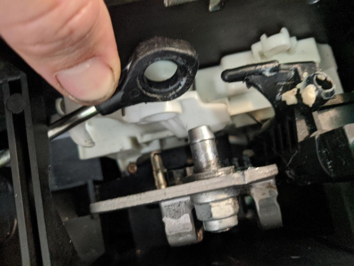

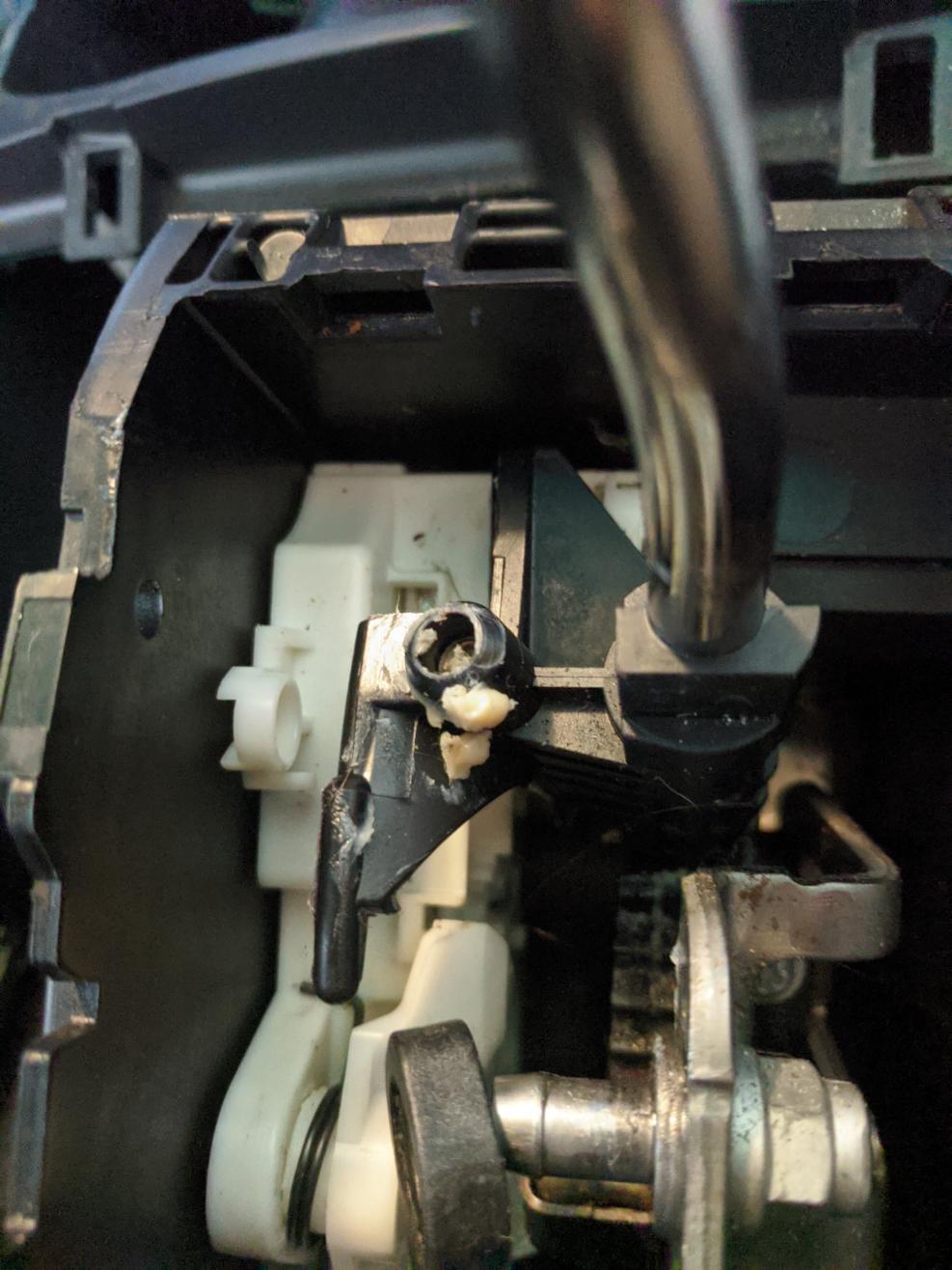

In the end my problem was that the transmission linkage cable had come off of the shifter. After removing the assembly from inside the console, found the plastic bushing remnants in the bottom. (It wasn't necessary to remove it, I was just curious how far I'd go and what all I could find).
Toyota does not and would not sell the retainer bushing-- it's part of the entire cable assembly for $280! Automotive stores have some general ones and the guy told me to come on in and we'd see what may or may not fit... but almost all of them were for American vehicles. I had no problem doing that, but it was a couple days til I could go. Zip-tied together in the meantime...
THEN :lightbulb: even simpler idea. I swung into ACE and sampled both tooth lock washers and push-washers. In the end I used a 3/8 starlock/push washer, and if that comes free, I'd switch to a spring washer next time.

While waiting for the tow truck I thought, uh, let me see if I can figure anything out in the shifter.... Having never been inside one before. After wrestling with the console for 20 minutes figuring out where the releases were, pulled it off and within seconds noticed the arm end of the cable just flopped down. How ecstatic I was!!!! (I hoped).....
Sure enough, that was the issue.

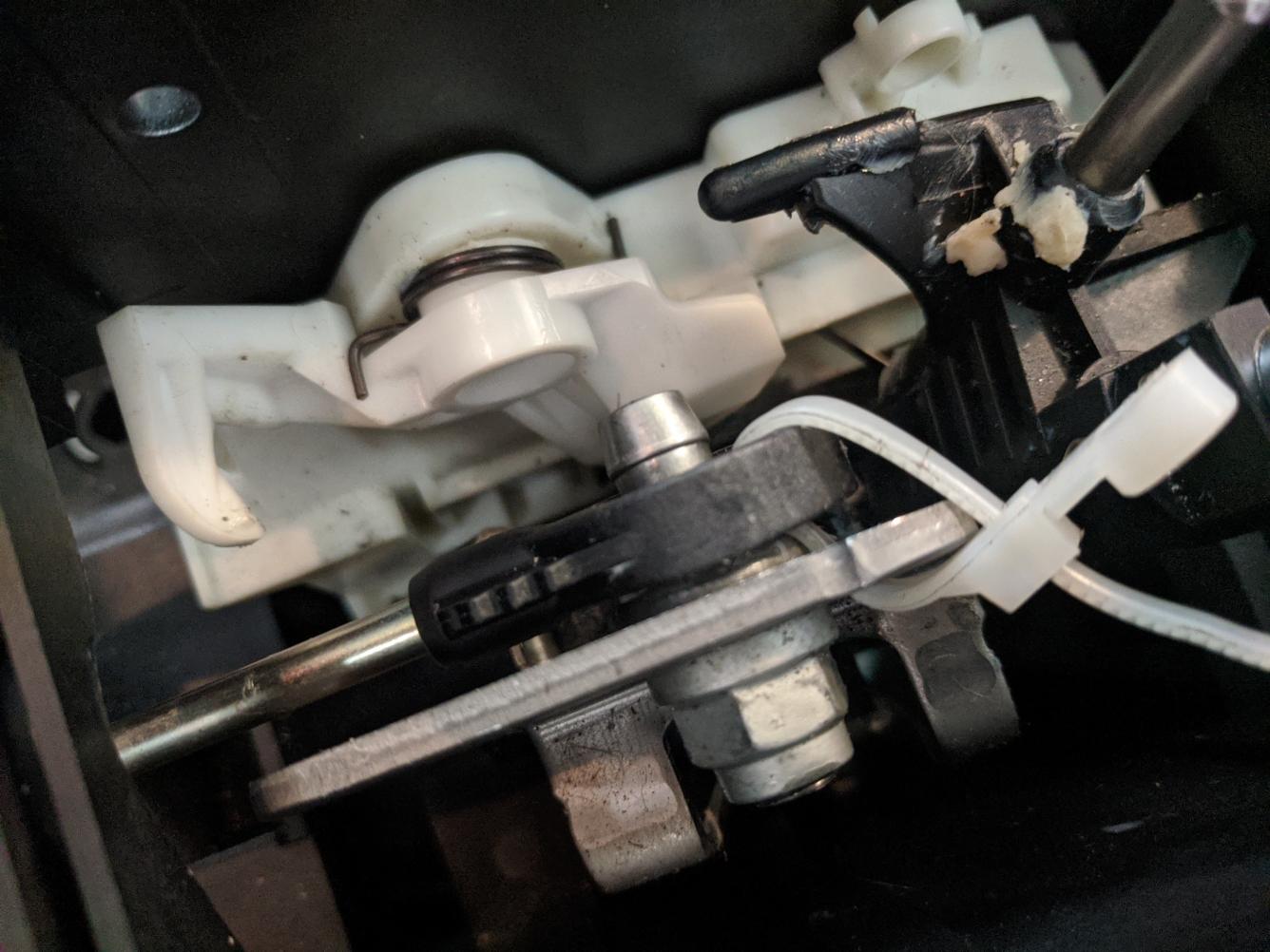

Hooked it back on, drove home, and for a day kept reattaching it til I considered zip-tying it.... and now 68 cents later, it's all done!

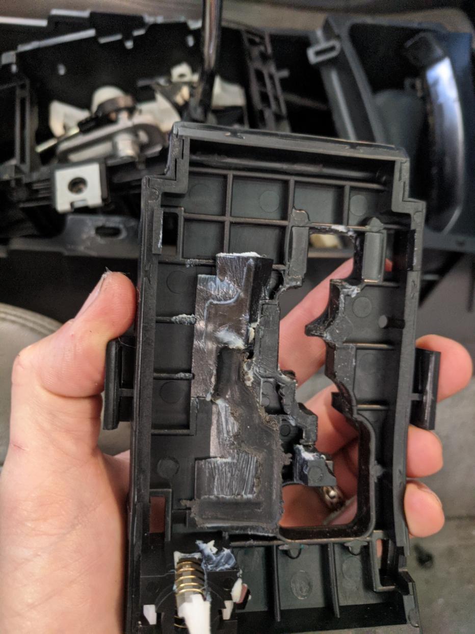

Shift assembly full view
Linkage detatched
Linkage in proper place (no retainer)
Linkage zip tied
Retainer bushing pieces

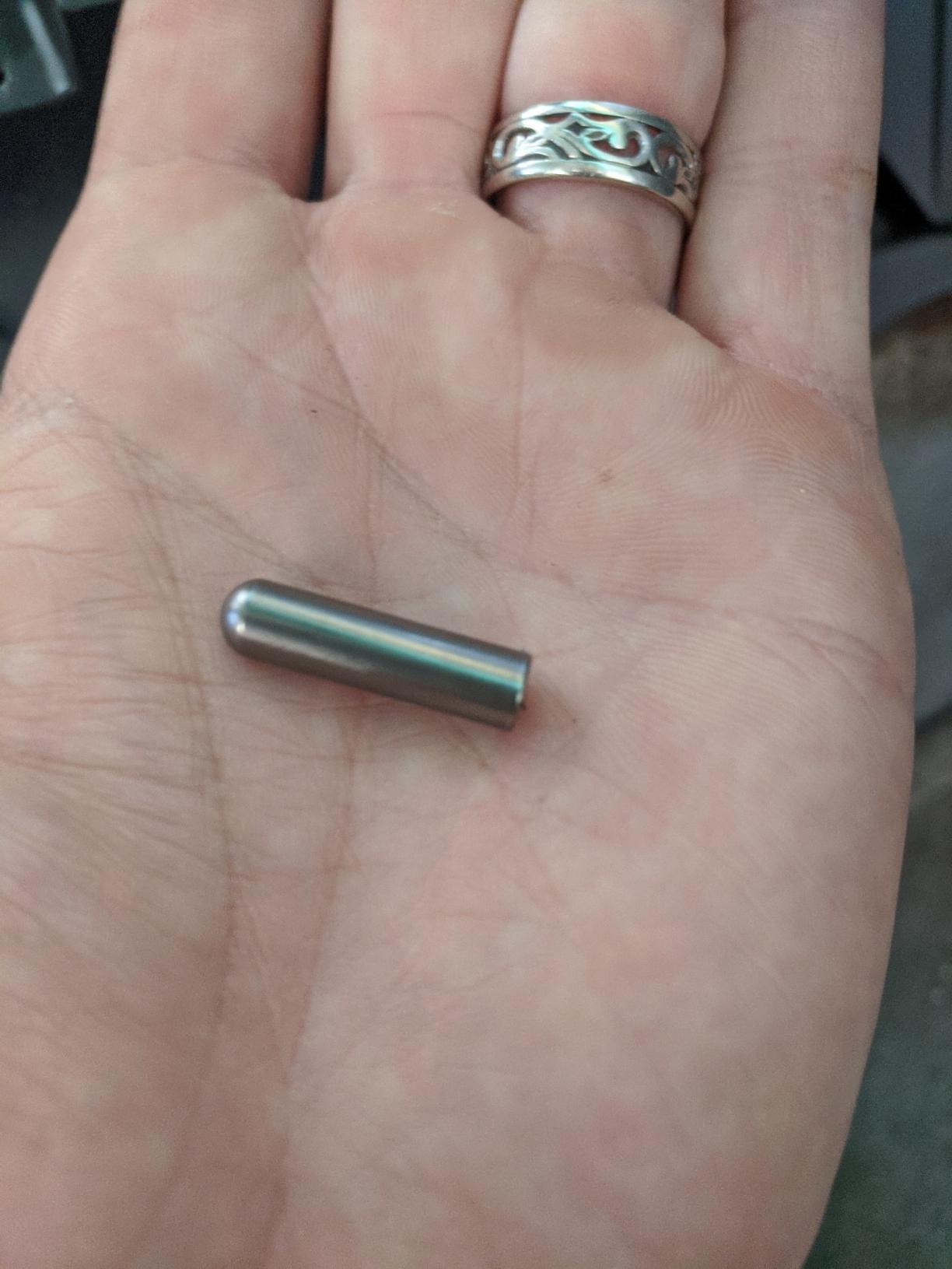

REST OF PHOTOS FOR HELP WITH GUIDE PIN AND TRACK THAT SEEMS TO TROUBLE OTHERS IN MANY OTHER THREADS
Guide pin
Guide pin in its seat
Track for guide pin
Linkage detatched
Linkage zip tied
Guide pin
Track for guide pin
Guide pin
Track for guide pin
