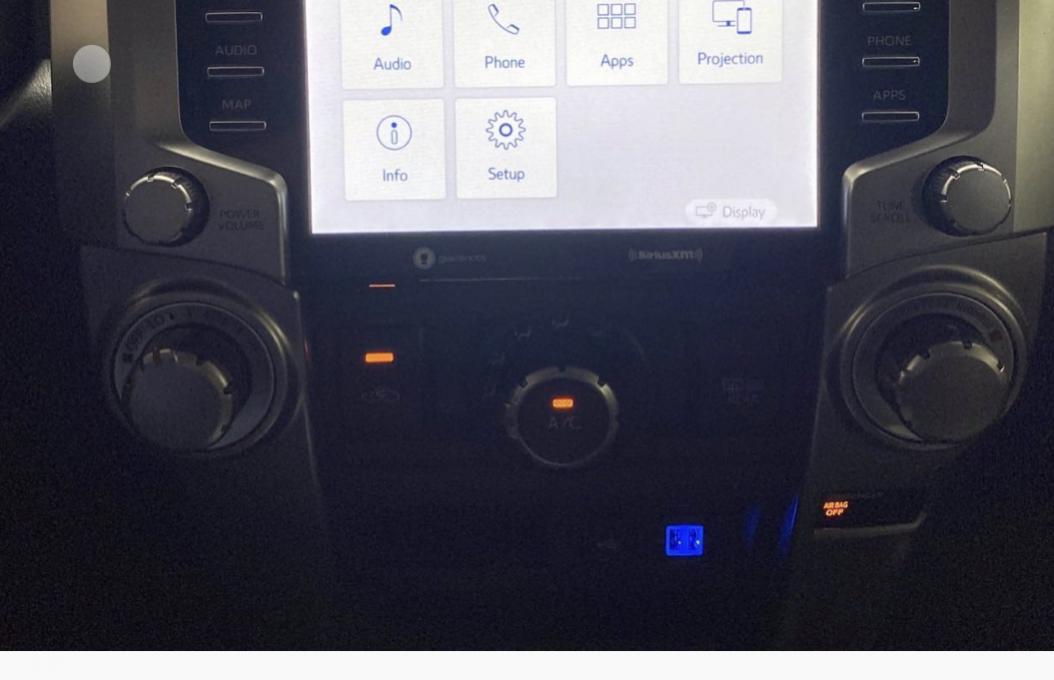

I’m looking to pick up a 2021 SR5 Premium and lots of them have the dual USB power charger installed as an option.
I’d want to replace that with a normal power socket and put my radar detector plug in charger there, so just checking if that is possible? My radar detector has a silence button on it on the plug that makes it a lot more useful.
Most of the time these things are easy to remove, but just thought I’d check. Here is a picture for reference so bottom right of the dash.

arouth needs an old fashioned cigarette lighter socket to plug in his radar detector. Radar detectors can use more power than what a USB can deliver, so they seldom plug into USB. Apparently they have done away with cigarette lighter sockets on the '21 4Runner dash.
My 2021 has a cigarette plug. Right next to the usb port to plug your phone in for the radio.
I think some of the builds replace the dash 12V w/dual USB. I would think that you could swap back fairly easy as it is either a dealer or port-installed option.
My '21 Venture has the 12 volt outlet (cigarette lighter) next to the USB connection for the entune system. I have seen some that had the dual USB power outlets in that spot where I have the 12v outlet.
I wonder how they decide which trucks get which type of outlet? It's not listed anywhere as an option so it seems random.
The dual USB is an option in the '21's. Some come through with the dual USB's, others have the cigarette lighter type power port. There is also a cigarette type power port in the armrest (pretty sure it's standard) but that probably is inconvenient for a radar detector.
I think the USB port is a “port” installed option for vehicles in Toyota’s southeast region that replaces the cigarette lighter socket from the factory. Toyota Part number 00016-00225. The OP seems to be in GA SO makes sense.
When I ordered my 2021, I chose the dual USB as an option and was told it had to be done at the factory (which they were able to do). Don’t know what that means for the OP, but wanted to clarify that.
Probably dependent on regions. As a result, “officially” could be factory only in some regions. But thanks to internet can be purchased and added at anytime.
