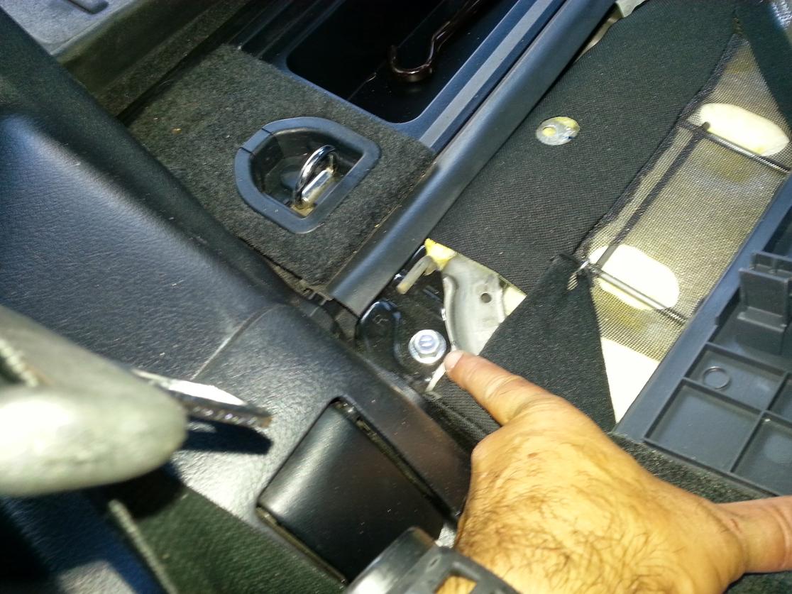

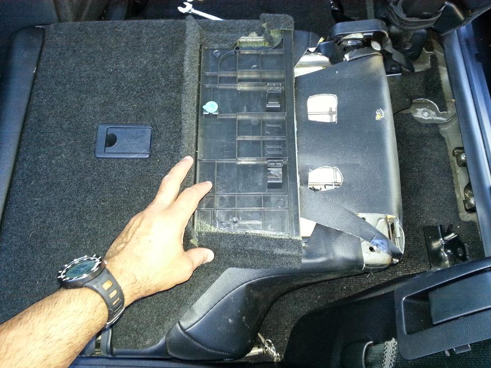

Not as easy as 5 min but not insurmountable either. My 4Runner in 2013 with the 3rd row seat option. I don't know why but it is different than the detailed explanations above but similar.
My second row consists of a single seat and a double seat they both slide forward and back and recline and fold flat. No center seat or console.
The process starts with pulling off the plastic. This always sucks as I worry about the little clips breaking. There are about 4 separate plastic pieces on each seat.
Then remove all 5 bolts and the one nut. The nut is attached to a stud that comes out after your remove the nut. I guess they didn't want to be boring and use 6 bolts.
Once the fasteners are removed it's time to attach a crane to the seat to lift these super heavy and awkward things out of the truck.
All in all for a first try it took about 30 minutes.
The hard part about reinstallation will be lifting these things back in and getting the plastic snapped into place otherwise it should be a piece of cake.

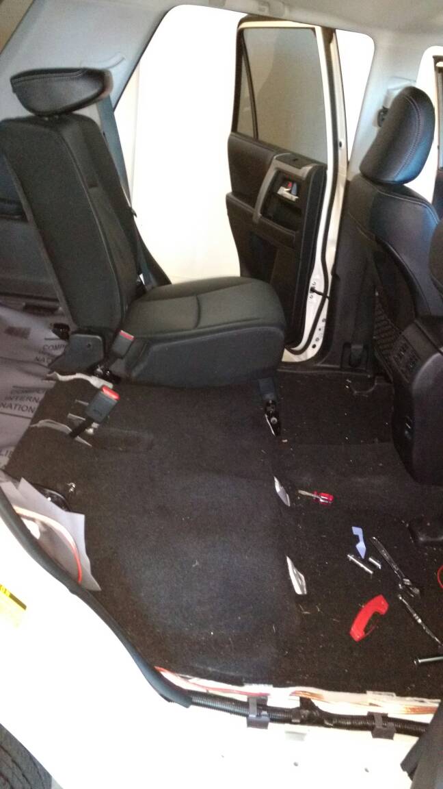

2017 T4R LTD - 2nd row seat removal
Took about 20 minutes total. More time taking off all the plastic than removing the 6 bolts. Easier than I thought.
Having the 40 split seat removed makes it perfect for the dog to jump up and gives him a place to lay down when the cargo area is full.
2 kids fit very comfortable in the back now... 4 in a pinch!
