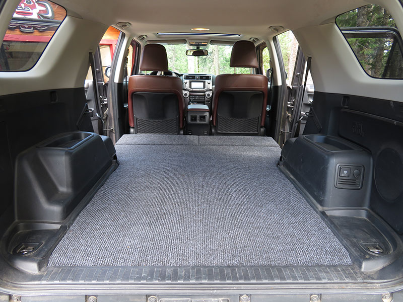

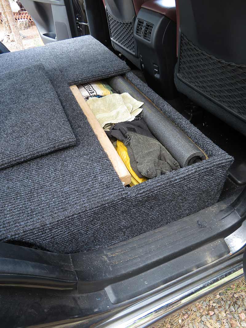

New platform and storage
I finally built a platform and storage over where the back seats used to be. Here a a couple of pics:

Love this man you have more pics? Is that two pieces? I don't see a split between the 2nd row area?
Thanks! I am pretty happy at how it turned out, especially since it was intended to be a 'first draft'! I used materials I had around the house, except for the cheap carpeting I bought at Lowe's. I intend to re-do it with higher grade plywood and improve with what I learned, but it's good enough as is.
I cut and shaped first plywood panel to go from the break where the floor starts to drop down from the back (which I beveled to fit better to the shallow drop angle) to the back of the foot beds. I leveled it with cut pieces of 2x4, and the foot bed edge has a full width 2x6 for strength and support (leaving a small overhang to allow for the 1x8 frame coming later). After I put in other small supports underneath the panel to reduce flex, I used heavy-duty double-sided tape to secure the panel to metal surfaces exposed when the seats were removed.
Then I built the box section from 1x8 pine that wraps all the way around from under the edge of the first panel (to cover the entire area from the panel to the floor) to just behind the front seats (when they are all the way back, off course). Then I cut the storage box cover panels. Be sure to leave a little wiggle room for 2x the carpet thickness between the covers. (As an aside, a 1x10 ripped down to about 1x9 would have been better, as I needed to shim underneath the 1x8 frame to bring it up level)
Since I couldn't find matching carpet, I just went ahead and carpeted the whole floor from the back of the truck, which is why you can't see the break where the first panel starts. I cut, fit, and stapled the carpet while the storage covers were on, then cut out the panel rectangles afterwards, leaving 2 inches to spare to wrap the carpet inside the storage lip. Doing it this way ensured a nice tight fit around where the covers go and no carpet breaks the entire length to the front. Really looks built in!
Inside the storage area, I have room for my fishing equipment, roof rack pads and tie-downs, blanket, tools, extra work gloves and rain jacket, and more! No more box of crap in the way of my bike and other things I need to load.
Hope this helps. I don't have any more photos, but I suppose I could take some.
