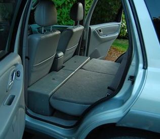

Hi,
how easy/hard is it to remove the bottom part of the rear seats on a T4R 2012 (or 2013)
I plan to buy a 2013 version to replace my ford escape.
When I go countryside I always sleep in my car. As the bottom back seat have to be lifted to have a flat cargo space, they still use a 10 inch space.
Removing them would allow some more room for my head.
So is it possible to completely remove them and replace them easily ?
Many thanks for your comment !

They're bolted to the floor pan just below the hinge. Plastic cover pops off, and there is a single bolt per hinge, so 4 bolts and the lower portion of the back seats are out.
I am doing the same thing, and asked 2 different dealers about this prior to purchasing. All they would say was that Toyota doesn't want people messing around with seats and seatbelts and such things due to the potential liability involved. I was able to determine that the bolts are just used for the seat bottoms, i.e. they don't go through the floor and hold other stuff or fuel tank mounting straps or whatever. It would be a real pi$$er to take out the bolts and then hear something mounted under the floor crash to ground. Having said that, the rear seat bottoms come out real easy - 14mm bolts torqued to 27 ft lbs. These are some captive nuts that you definitely don't want to strip.
