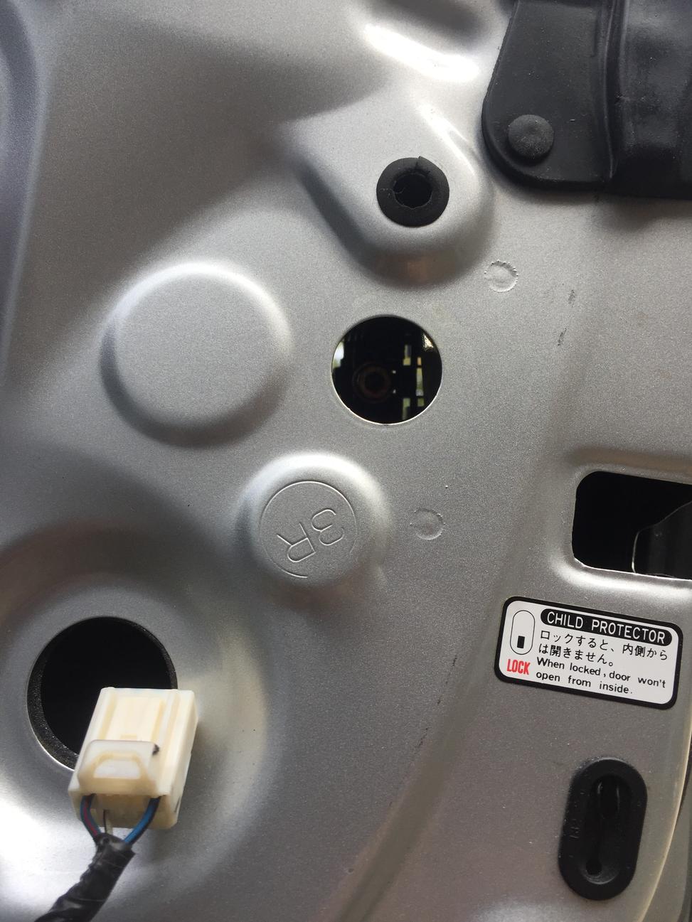

I removed all 4 door handles on my 2003 Gen 4 today. I wanted to paint them with black epoxy paint. I was not able to get the toyotanation link to work. The front door handles have already been covered.
To remove the rear door handles, you only need a Phillips head, a flat head screw driver and a T20 Torx bit. It only took me 5 minutes each door. Remove the arm rest by pulling up on it. Use the flat head to pry out on the cover where the interior door handle is. I pried by inserting the screw driver between the handle arm and the cover and it popped out without breaking. Remove the 2 Phillips head screws you have exposed and pull out on the front lower part of the door skin. Pop it off and lift up to remove it from the door. I unplugged the light and let it hang by the latch cables. Remove the plug to the door latch/lock actuator. Remove the 3 screws holding the door catch at the top back of the door. Remove the small piece of white tape on the inside of the door and slide the catch assembly down and inch or 2 to expose the T20 screw that holds the stationary door handle on. The screw should stay in place. I left mine so it would not drop into the door. Use the flat head screw driver between the stationary piece and the outer door handle. Pry toward the back of the truck and it should pop out. Pull slightly out on the door handle and it will slide out toward the rear of the truck. It really only takes 5 minutes.
Here is a picture of the screw location. Once you pull off the little round piece of white tape, you can see the screw inside. It stays in place, so you should not have to worry about it dropping into the door. It was a T20 Torx head.
