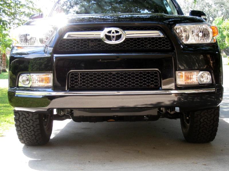

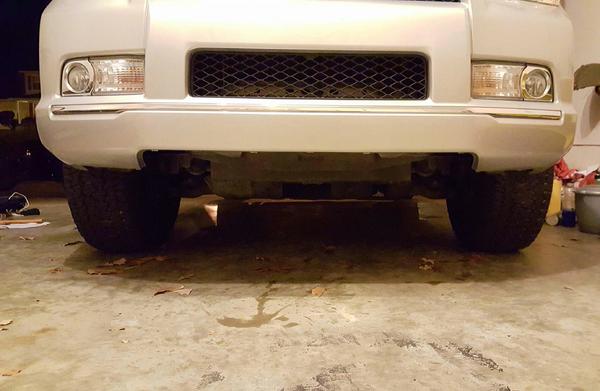

Finally did this. Very pleased with the results but much more of a PITA that everyone made it out to be. Most of my screws were threaded in from above, so I had to remove some screws elsewhere in order to bend enough plastic to allow a ratchet up there. Also, once all the screws are out, you still need to apply what seems like an "I'm about to pull the whole bumper off" amount of force to get all the snaps to come loose.
connormcw-albums-2010+limited-picture37768-taking-off-air-dam-screws-were-mostly-threaded-above-making-pita-get.jpg
connormcw-albums-2010+limited-picture37769-looks-much-better-without-all-plastic-up-front.jpg
Looks good! And I agree, the threaded from above screws were a PITA and I had to pull real hard in order to actually get the air dam off. It's definitely never going back on.

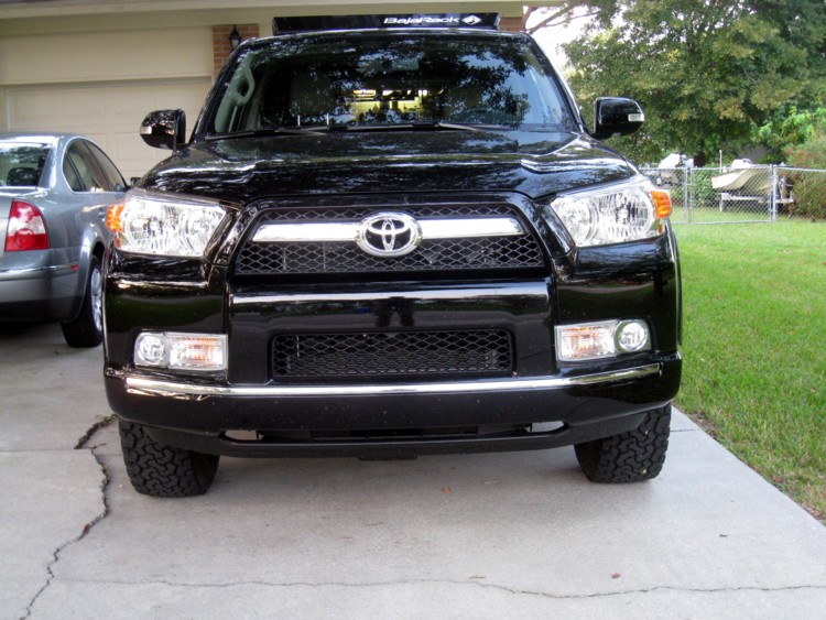

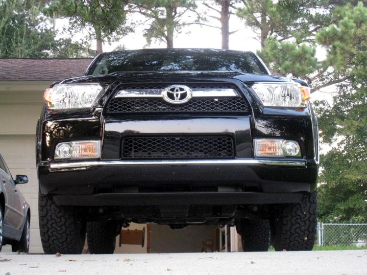

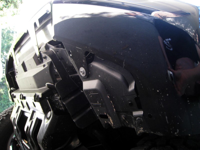

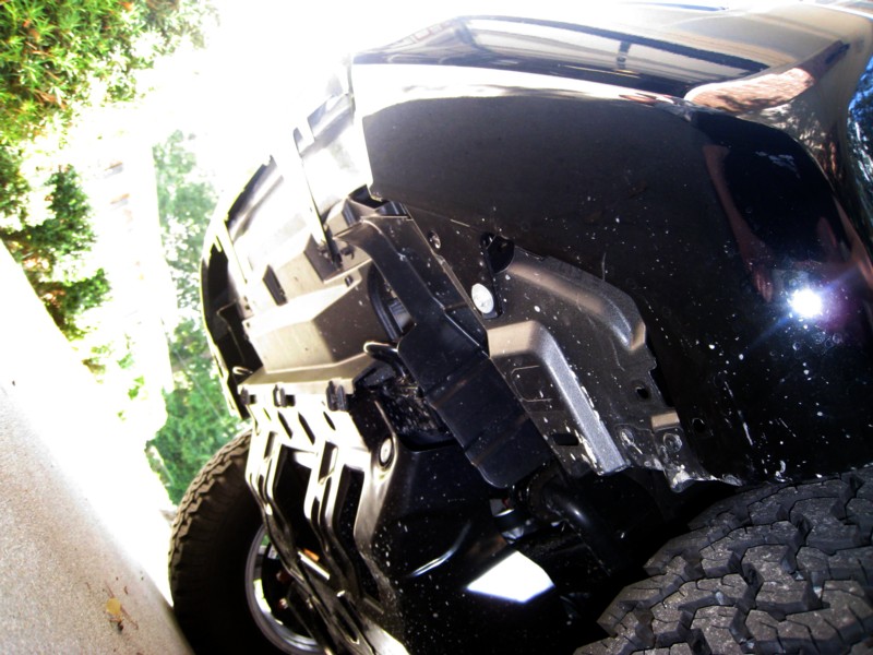

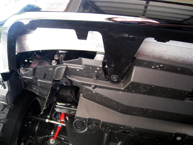

Despite the risks aforementioned on this post, I removed mine anyways. Call me crazy or stupid, but it helps my approach angle by about 2 or 3". You can see a small oak leaf in the air dam in these pics. It was already there BEFORE I removed the plastic, so debris can get in there regardless. Yes, you could plow through some mud and it might get in there, but seems to me like it would be pretty easy to wash off afterward. Also, there is a grate even down in there to keep big stuff out. I like the way it looks. :cool:
Before:
After:

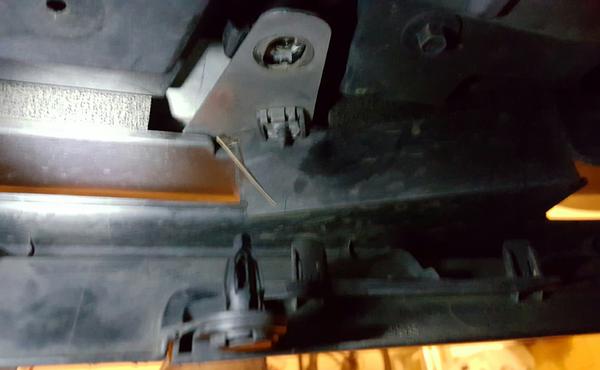

how do you actually detach the front piece from the vehicle. it looks as if it's kind of hooked on there. do you just pull it out? I was also struggling hard to remove the bolts right by the fender liner. I feel like with a smaller crescent wrench I'd be able to get those bolts out. I did not have the right size and was trying to use an adjustable crescent wrench which was just too big to fit in there even after trying to push the plastic. but I still couldn't figure out how you'd actually detach the front piece
has anyone done this recently? I tried again now that the weather is nicer and I can't get the two end bolts out - the ones farthest to the outside. they are completely rusted to the clips. I can get the bolt to turn but the whole fastener spins, it doesn't get looser
I want access to the two loops and I was thinking about mounting a curt front hitch for accessories like bikes on the front or be able to tie kayak or two from the roof and secure it. I'm about to take it to the dealer but maybe I'll try one more time. dremel the bottom of the bolt off and drill upwards?
