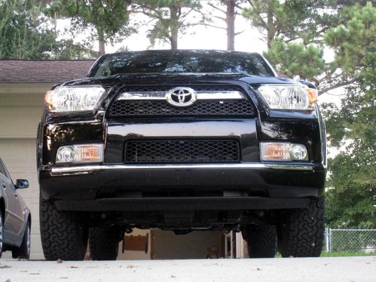

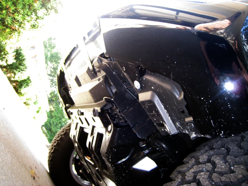

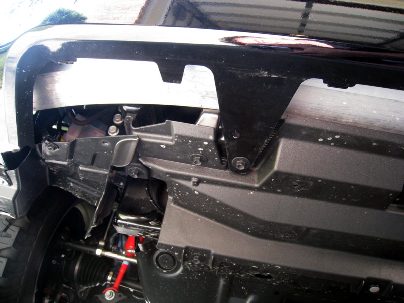

Despite the risks aforementioned on this post, I removed mine anyways. Call me crazy or stupid, but it helps my approach angle by about 2 or 3". You can see a small oak leaf in the air dam in these pics. It was already there BEFORE I removed the plastic, so debris can get in there regardless. Yes, you could plow through some mud and it might get in there, but seems to me like it would be pretty easy to wash off afterward. Also, there is a grate even down in there to keep big stuff out. I like the way it looks. :cool:
Before:
After:

Thanks for the photos. I have wanted to remove mine because it has been a scoop for off-road debris and because it is such a pain to remove the cover for the recovery hooks. How long does it take to remove? Fairly technical or quick and easy?

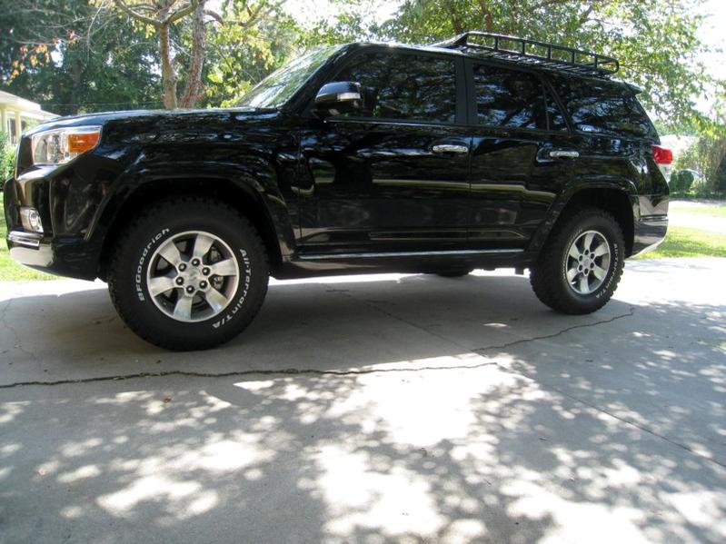

Do you have any more side pics? I have a Black SR5 and am thinking on white letter tires out. Thanks.
Here are more pics of the truck after I put on the BFGs but before I removed the front air dam.
http://www.toyota-4runner.org/5th-gen-t4rs/71758-275-70-17-bfg-atkos-installed-limited.html
There is a good pic in this thread of how it makes it easier to tie ropes under the front bumper now that the air dam is gone.

Over six months with it off and no more concerns at all. Did not affect mileage or handling or noise. I don't think TE's have it anyway so why would it be necessary? Would like to hear from an engineer or Harper on this. Looks much better with it off and it was easy to take off, and improved clearance/angles.

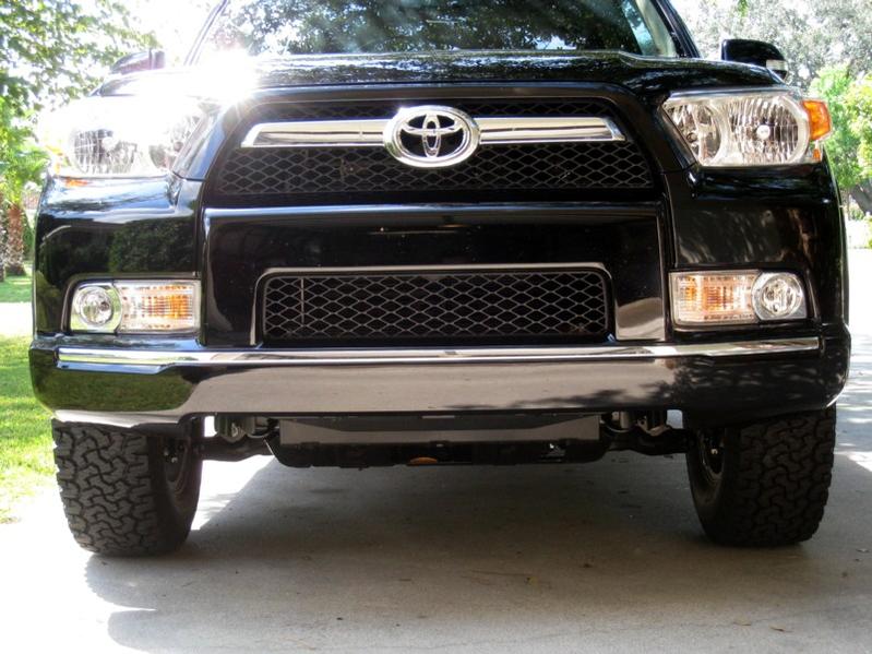

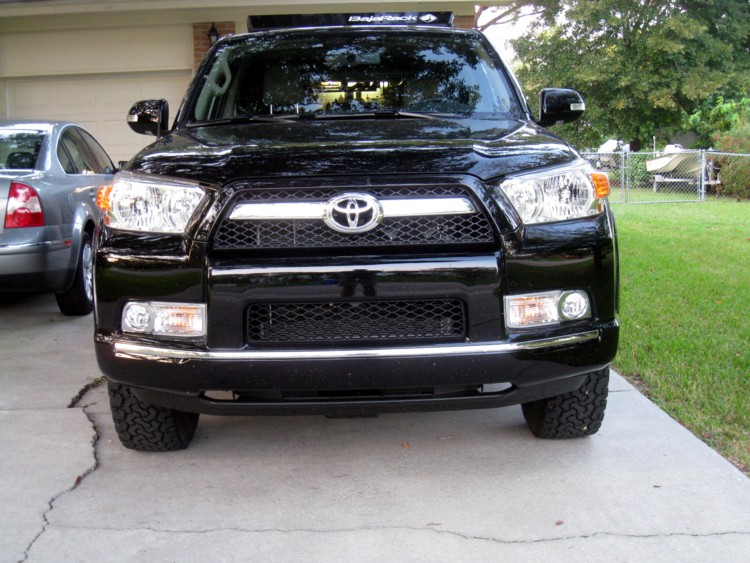

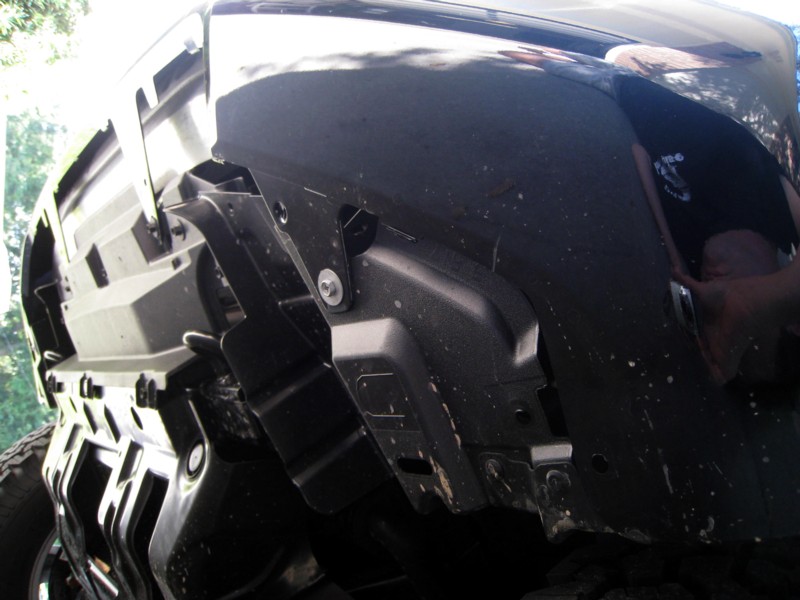

I took mine off and it looks way better!
Its been off for about a week and i haven't
noticed anything adverse in the form of temp,
noise, or anything else. It looks way better in my
opinion. Took about 15min used a 10mm nut driver
and a skinny 10mm ratchet to get to 2 tricky nuts
on the ends. Sorry for the crappy pics, my camera
broke so i took them on my phone, no zoom :(
It gave my 4R a meaner front stance in my opinion.
BEFORE:
AFTER:
