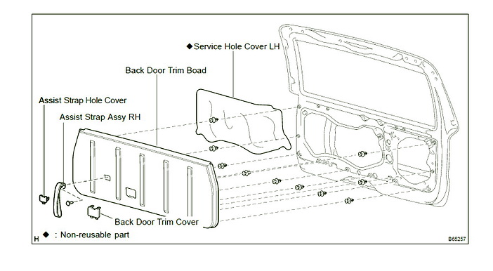

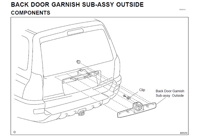

Ok, If the 2003/2004 is the same as the 2006 you need to remove the backboard:
1. REMOVE BACK DOOR SERVICE HOLE COVER LH (See page 75-39 )
(a) Remove the assist strap hole cover.
(b) Remove the assist strap assy RH.
(c) Remove the back door trim panel.
(d) Remove the service hole cover LH.
2. REMOVE BACK DOOR GARNISH SUB-ASSY OUTSIDE
(a) Remove the 6 nuts.
(b) Disengage the 2 clips by pulling the garnish, and remove the garnish.

When i remove the assistant strap hole cover there is one bolt...when i remove the back door trip cover there is a layer of plastic...do i puncture that plastic or does removint the bolt from the assistant strap hole cover allow me to pry off the back door trim board?? Is it just held on by plastic clips?? The service whole cover must be beneathe the back door trim board. I'm just wondering if removing that one nut frees something up or if i need to puncture the plastic to reach more bolts to get to the service hole cover?
Once I get the back door trim board off it seems pretty easy going... I don't want to puncture the plastic if it doesn't need to be or if it serves an important purpose.

Yes, base on the illustration, there's one bolt, and the back door trim cover is held by 10 clips..and if you pry off the back door trim, start from the uppermost left/right clip, use a flat screw driver wrapped with a cloth. Once removed, i think the rest would be easy..goodluck :)

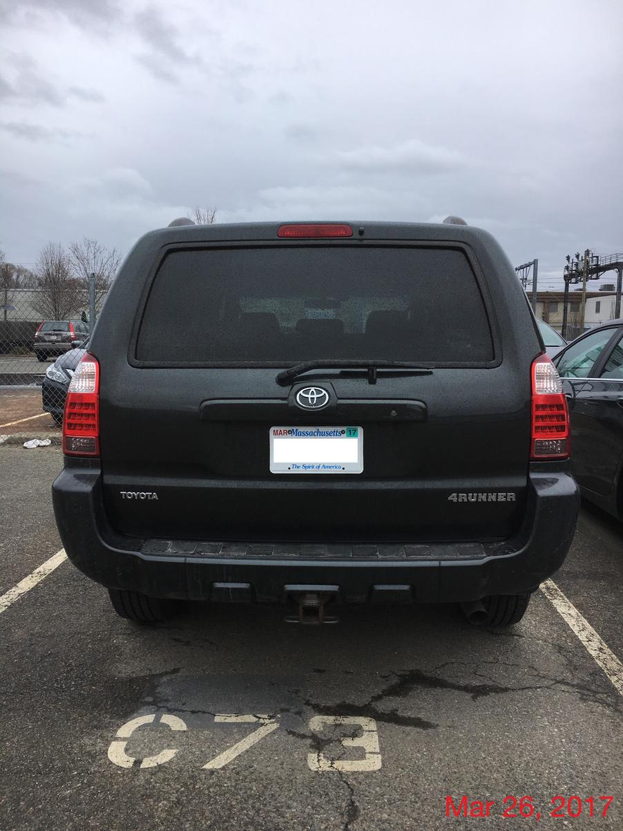

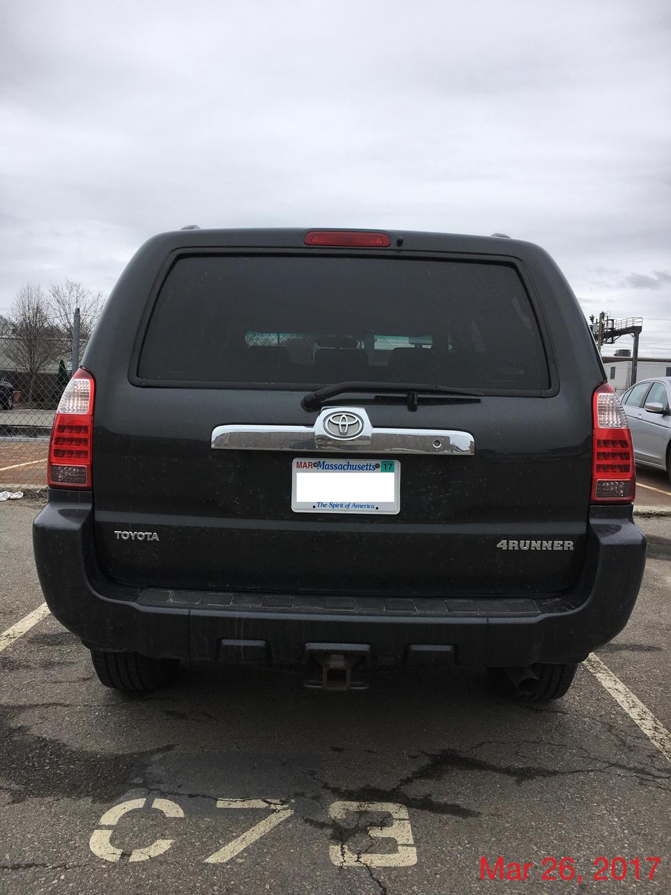

I replaced my 2008 SR5's chrome trunk garnish with color-keyed, Shadow Mica garnish today. This, and TREVLOC's thread (http://www.toyota-4runner.org/4th-gen-t4rs/80044-trevlocs-thread-2.html#post691329) were very helpful in what's a slightly-more-complicated-than-you-might-expect project. I've replaced the chrome grill for a color-keyed one a couple months back, so the four door handles are the last of the chrome remaining. I'm not overly mechanically capable - and this is my daily driver - so I may just end up having those painted this summer.
To note, the garnish piece holds a decent amount of wiring (two license plate lights, automatic door latch) that you'll need to re-wire through the new piece. As a truck that's never New England, some of the screw heads were rusted over, and I actually had to break a couple of the old garnish's plastic brackets around the lights to free the small screws. Also the rubber on the latch was pretty badly corroded, and I wish I'd bought a replacement for that instead of reattaching a weather-damaged item.
I'm attaching some before and afters, hopefully it works.
