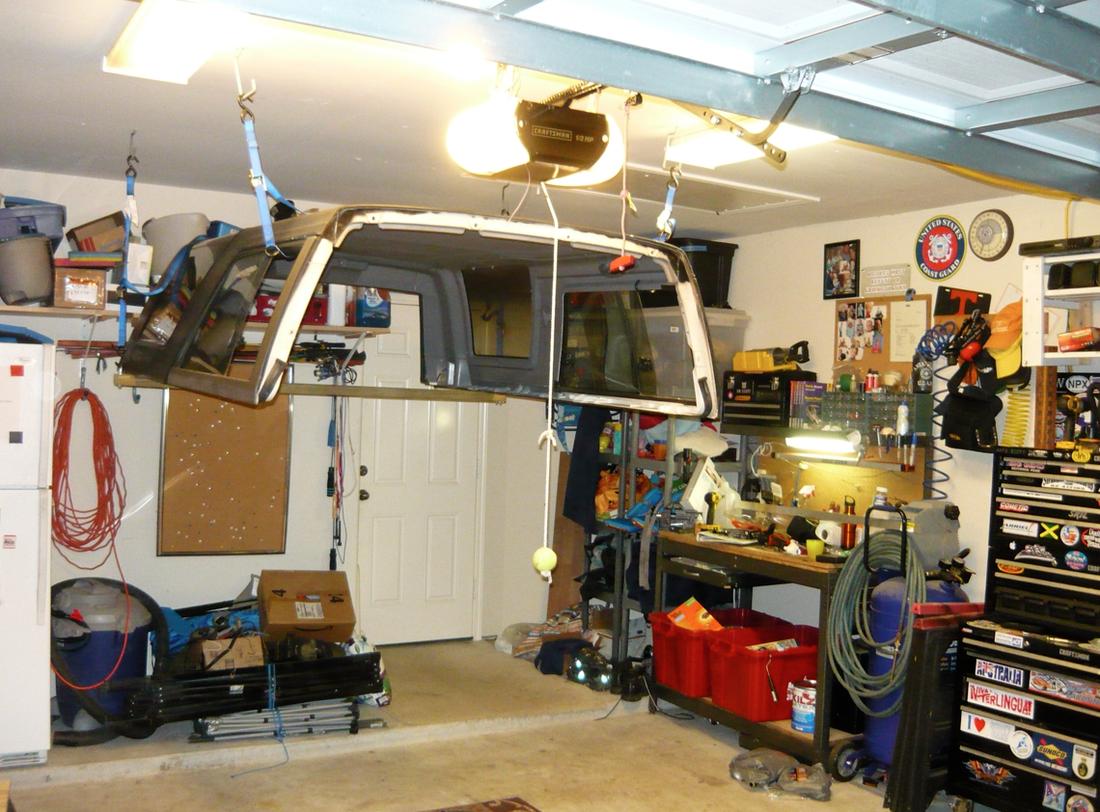

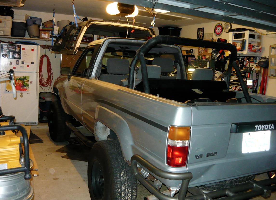

I don't know about a "commercial" lift but with a couple of eye bolts, some straps and a 2x4 I can get mine off in about 10 minutes by myself. Once off I just lift it up high enough to drive in the 4Runner or the Accord.

Hell yes! Now that is Semper Paratus (or Semper Gumby!).
:hatsoff:
