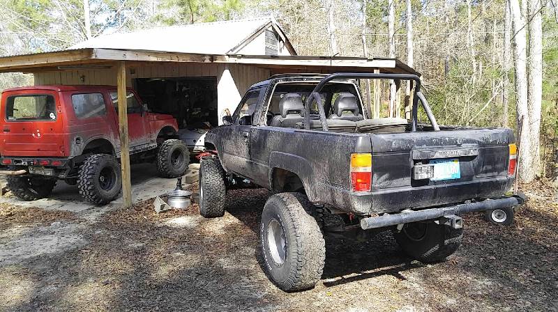

I used to put mine back on with 7 bolts. 2 in the out side of the top, 2 in the front corner, 1 in the sensor, and 2 in the back. Even through winters it never leaked.
