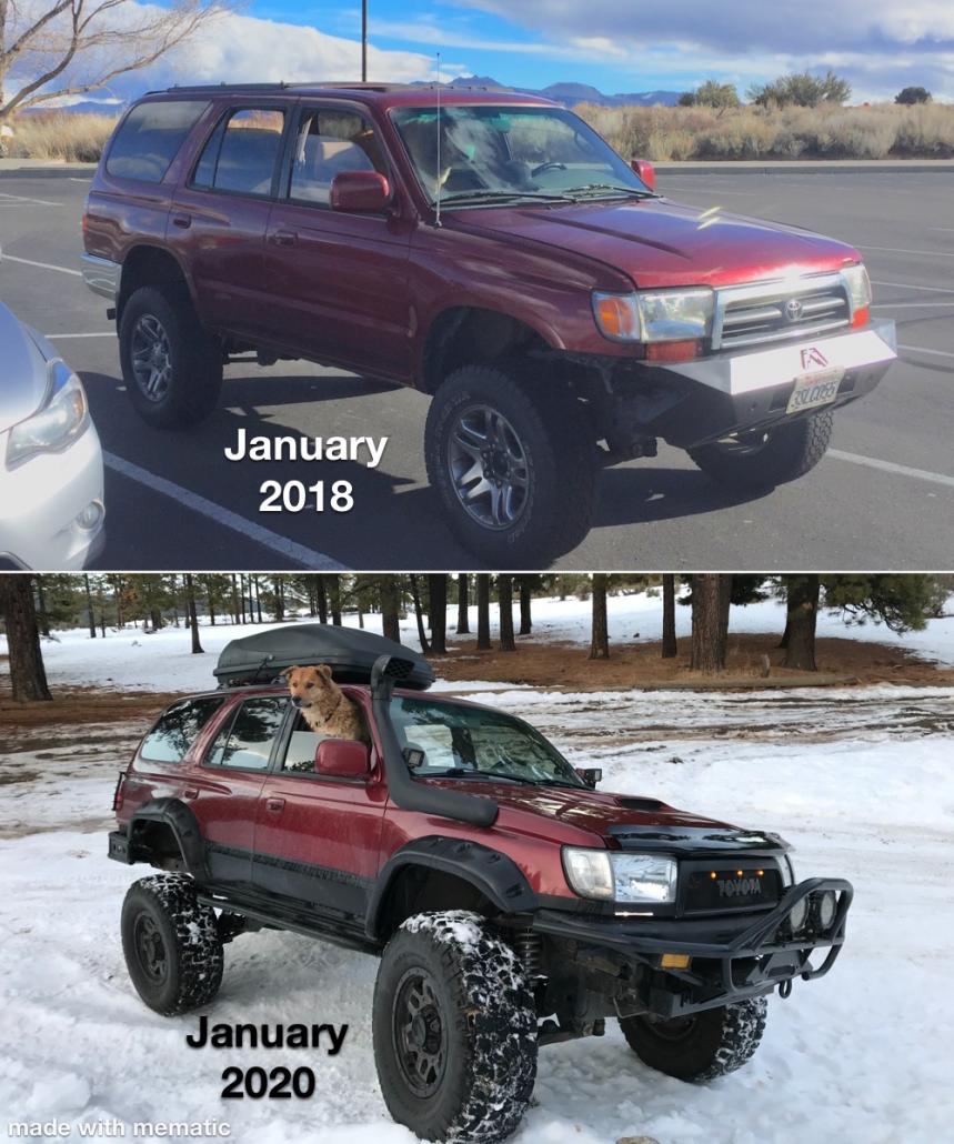

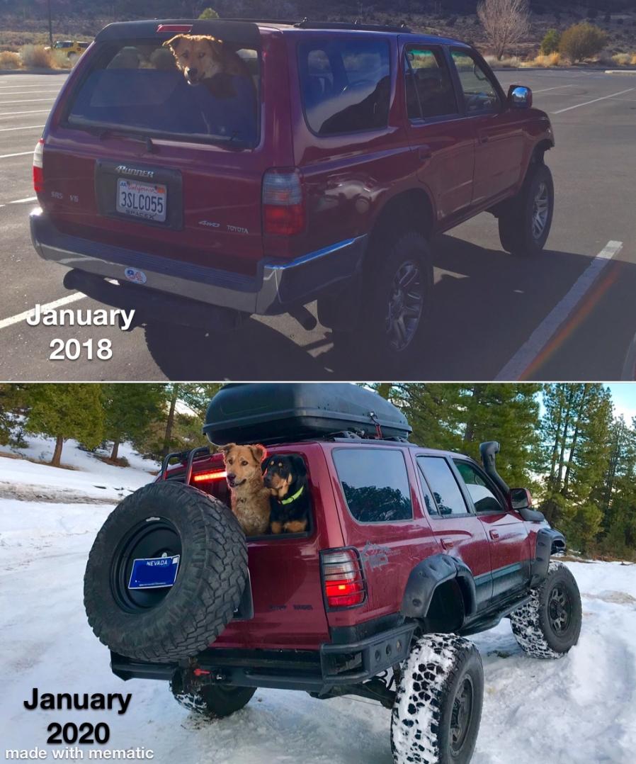

Happy New Years Everybody. I think I'm overdue for a build thread and I realized it has been 2 years since I got my 4R, so this seems like good timing. I included a couple transformation pictures to show how i've changed things so far. I bought mine in Mammoth, CA for $3,500 with around 203K miles, the title was clear but the previous owner slide on some ice and hit a tree stump on the front drivers side. They mounted a chopped up bumper from a Nissan Titan on the front. Apart from the ugly front bumper and some dents on the fender and hood, it was in good shape.
