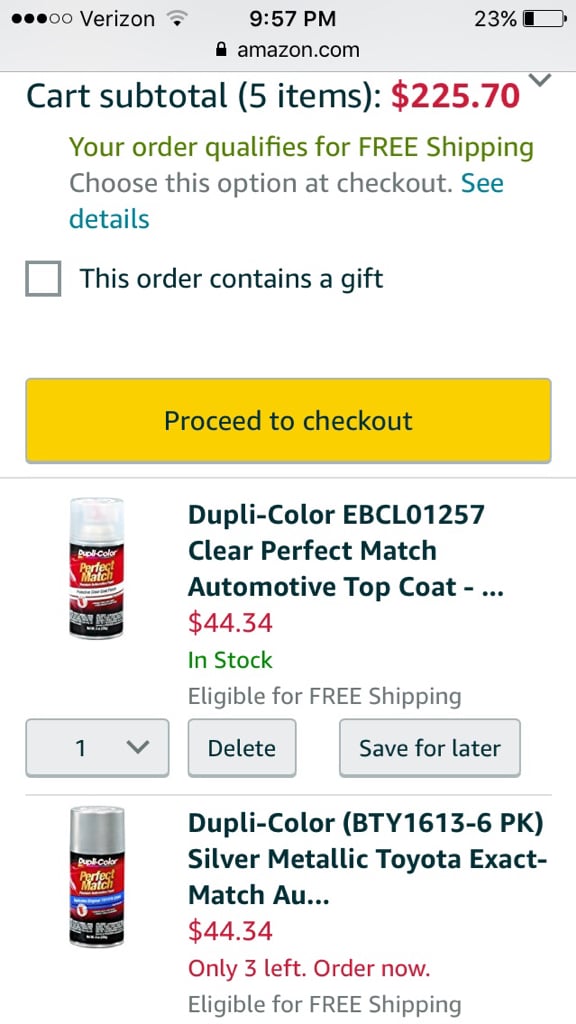

12 cans of millennium silver
6 cans of self etching primer
6 cans of sandable filler primer
6 cans of gloss clear

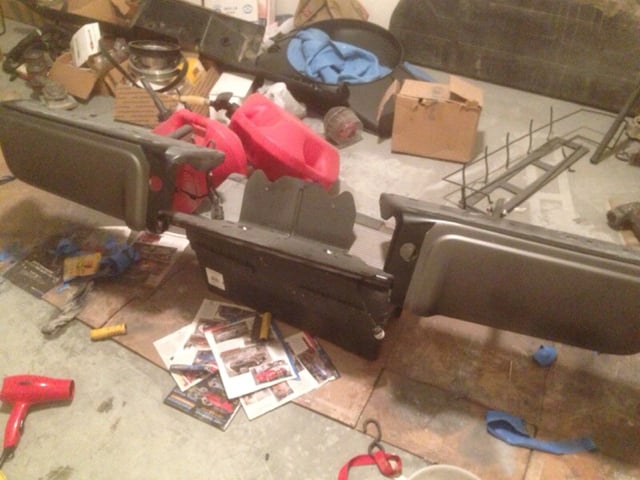

Not to be confused with a microwave!!
