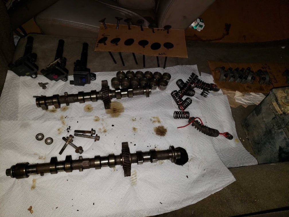

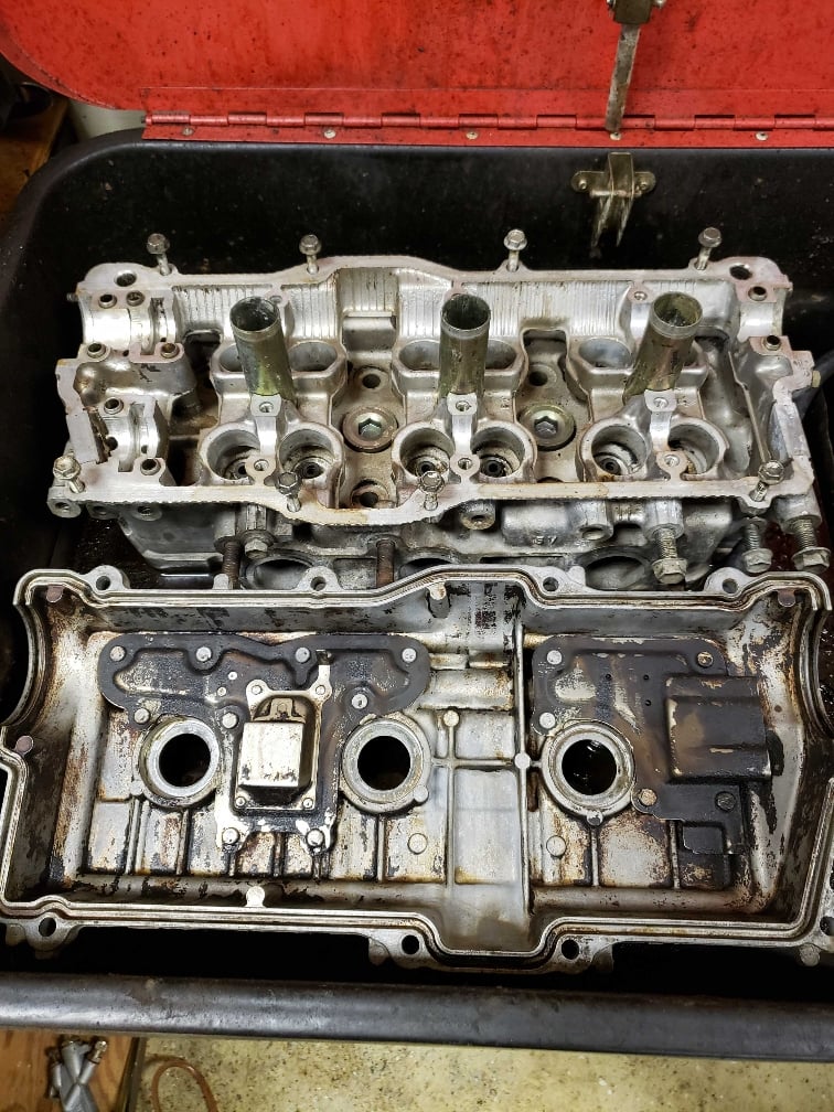

I'm in the middle of replacing the head on the passenger side. Spark plug blew out of the hole and took the threads with it. Bought a parts 3rd gen for $350 with new timing set and swapping the head and timing set over to mine. Having some issues with cleaning and rebuilding the head though. Never done OHV work before and can't find anything on YouTube for reference. Not even sure what valve spring compressor I need. Any advice would be great. But, definition feel like if you can invest the time, repair over replacing. It teaches you so much about your engine.

I've never done an OHV head before I did the HG on my 92 corolla.
Get the complete head job done (with valve seals, seat, guides, etc) at a proper machine shop and they will get all the valves done right. When you get back the head, with care, take two cams off the head to tighten the head bolts and reinstall the cams with proper timing marks. It was very simple.
I paid $200 for the complete head job on a 4 cylinder corolla (I delivered the head with unremoved cams to the shop) back in 2013.
The repair was done at 220K miles and now I am at 276K miles.... It WORKED!!
I will do it again at anytime.... Make sure to take pictures along the way in case you forget something.

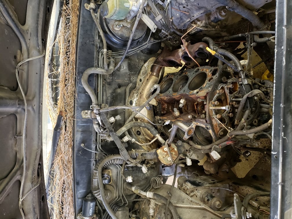

Current progress. These are the donors. Once the heads and covers are cleaned I will start disassembly of my engine. Then I plan to rebuild this one as a spare. So far, I've got about $500 &24 hours labor invested. That includes donor vehicle and parts ordered to date (gaskets, head bolts & washers, cleaning solvents, etc).
