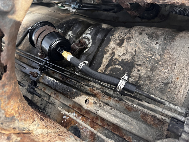

Welp. I have a 1997 T4R SR5 3.4. Just like everyone else, was able to disconnect the rear nut to tank. Front one is 1000% seized. Spent days preparing by spraying free all before i even touched the thing. I tried flare wrench, vise grips and more but to no avail, needless to say i rounded the nut off. Ive seen people have success with cutting it out and replacing it using those fuel line repair kits. I guess my question is what specifically do i need? Im
fine with going rubber, i dont care. I just need it the filter replaced asap, even more so because when i got the rear nut loose the fuel that came out from the filter was very dark brown. This is my first post so my apologies if its in the wrong place or if i did something wrong. Please someone help me. I took a couple pics for reference but i dont see an upload image button anywhere!!

Ahh, okay thanks! Basically what im doing is chopping off the old rounded rusted fitting off with a line cutter, then I got a brake line with fittings and a 6” piece of nylon/rubber line. “Brake” line with fitting connects to filter, rubber line connects the “brake” line to the remainder of the fuel line with 2 clamps!
Here it is: IMG-7850 hosted at ImgBB — ImgBB
Now seeing the condition of the rest of the truck (errr, frame), I don't feel so bad about this fix. I'd still suggest swapping over to fuel hose clamps from the worm drive ones you have on there - and maybe make them stainless...
-Charlie
-Charlie[/QUOTE]
Yeah i do plan to in time. This was just a quick budget fix. However i will get those fuel line clamps on the today. And lol yeah the frame isnt so hot but ive been repairing it slowly. Its my daily driver. Michigan rust is a different animal.
