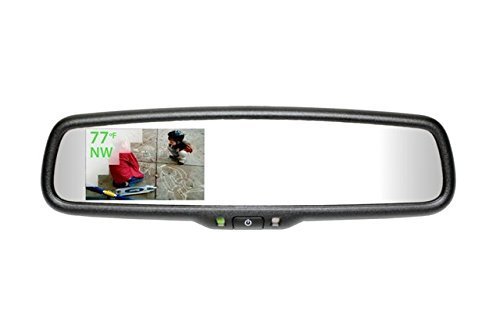

Gentex 50-GENK3320S Rearview Camera Display Mirror Auto Dimming 3.3 in. with Compass & Temperature
Actual product width: 10.5”
Made in USA
Green LED temperature and compass readout.
Includes 3.3” RCD Rear Image Display
Priced around $519 new.
