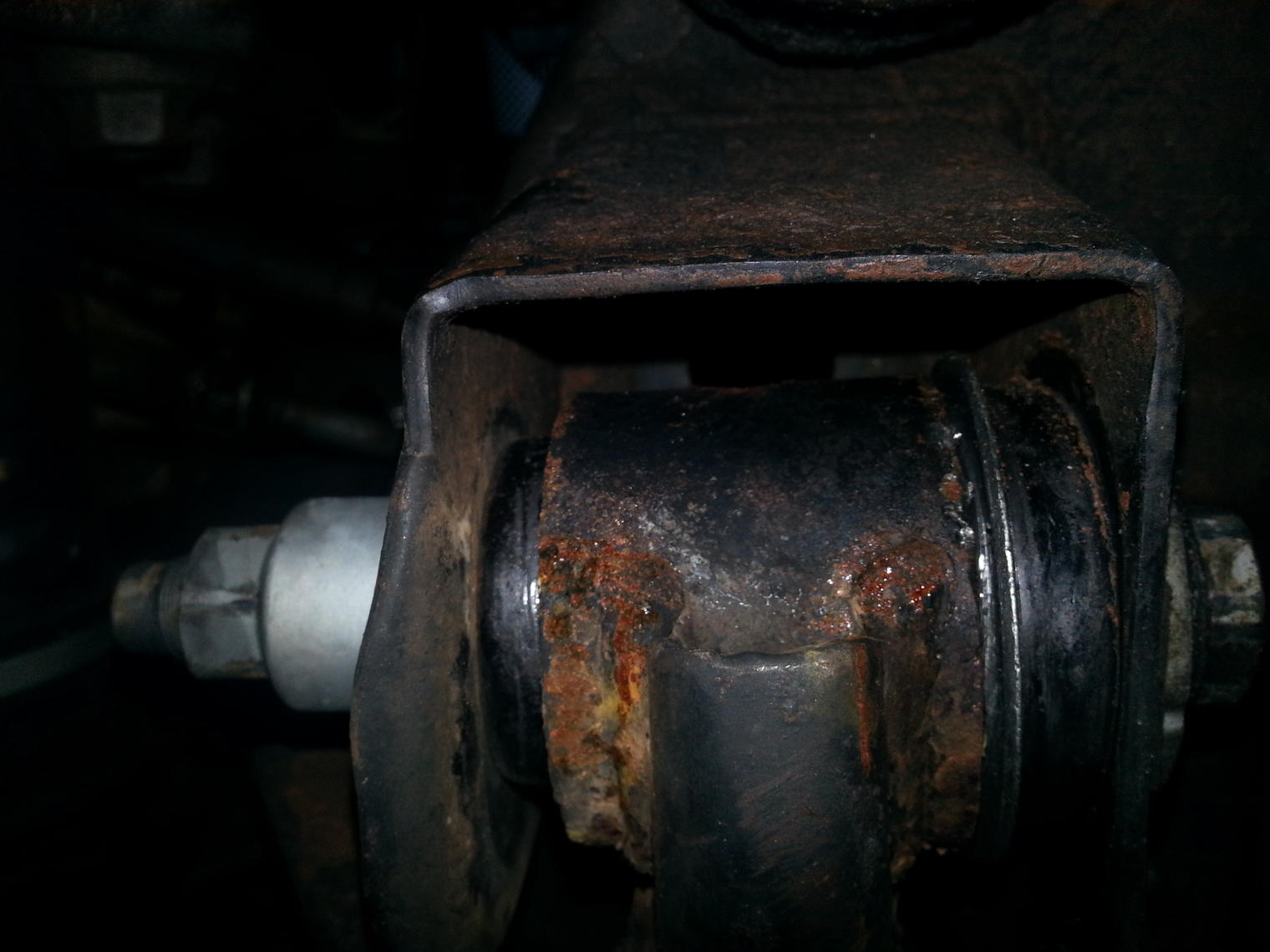

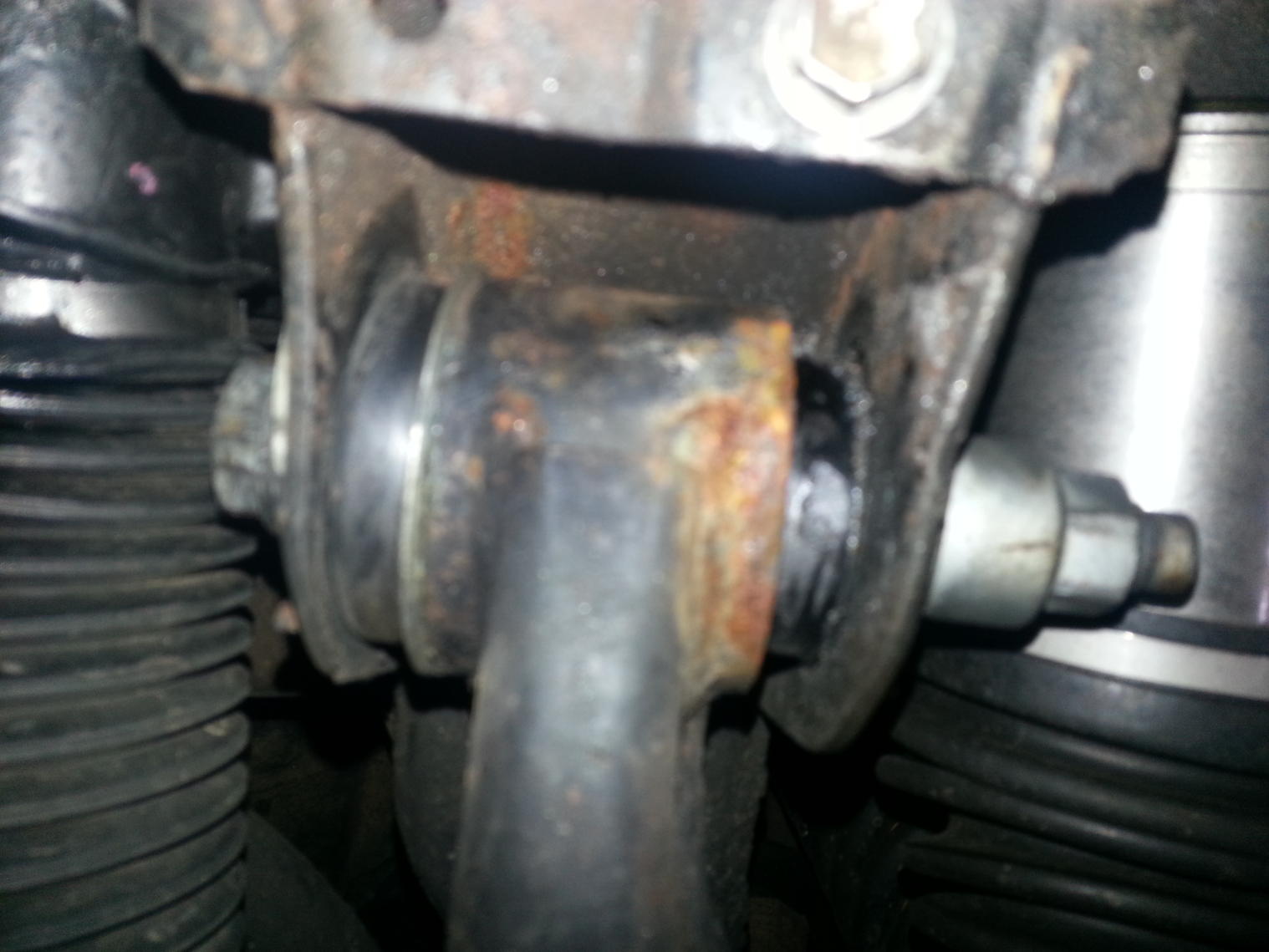

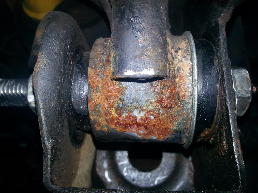

Here is what the whitelines should have looked like:
Here is what they should have looked like being installed (the red stuff is grease):
Here is what they should look like installed:

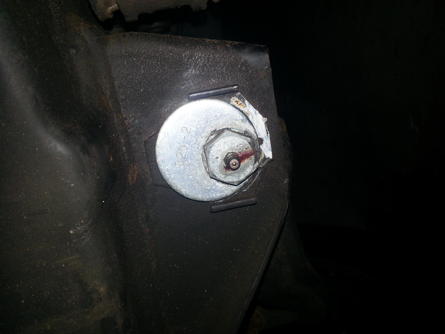

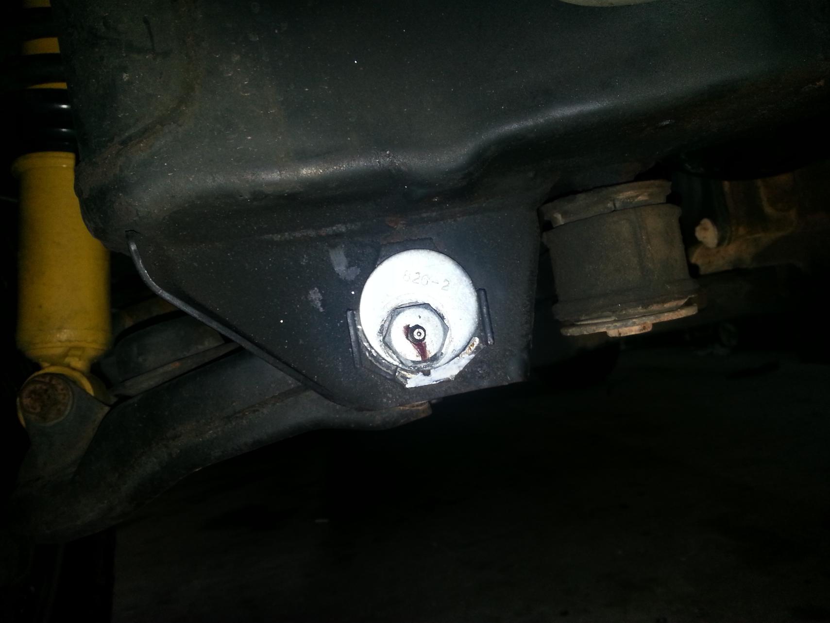

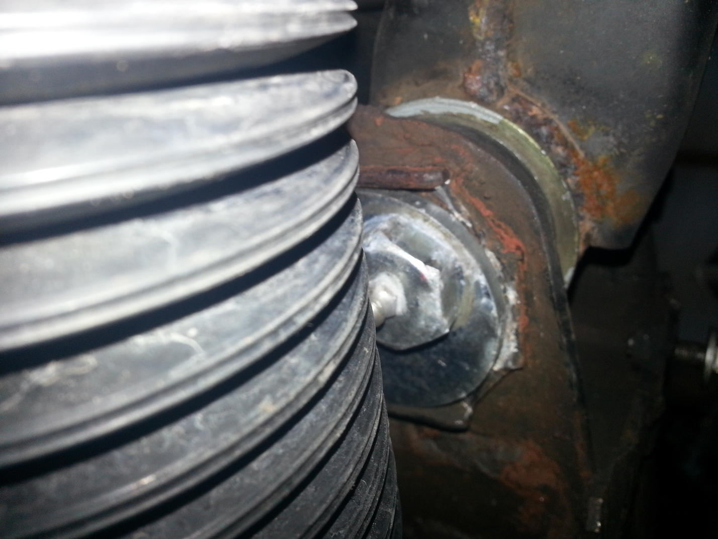

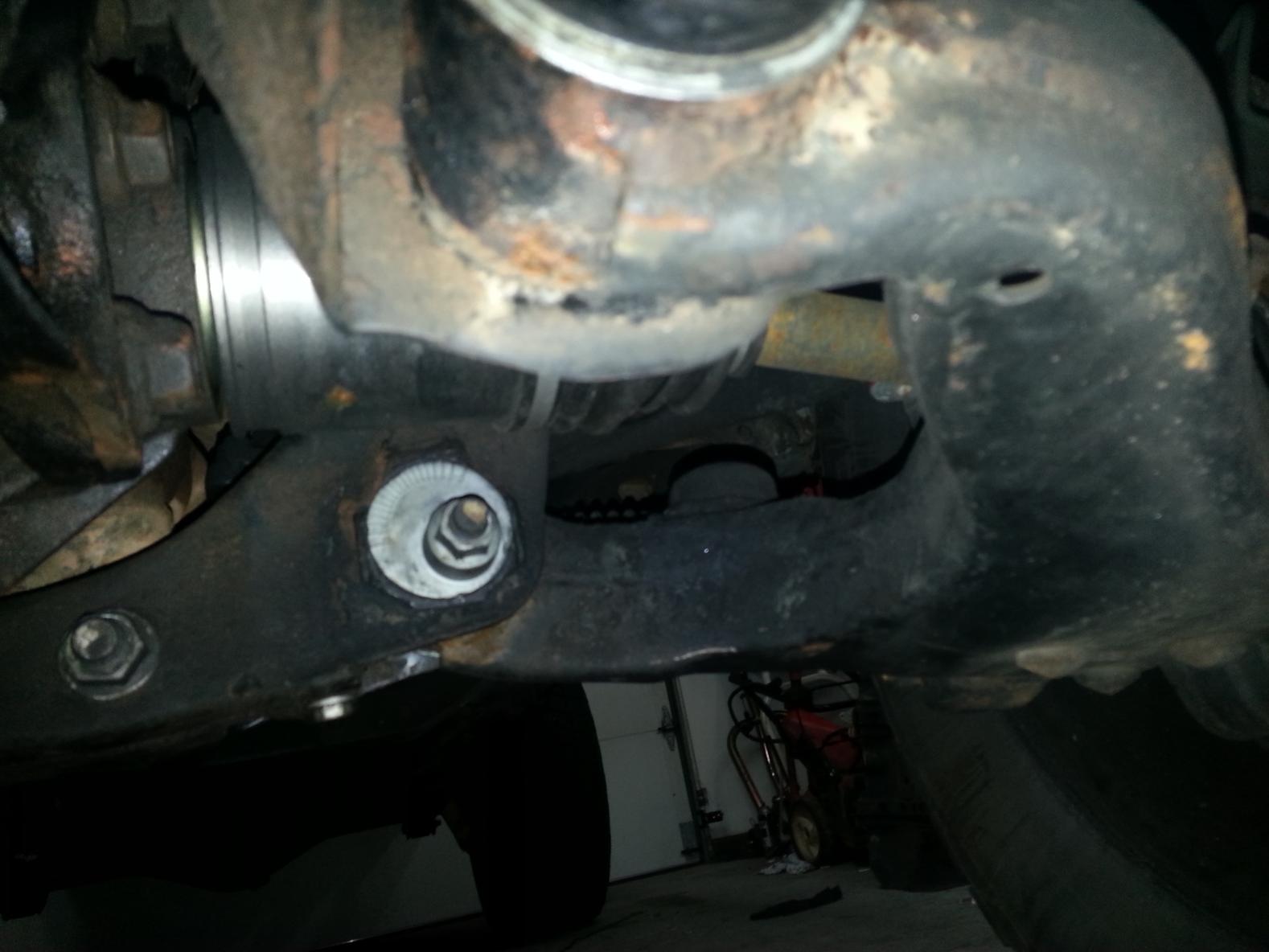

Your eccentrics go through that big hole... THE ONE ON THE RIGHT IS THE CORRECT ORIENTATION. THE ONE ON THE LEFT IS BACKWARDS.
First is the front passenger side, then rear passenger side, front driver, rear driver. Flipping the pictures of the eccentrics around to load.
Yes, they were in the whiteline bag.

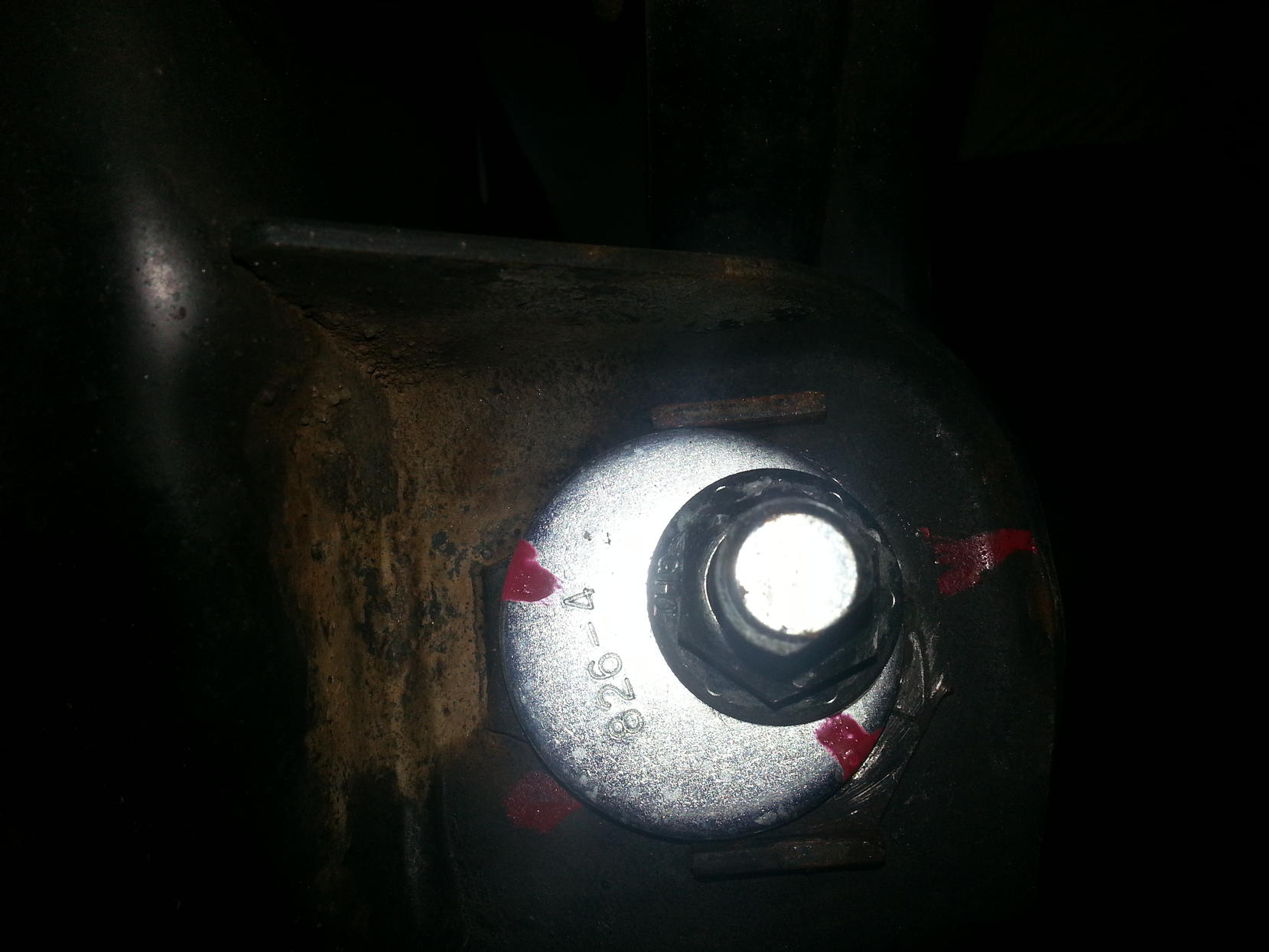

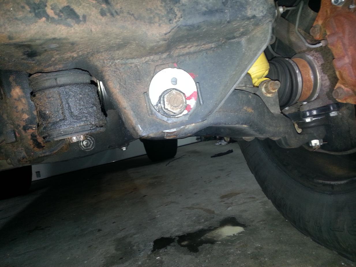

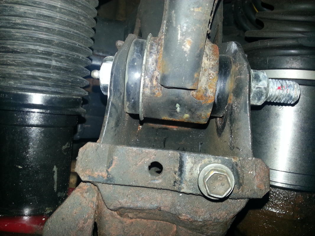

Pictures of the front and rear of the passenger side showing the aftermarket cam plates might be helpful.
The only thing I can think of at this point would be that the cams on them are under-sized.
Same sequence, pass front, pass rear, driver front, driver rear.
When you try to make the adjustments on the front passenger eccentric, the cam plate rotates as it should, but does not move the control arm.

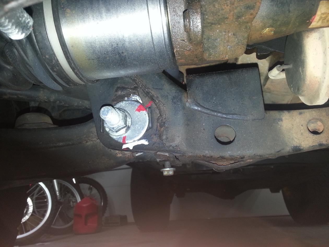

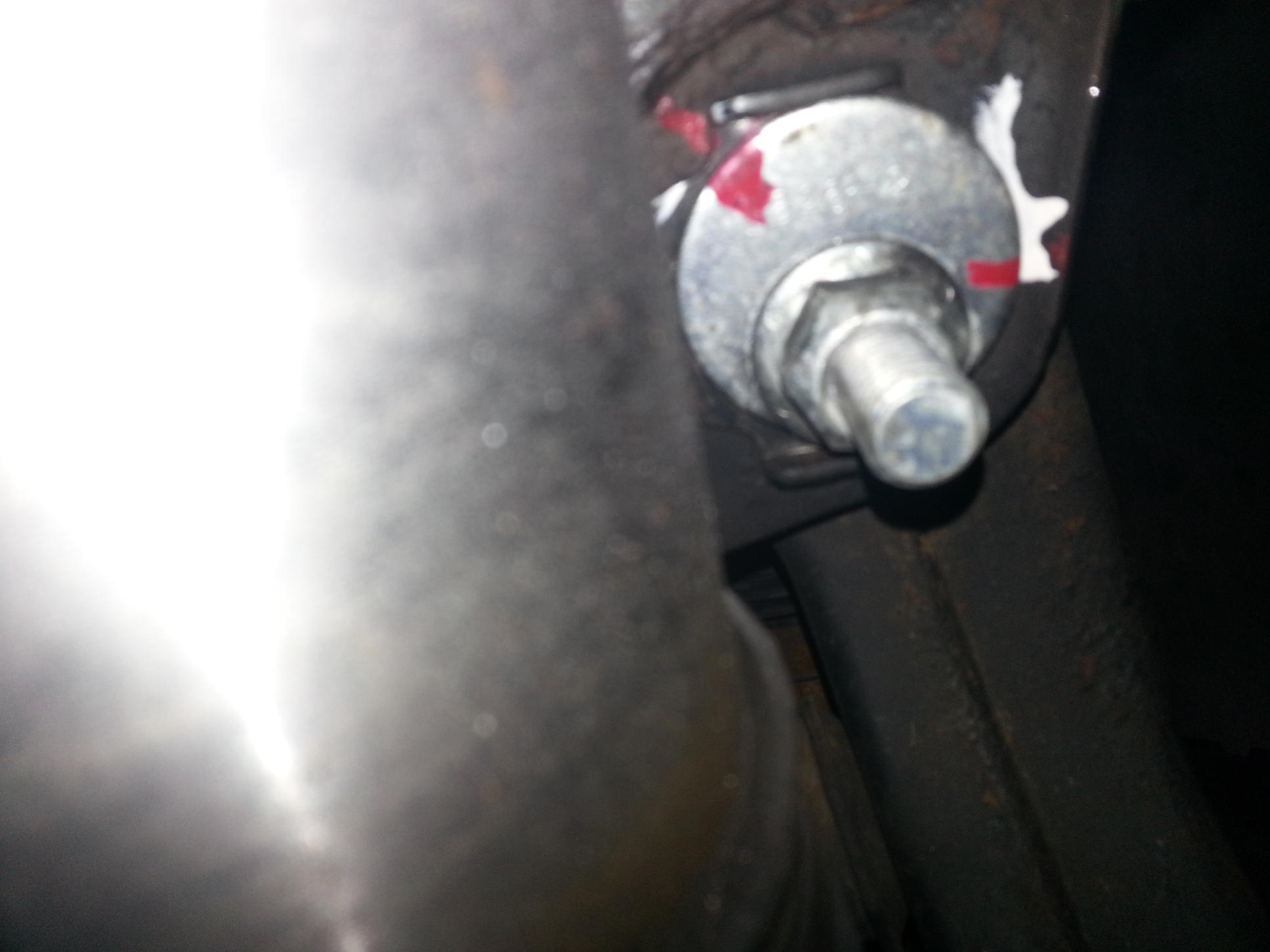

Since you are so quick with that camera - what about pictures of the front AND back of the two on the passenger side. What you have there is the front of the front eccentric and the back of the back eccentric.
You may be able to just look and see - are the front and rear eccentrics on each of those bolts orientated the same? They should turn in unison. Like when you tune that big nut on the front of the rear passenger LCA mount, the eccentric on the back side of the rear mount should turn as well. They should be mirror images of each other.
I would get pics of mine if I was not still at work...
I'll grab a few more pics in a moment.
But, yes, when you turn the nut both cam plates turn together. The rear passenger moves the lca when turned, the front doesn't. To get caster even remotely positive (was only able to get +1.1 because of that damn cam, the driver's side would have let me get more.) I had to use a prybar to move it...then afterward it's felt like the steering wanders, especially on pavement that isn't particularly smooth. I was thinking something with the steering rack being an issue, but couldn't see how it would start right after doing all the suspension work. A side note, I did forget to loosen the bellows on the rack when I did the alignment. Thus causing one to twist and then get partially eaten by the rack's teeth. Checked the rack for play after getting a new bellow and clamp though, and no issue detected. If you're wondering why the paint is on there, I wanted to check for movement of the cams while driving
not the best quality, but here they are

So does the cam stay stationary while the bolt in the middle turns? If so the middle hole in the cam is rounded out and needs to be replaced. Having equal caster and that low can cause the vehicle to wander. If you cannot get anymore out of it drop the driver side to .5 less then the passenger side.
Nope, the came rotates as well, just no movement on the lca. The ones that don't want to move are aftermarket raybestos ones, the other side have new toyota ones. Had to replace all since the old ones had to be torched off, but toyota only had enough for one side and I was in a pinch.
Drop the driver's side what .5 less? as in have uneven caster?
Yeah so it would have equal camber and .6 caster on the driver side and 1.1 on the passenger. If you can achieve this your wander would go away. I set vehicles like this all day to account for road crowns as it will create a unnoticeable pull to the left. Some are even set from the factory like this. I have mine set like this and it drives like a dream.
