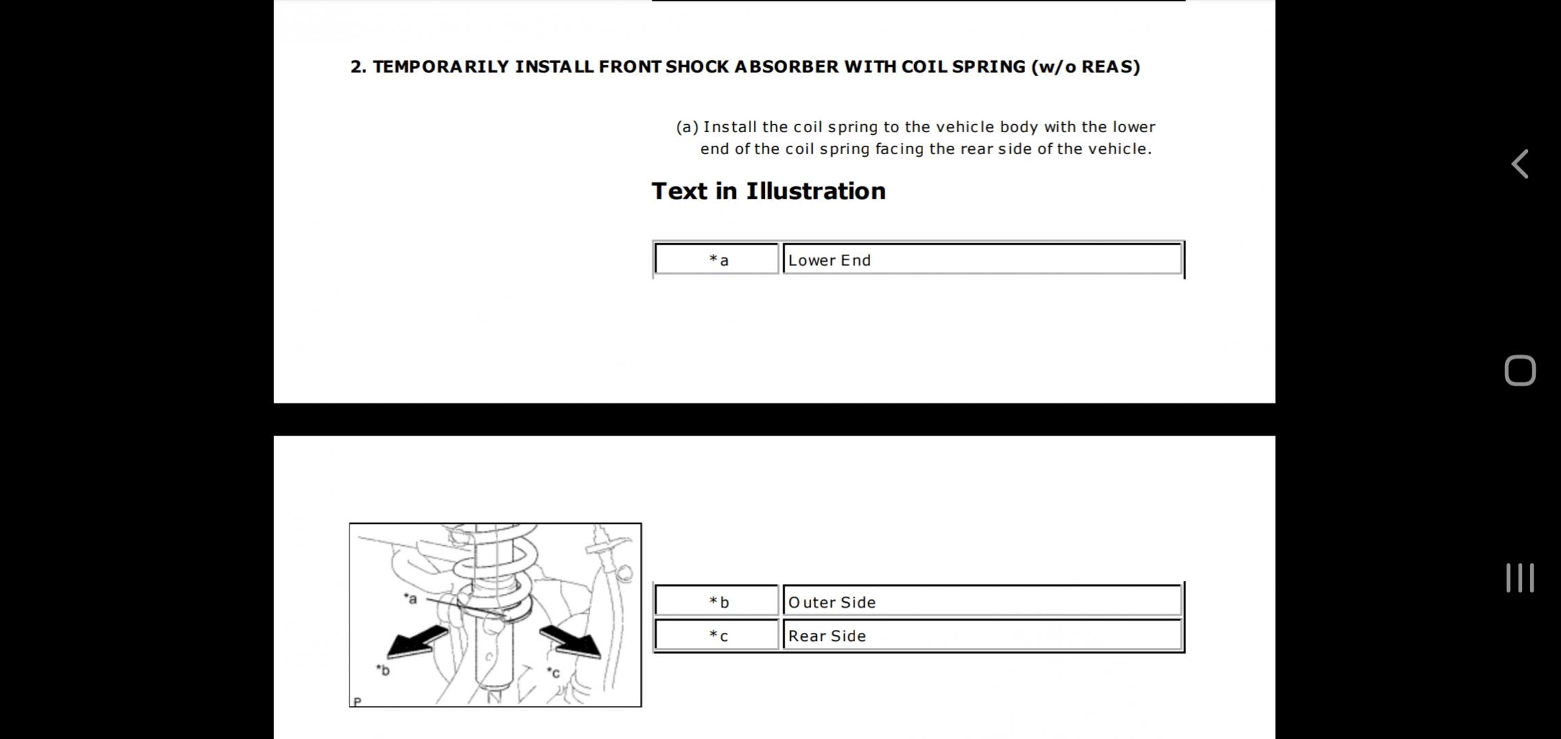

Only other thought is are the coils correctly rotated? Toyota wants the bottom pigtail in the back, as a 180 rotation has caused issues with hitting the UCAs. Should be easy to see marking on the coils if this is the case.
Please explain this a bit . The end of the bottom coil pigtails at 6 o'clock, if viewing from top, with front of car at 12 and rear at 6?
NVM I found it

I doubt the clank is from durobumps - those are supposed to be quite nice. The image you found dictates the pigtail stuff I was trying to describe perfectly. The tail will face the rear of the car on both sides, just one thing to check.
