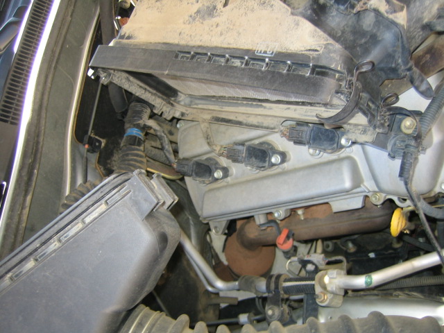

i just finished replacing the spark plugs, a little overdue (37k miles)
it took abou 40 mins and all i need was a few extentions spark plug socket and a few sockets, it was really easy, here are some pictures...
oh yeah the u joint came in handy on the left bank, if you remove that bracket u dont even need the u joint

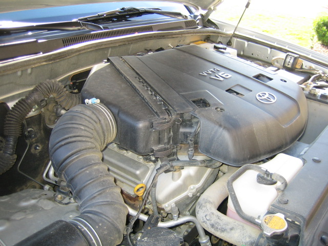

her is the engine with the cover on... very dirty! maybe i go off road too much...... HAH Yeah Right!!!!

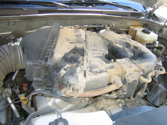

after the air cleaner is taken off so you can access the right bank of the engine

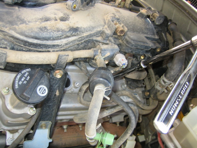

the left bank now,
working on the secong spark plug (notice the bracket is taken off)
i also had to tape the spark plug socket to the extention cause it kept staying with the spark plud down the hole

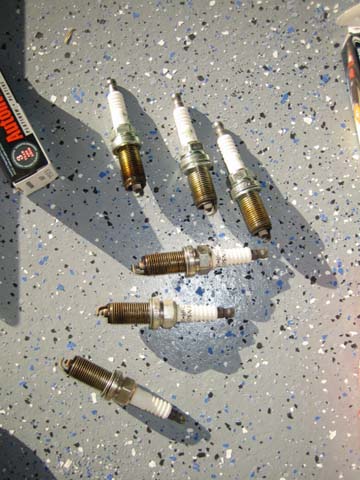

Did you get any sort of mix between the Denso's and the NGK's?
Also what plugs did you replace with, the NGK's?
actually 37K or so miles is actually quite low for replacing plugs as they should really be swapped at like 60K miles.
i replaced them with some platinum autolite ones, the best ones they carried for my truck at the kragen auto parts.

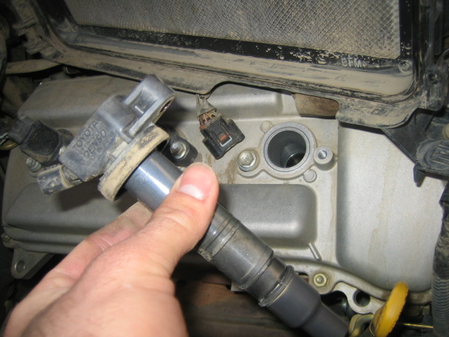

josh,
that whatcha ma-jig is actually a direct ignition coil. it replaces a distributor and provides better spark due to its lack of resistance from lengthy wires.

just take out the autolite plug and clean them up return them. their should not be that much carbon on then since you just install them.
