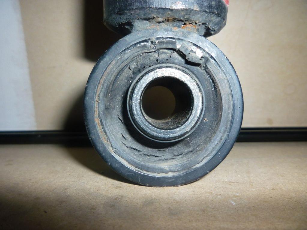

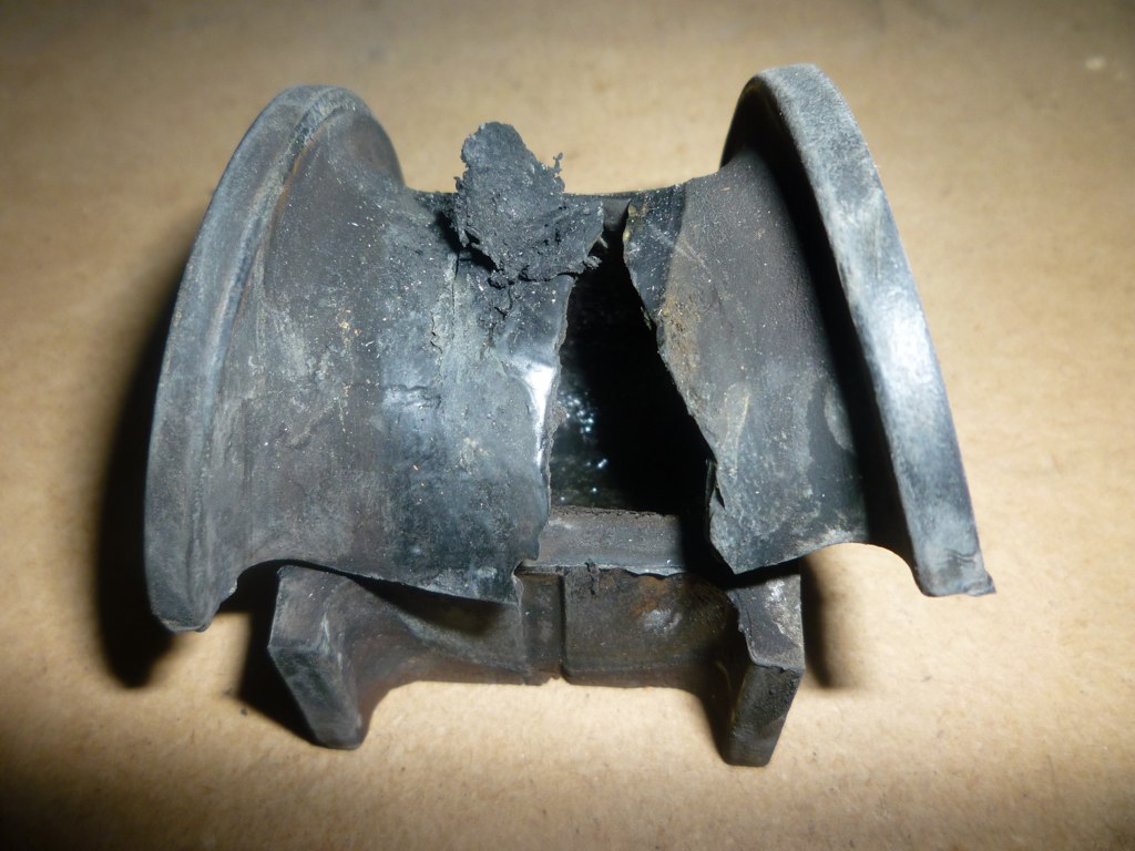

Posting up pictures finally. I mainly took pictures of the parts I took out. I will get under there and take pics of the new stuff.

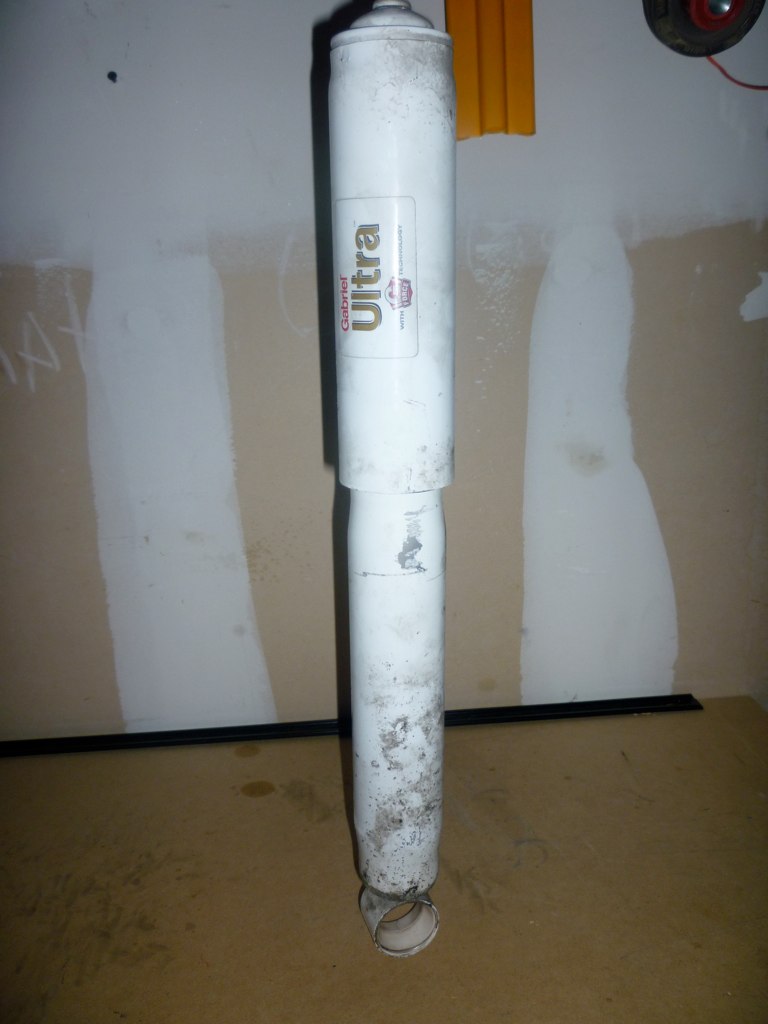

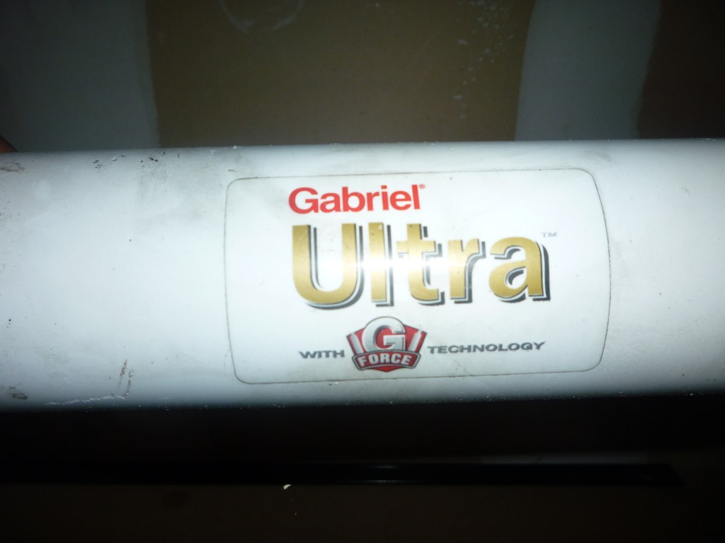

OK old shocks and struts were Gabriel Ultra, I would not recommend using these at all since they wore out under 6 months and were only used in mild off roading 4 or 5 times.
the rubber of the eye was all tore up under load, can't tell here but there was at least a 1/4 in gap/tear before I took the bolt off the bottom support. Keep in mind these are only 6 months old.

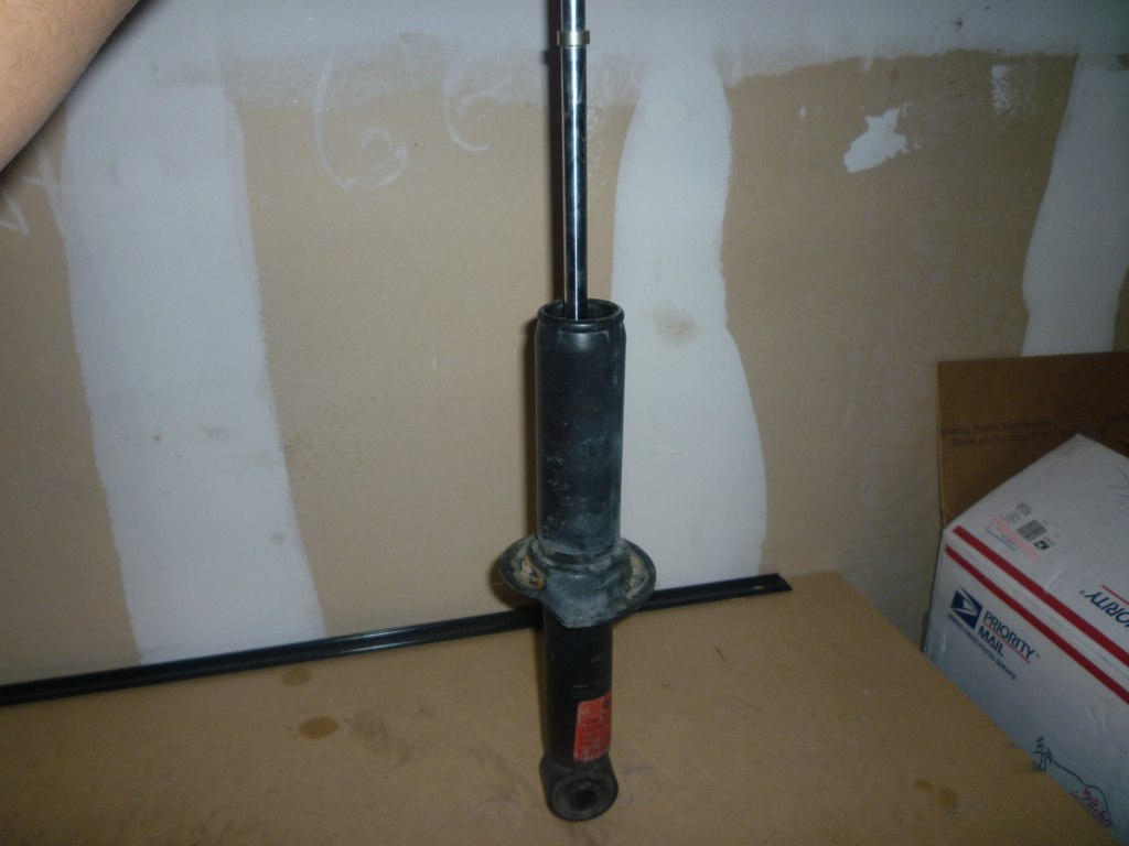

Rear shocks, Possibly some life left in them. Replaced with Tokico OEM shocks.

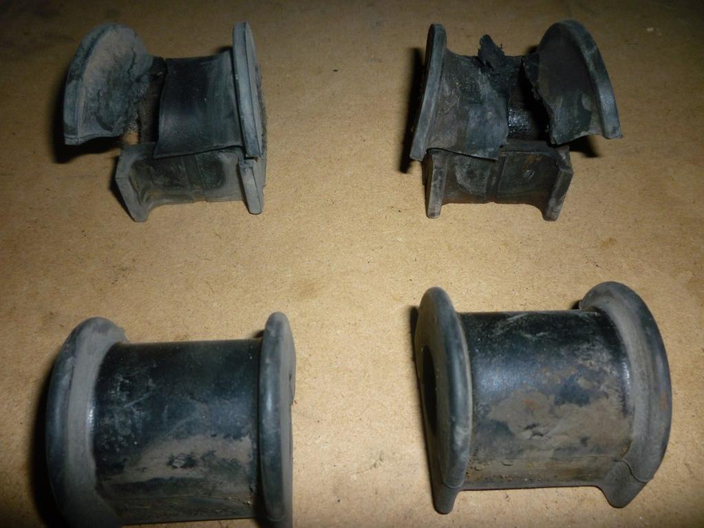

Really worn out swaybar bushings...I went with OEM replacements but will upgrade to Energy Suspension or Prothane later this summer or fall.

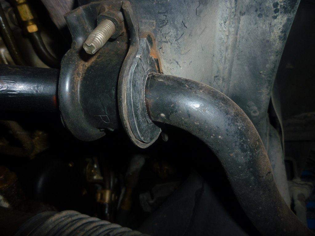

Shot of the OEM bushings installed. I greased one the driver side and not the passenger side. The toyotaparts guy did not know if they were greaseable?? What do you think? Should I grease them both? Seems to drive fine, or is the felt lining contacting the swaybar meant to "grab" onto the bar keeping it from swaying?
