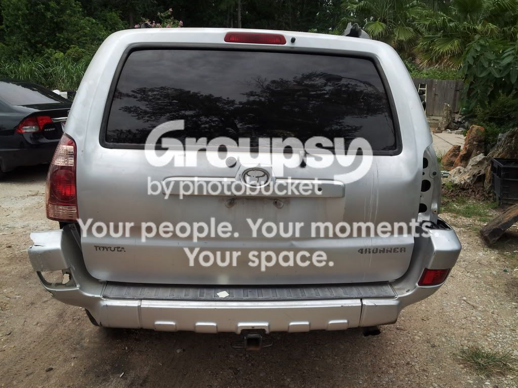

Sell you mine for $100
20120701_121337.jpg~original
Parting out the whole truck, thread to that is linked above in the 2nd comment.
If the OP is not interested in the hitch, I might be for sure!!
It's not sold yet, so payment takes it. Paypal, [email protected]
Unfortunately I'm under the gun time-wise so I need to source something locally. Where are you located? I don't see a location on your profile.
I'm in Houston, if dropped off at SW Airlines you would receive it in a few hours for minimal shipping charges. If you decide you want it, Paypal, [email protected]
