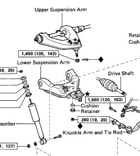

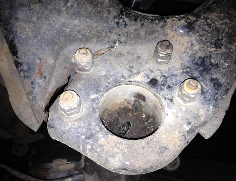

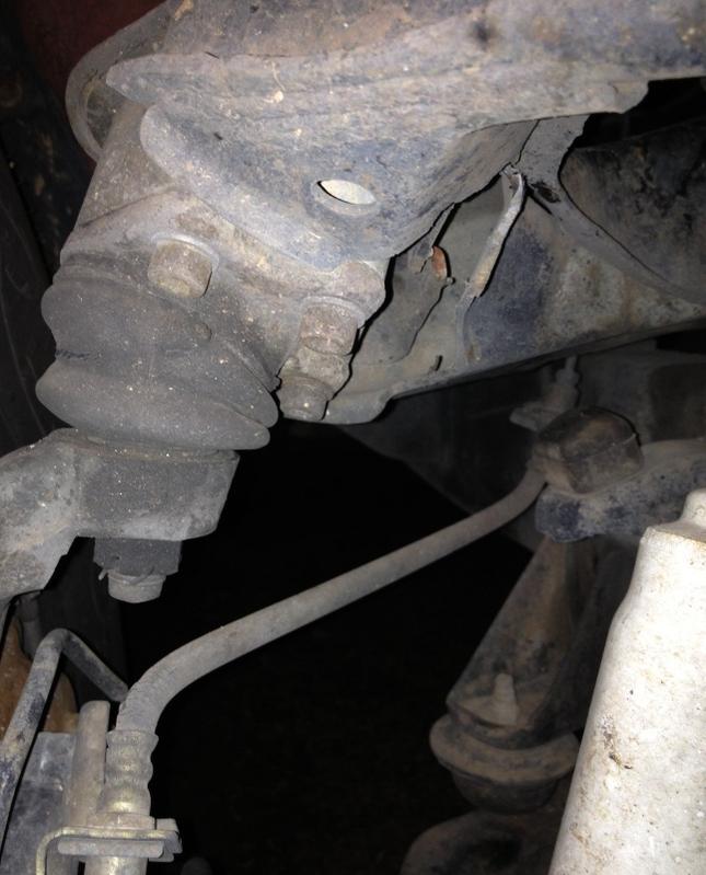

Although it's called the Upper Suspension Arm in the FSM, I think it's more commonly called the Upper Control Arm. Anyway, as the attached photos illustrate, I need to replace mine on the passenger side.
Is a salvage yard the best option?
Are there better aftermarket options?
What else should I be replacing while I'm messing with it?
TIA,
Jon
