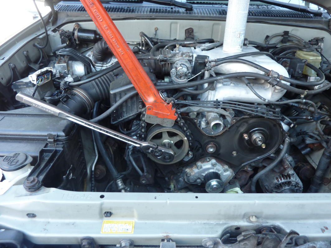

Here is my new tool. I'm really hoping this helps me. I will try it alone, to start. If I can't get it, I'll look for a second set of hands.
My new chain wrench worked like a charm. It was perfect; it's so nice to have the right tool for the job!
I cut a section of the old timing belt to wrap the cam gears and protect the teeth. Here is a photo of the arrangement. Getting those bolts to break free was still a big struggle. I had to get up on top of the radiator support and line the wrench and breaker bar up just right for leverage. The cam gear bolts must have been torqued to 150 ft/lbs! I got the seals pulled and replaced, hammering the new seals in with a 1-7/16" socket (I think). I also replaced the oil cooler hoses. sfg, your trick with the needle nose Vise Grips was helpful. Thanks for all your help and suggestions!

I agree with you that they probably weren't torqued to a higher spec, just "stuck". Using the chain wrench, I was able to torque the cam shaft bolts; I set them at 85 ft/lbs, instead of the recommended 81 ft/lbs :) Also, thanks for the advice, I am using a new crank shaft bolt. It's the updated version.
