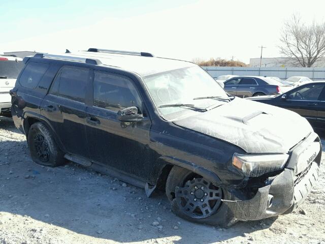

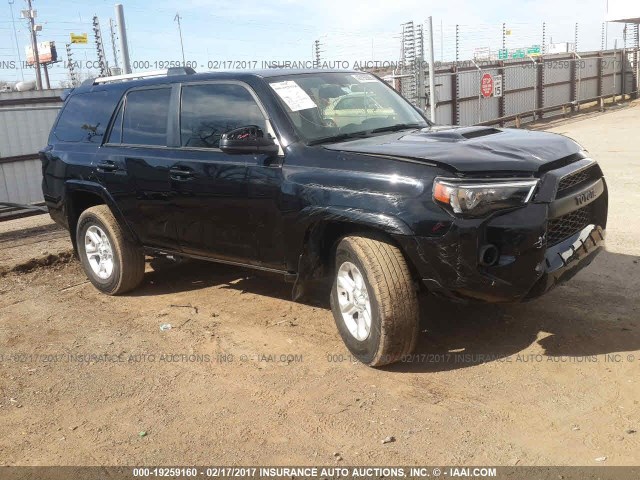

I have a 2015 TRD Pro that I purchased wrecked. We have tried everything to start it and we are at the point (the various mechanics) that we are going to put a running motor in it. We think it has something to do with the variable timing because we get varied compression readings and it just tries to start with no visible problems. The history of the vehicle is a little vague but I found out from the young man that 1) he hit a bridge and went over it and 2) they never started it again after that.
And no I haven't taken it to the dealer because one of it's wheels is hanging on by a thread and I can't take it to my local/nearby frame shop until it is running :(

Is the hood looking like that because the entire powertrain is pushed upward from this Dukes of Hazzard bridge jump ?
The only thing I could perceive especially if the motor is cranking over freely is timing chain jumped or broke from that impact and now your valves are all out etc. etc. in that department. Someone has to pull off the oil pan and look up, pull off the valve covers and look down there to ensure everything is in its place, if your compression readings are slightly off thats one thing but way off - scope it out and see why, the motor should not have grenaded itself from a jump and if it did - damage will be obvious when the pan comes off. I'd hold off on a new motor just yet. Nice project though ! :cheers:

If you look at the pictures you will notice they are insurance auction pics. I'm guessing the current owner bought it from the insurance auction as a pink slip vehicle.

Is the bottom picture after they cleaned it up for auction?
