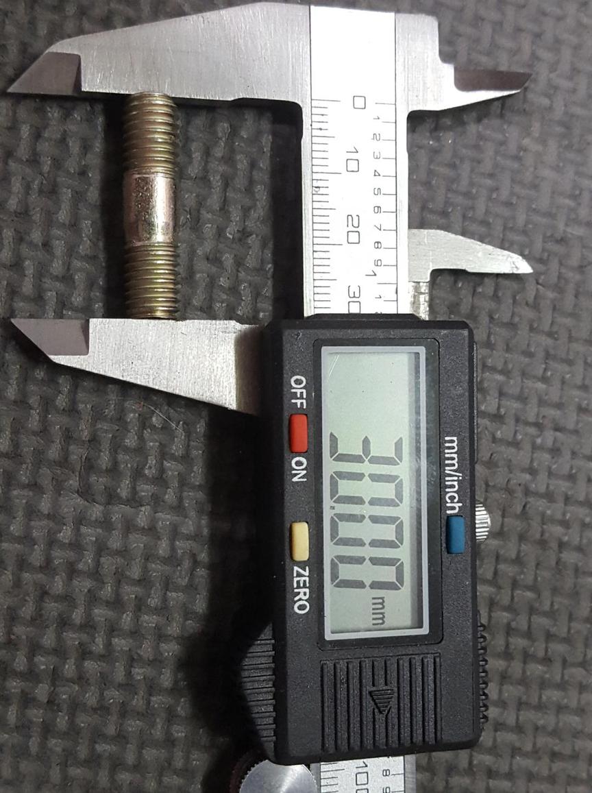

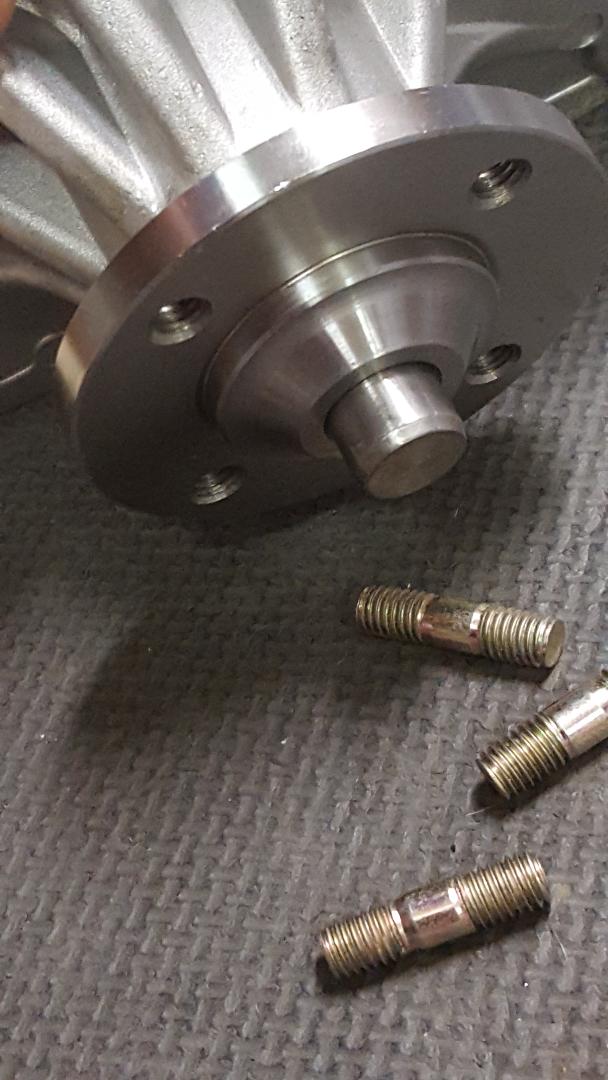

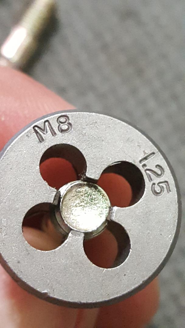

That’s it. Are those studs removable or do I need to buy the entire bracket if one is snapped?
I would think so but not sure, I have a new one at home I am going to swap out when I do the timing belt, I will check it later tonight. I have to go by the dealer today and will ask the parts guy, one of the guys is pretty sharp, the others just read what the screen says.
This is an aftermarket unit but I'm pretty sure it's the same spec as OEM
