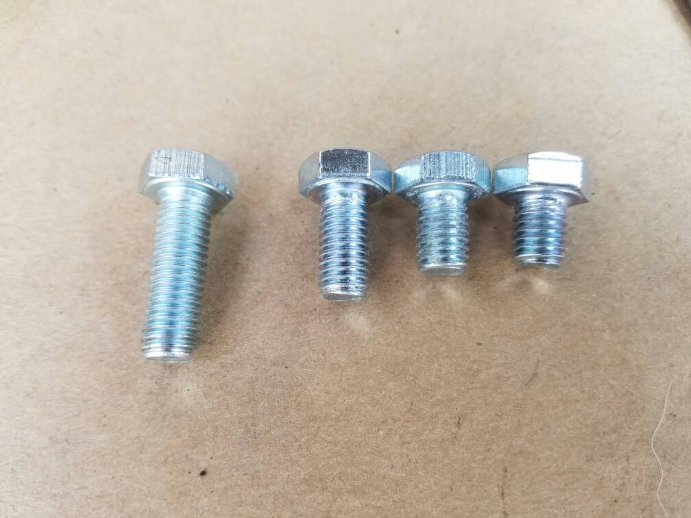

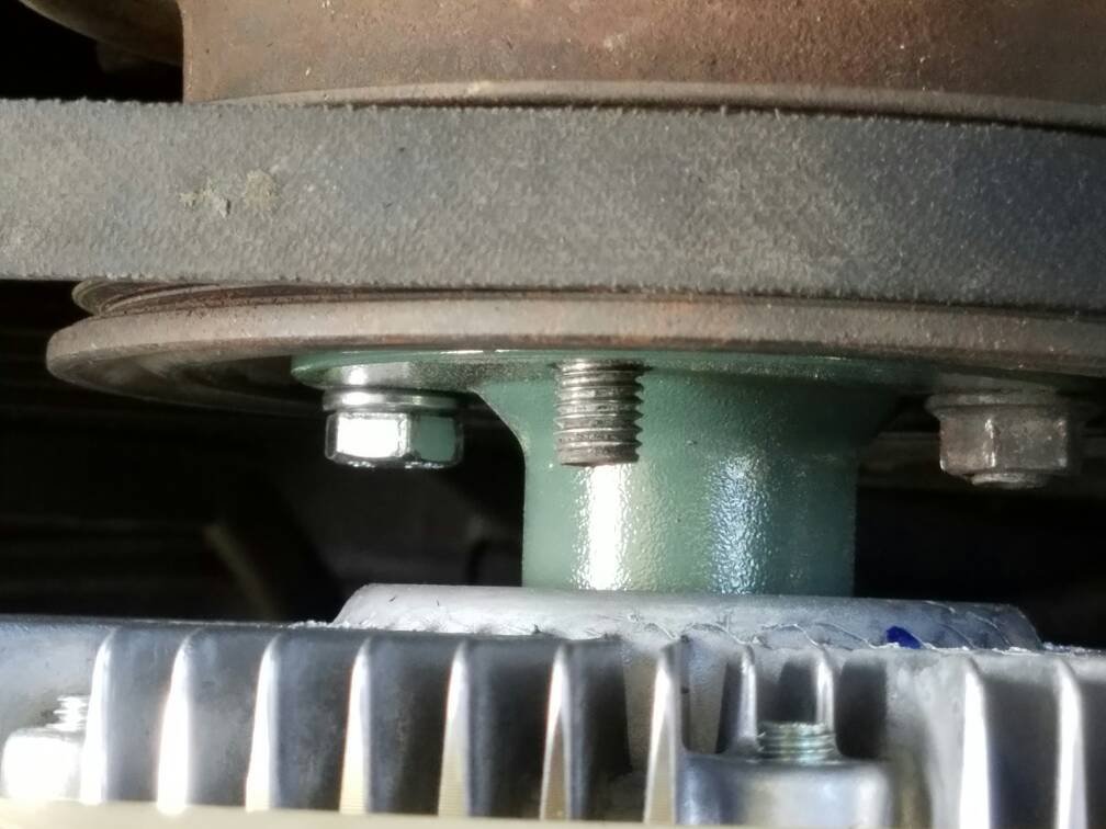

After discovering that my Fan assembly only has 3 bolts, I have been searching for an alternative to replacing the entire fan bracket assembly. I thought about cutting some threaded rod. Then I decided to just buy a long enough M8 bolt and cut the head off. However I was concerned with how the threaded rod portion of the bolt would sit in the bracket. How does the factory bolt dtay secure? Is it welded? Locktite? Maybe the bracket female threads stop at a wall in order to torque the threaded rods to a high enough value to prevent backing out?
Well however they chose to install it, the previous threaded rod came out, what's to stop this one from doing the same? It was at that point I thought, why cut the bolt at all? Why not buy a bolt of the appropriate length and just use the bolt as it was intended.....to bolt stuff together. I bought several lengths of M8 bolts since I did not know what size I would need.
I bought a 25, 20, 16, 12, and 10mm just to avoid a 2nd trip to the store. I ended up using a 20mm with a 5/16 lock nut washer to simulate the effect of the flange nut with the 'teeth' for digging into metal. I found that with the lock nut washer, the 20mm barely caught the threads. It was just enough so I could put a wrench on it to tighten down the lock nut washer. Had I used a flat washer, threading the bolt would have been no problem. I even think I could have gone down to the 16mm bolt with a flat washer as I had the fan contorted a little when trying to thread the bolt. I think it turned out pretty well. I might try swapping out the bolts when I change the belts.
The bolt that missing in the 1st picture is the 20mm

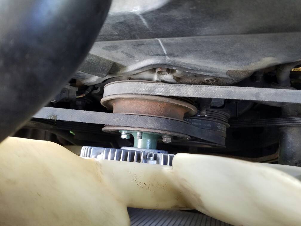

Bringing old thread back due to the same issue as Zion. While doing some trails yesterday my fan blade broke (2 fins) and while replacing everything I noticed one of the bolts/nuts holding the clutch on is missing. One question is, should I be able to remove that broken stud and then put new one in (or 4 new bolts as shown here) or will I be needing a new pulley/bracket that actually houses the studs? In other words are the studs removable from the pulley? 2nd question is, what actually houses these studs... looks like the pulley is bolted onto the bracket then fan clutch onto the pulley?
Thanks
The bracket holds the studs if that's what you are asking.
Is it normal for the nuts to "loosen" as you tighten nuts on the other side of the flange? I had to do a few rounds to get them all tight. I don't understand why because it just looks like a round flange, not sure why there would be so much flex in it.
