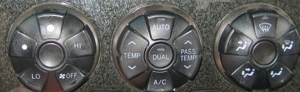

when I push any button on the climate control panel, the Button will light up. However, in darkness, I found that there was no background light? I mean, I can not see what the other buttons means in dark because there is no light on the button except the one I already pushed.
This is my first toyota vehicle, I am not sure if this is normal or some broken bulbs.
what i mean is these buttons:

We haven't found the backlight bulbs. I've replaced all of the bulbs and still my climate center is dark except for arrows, and only when I push them.

I know this is an older post, but did you ever figure this out? I have also changed all the climate control bulbs and everything is backlight except the fan control- only the arrows light up when they're pressed- no backlight so it's "dark" until you press an arrow.
