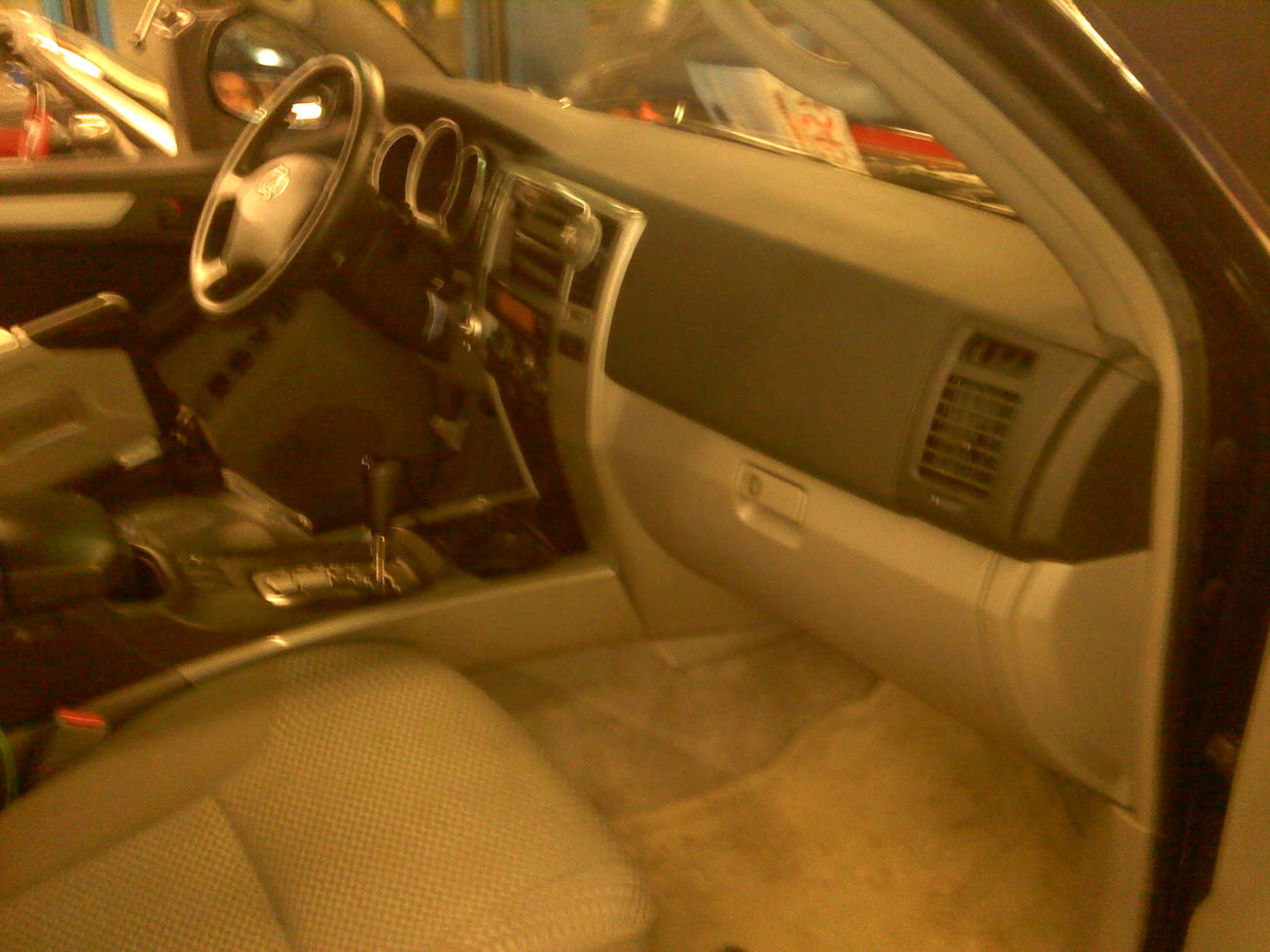

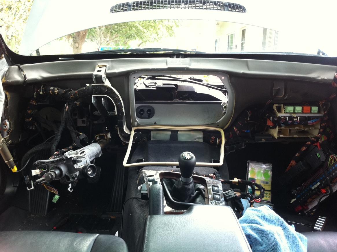

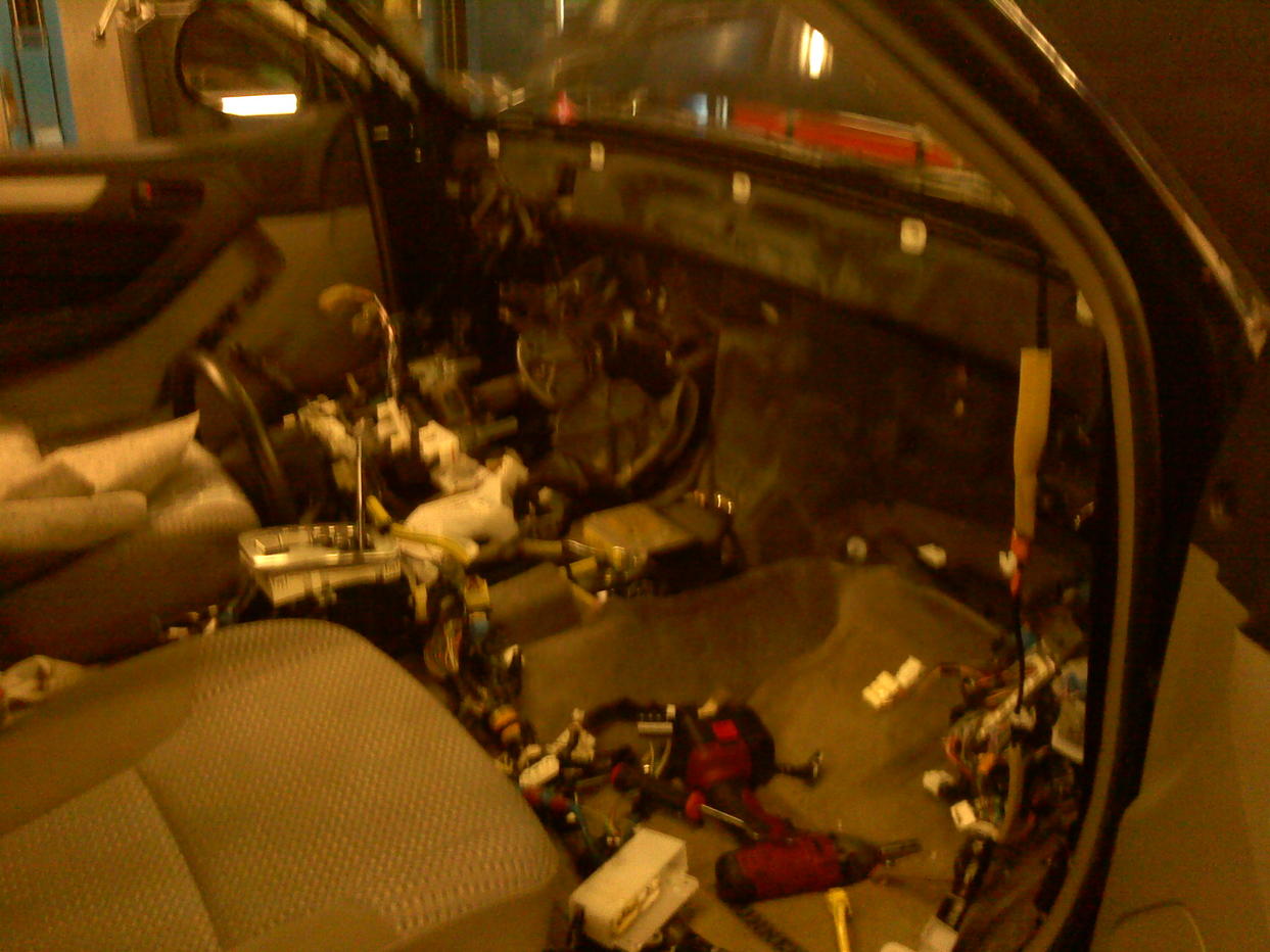

I hope you are good at taking things apart and getting them back together correctly because you have to take everything you see in front of you when you're sitting in the seat apart to get to the evaporator and I'm assuming the heater core, i.e. entire dash and assorted pieces, etc.
Here's what your dash area will look like by the time you get to the evaporator, the first photo is a 4 Gen 4 Runner, the second is a BMW, but both pretty much involves the same crap that has to come apart, the last photo is the 4 Runner back together again.
