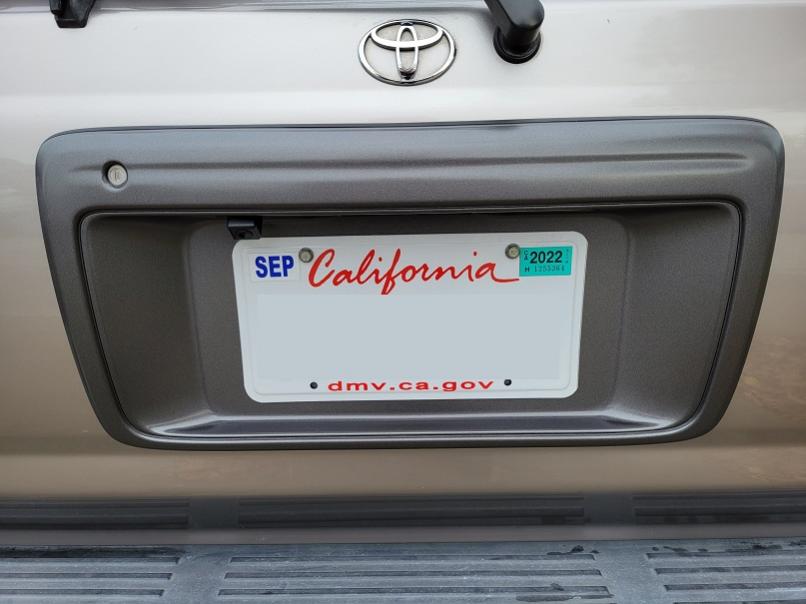

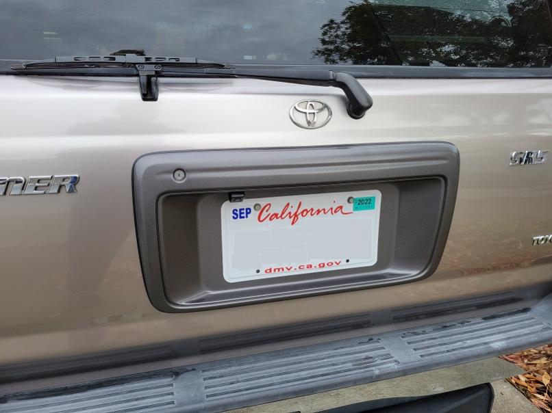

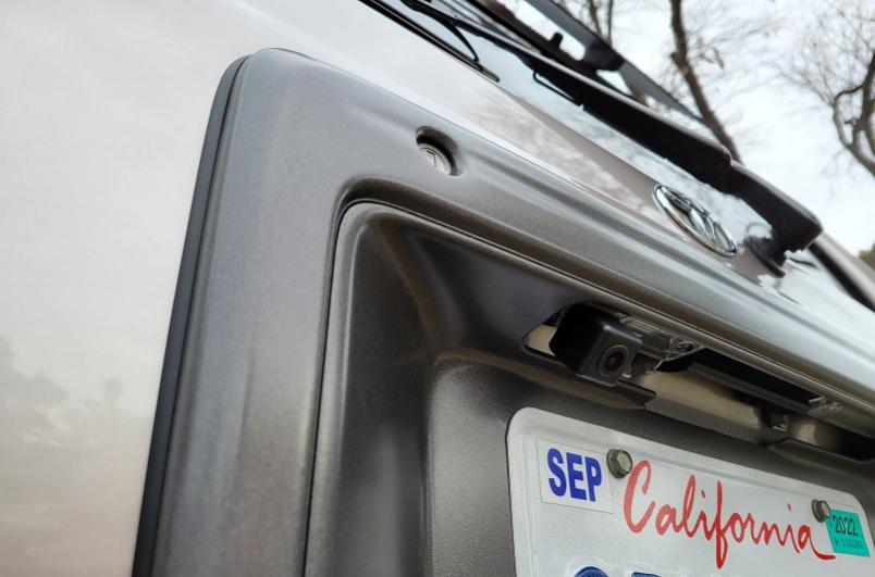

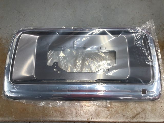

I just finished painting and refurbishing a bezel I pulled from a junkyard.
I used Rust-oleum Flat Soft Iron, followed by Satin Clear Enamel.

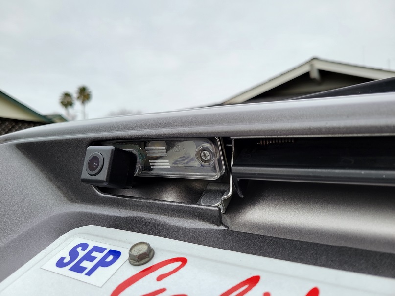

We also installed a rear backup backup camera while we were at it.
It took several hours to complete, but I'm happy with the results.

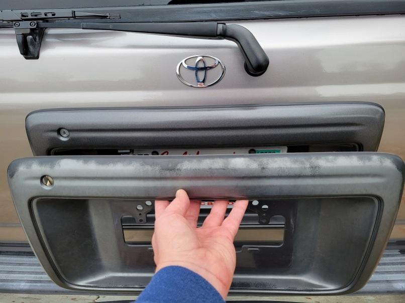

Installed my original 96-98 back on the other day. The chrome 02 bezel didn't cut it for me any more.
Did it with hatch open. Propped the black metal plate. Kept rear window closed. Used a 12" long skinny 1/4" drive- which is perfect for removing all 10mm nuts and plastic clips (press an rotate) Took about an hour. Don't mess with window mechanism or hatch handle- let in rest insitu.
Debadged the rear hatch leaving 4Runner one on bezel only. So much cleaner looking.
One thing, as I went from the larger later bezel to original smaller one I have a faint tide mark.
