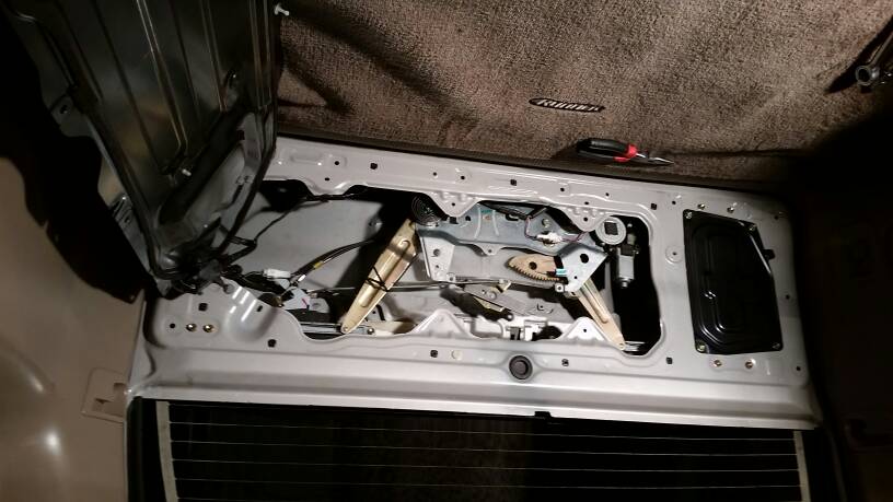

Old thread but I wanted to post here since others may have the same problem. When replacing my license plate surround, everything went great until I tried to reattach the 4 bolts for the window motor assembly. I did this with the window all the way up and now I can't get enough slack to align any of the 4 bolts. Any ideas?
Problem Solved. Here's what worked for me.

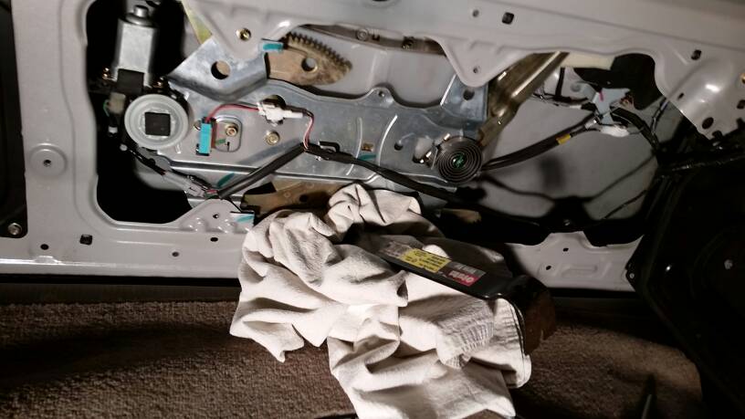

With the window motor assembly still unbolted, I closed the lift gate and reconnected all the electrical connections. I then carefully used the dash control to lower the lift gate window just an inch or so. A few short taps to the switch. This gave enough play that I could easily align and bolt down the assembly.
I want to add something. I used a crow bar to help lift the motor to line up the holes. This was an extremely difficult mod, so be patient and be careful. The teeth on the motor are wicked sharp. 20160227_194009.jpg20160227_200903.jpg

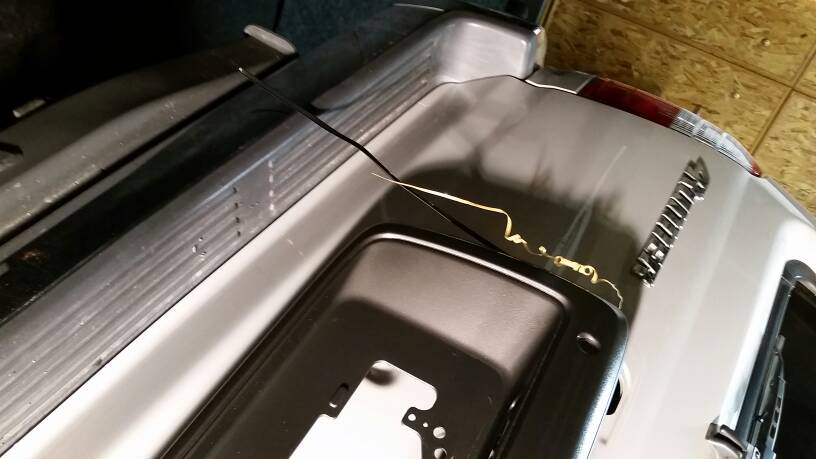

You can also order the replacement seal, so water does not get into hatch.20160227_193257.jpg

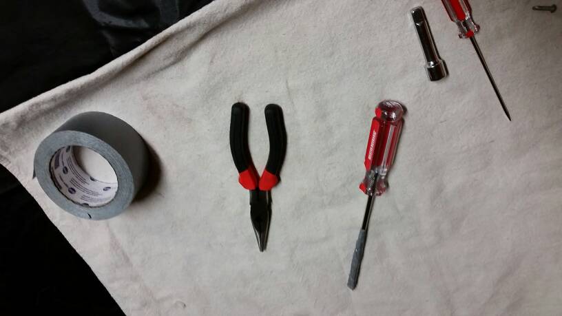

One last thing. Long needle nose pliers are a must.

I want to add something. I used a crow bar to help lift the motor to line up the holes. This was an extremely difficult mod, so be patient and be careful. The teeth on the motor are wicked sharp.View attachment 228463View attachment 228466
You can also order the replacement seal, so water does not get into hatch.View attachment 228467
