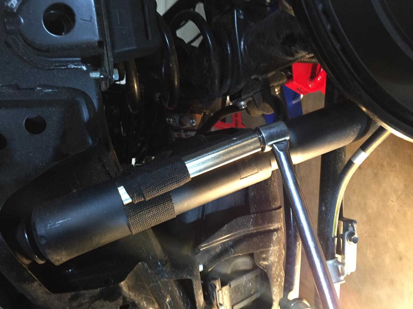

I found that a strap wrench makes removing the shocks much easier. Otherwise they twist. My pic is flipped, but you get the idea.

Burgh, great idea on that strap wrench. Stupid question though, how does that prevent the shaft from turning inside the cylinder when you tighten down the nut on top?
I guess I should just come out and admit -- this is the first time I've replaced shocks like this -- All other time it's been "quik-struts."
