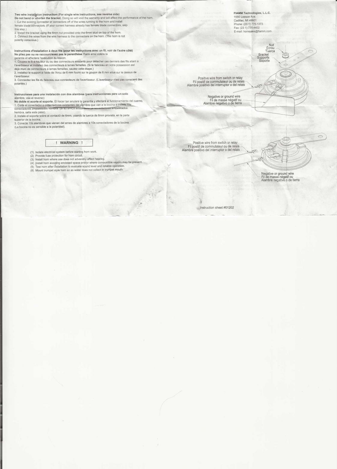

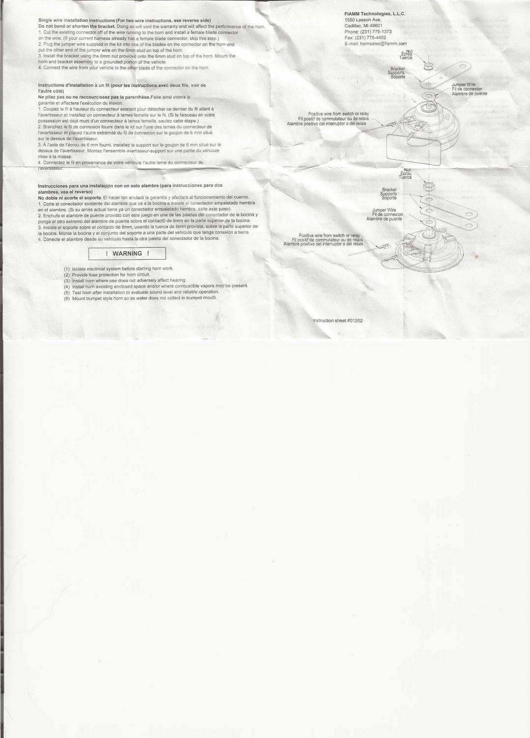

The instructions that came with the new horns were not very clear to me, so I attempted to follow them.

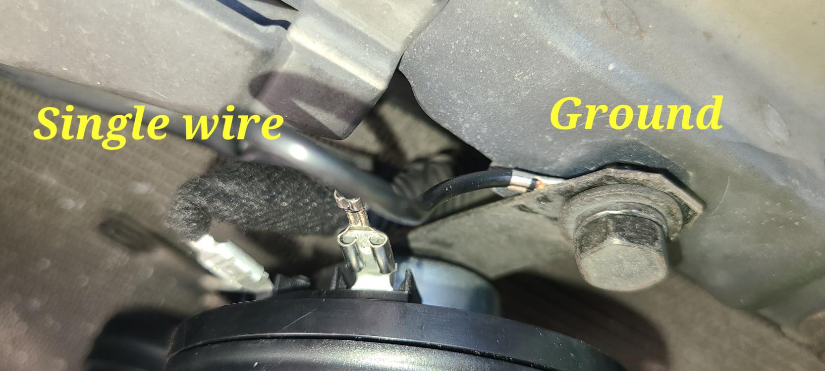

I connected the single-wire connector to one of the terminals on the high-note horn, and then a grounding wire to the other terminal and the other end of that wire to the bolt that attaches the horn to the truck's frame.

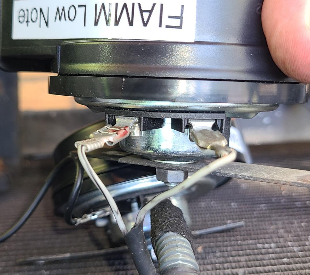

For the other horn; the low note, I simply attached each of the two wires with the blade connectors to the horn's terminals.
However, only the high-note horn sounds. I have made certain that the aires in the blade connectors are tight and secure, and the connectors are tight on the horns' terminals.

It looks to me like you have a poor ground connection. Pull the bolt out and grind away the paint around the bolt hole. The bolt also has a coating on it so take a wire wheel/brush and remove the coating.

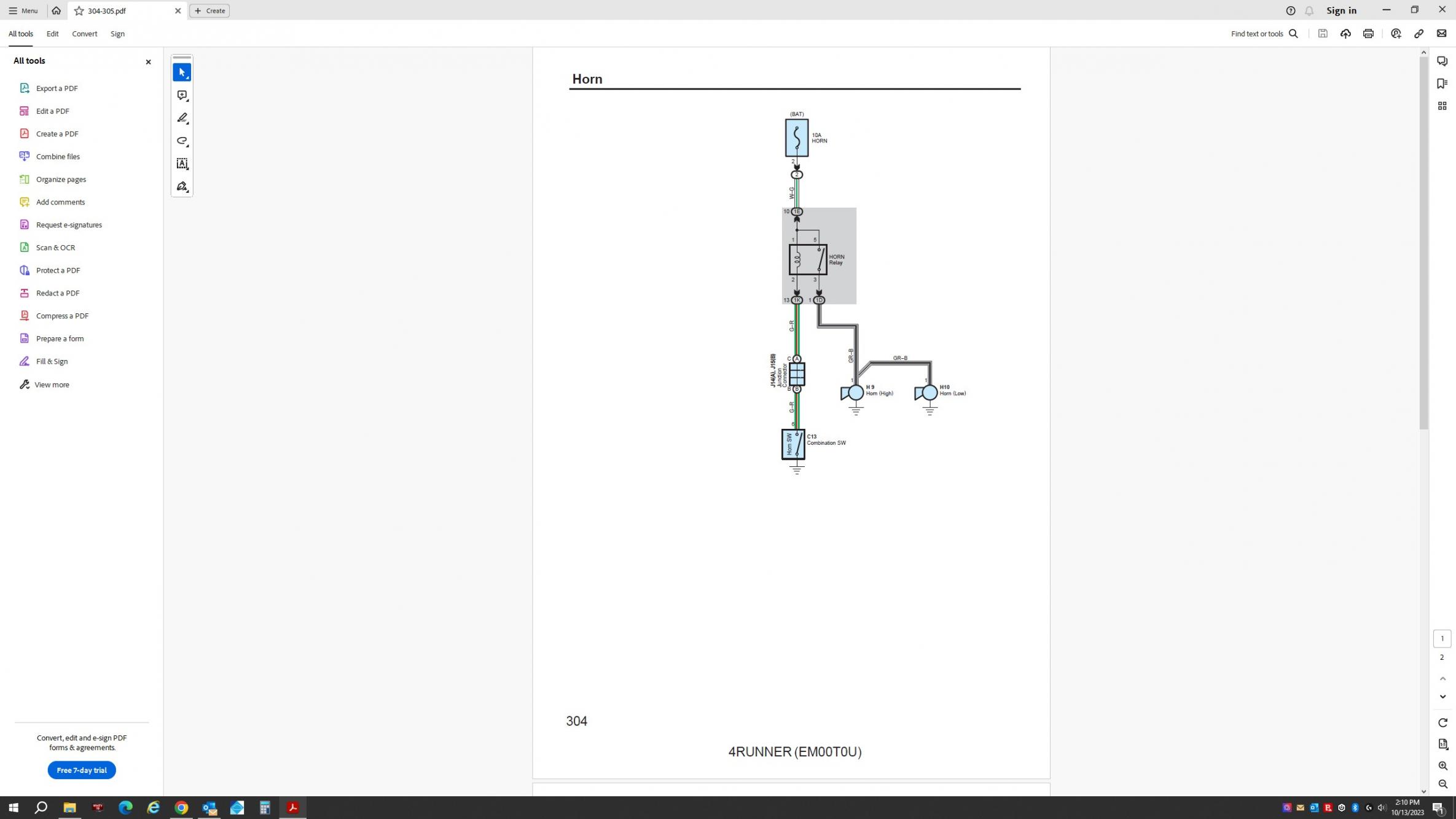

on the factory wire, one of them is actual 12v signal, the split you cut off, verify that was not the 12v you cut out.
unplug the split one you cut off. check the 12v side. gray-black is actual 12v, connect those back together. and put a new ground wire to the horn with no ground.
View attachment 304-305.pdf
