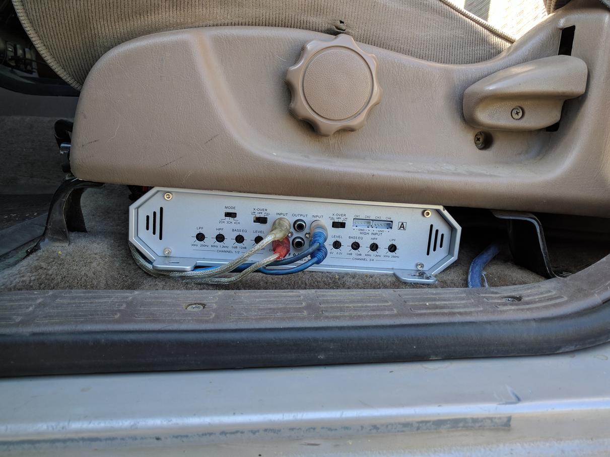

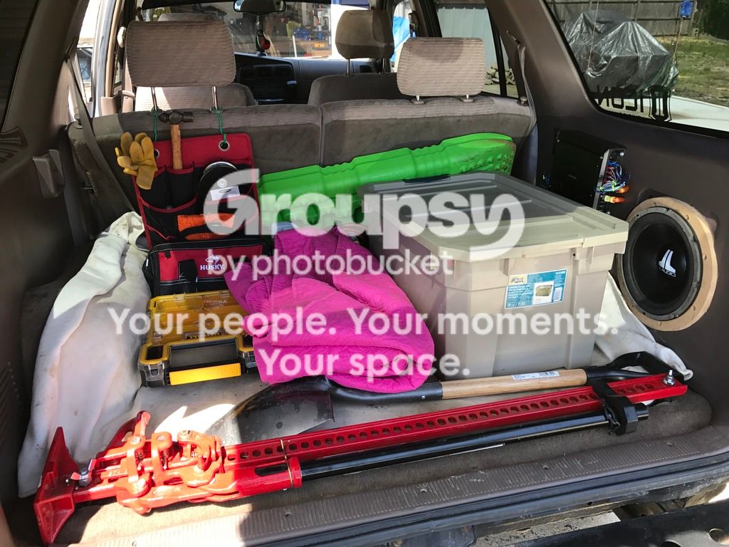

check out my sub and amp. Kenwood 5 channel amp. Powering the 10" sub and 4 kickers. Sounds awesome. Not to much but enough to enjoy the music. Rather then running each separate wire for each speaker. I simply ran a 9 wire. And you just tap into the oem harness and the other end is for the amp and one wire left for powering the amp. Doesnt get any easier
Do you have a link for the sub, kickers and amp that you have?
