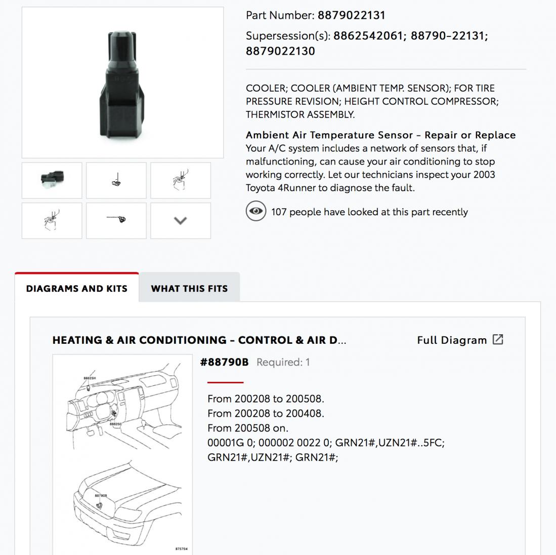

Not sure if this is what you are looking for.

I thought the A/C thermistor was in front of the radiator.
No I have replaced that sensor you posted on mine and it is the sensor for the ambient outside air temperature that is displayed on the info screen above the AC controls.
