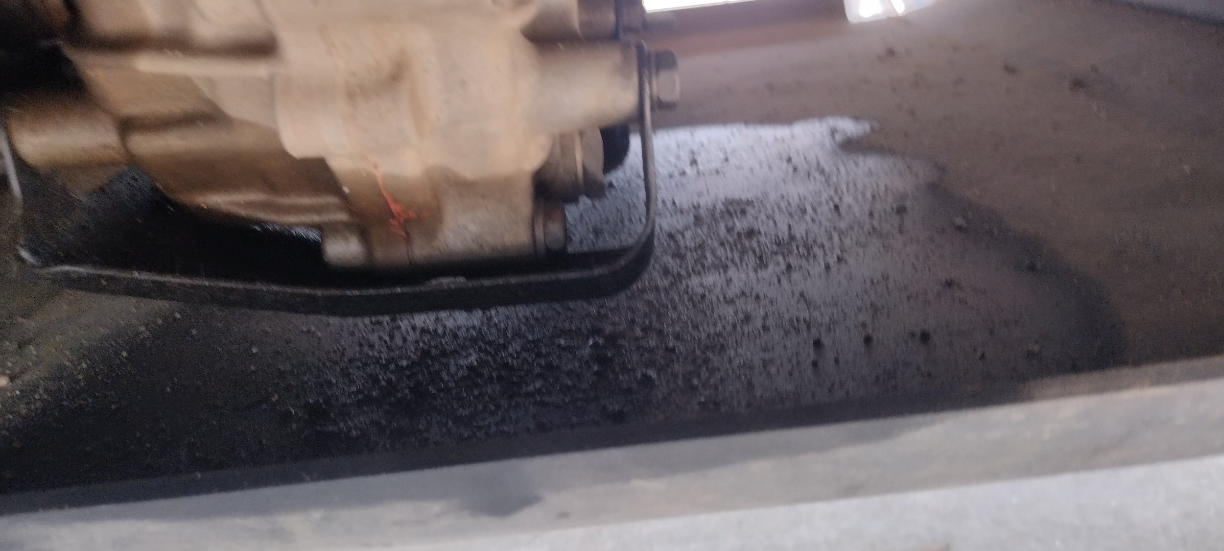

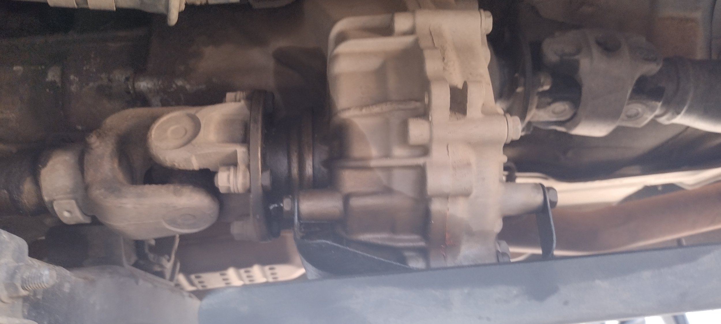

Well looks like my front seal is going out too.

I think it's just my inner seal as it seems dry on the companion flang to shaft interface. Went to the dealership down the road and wouldn't you know it, the inner seal is the one they don't have in stock there right now so I'll have to wait till Friday. Only 8 bucks more to do it so I'm doing the outer seal too while I'm at it and also got the nut. I have to do an oil change anyway and this also gives me a good excuse to change my tcase oil so I know when it was last changed (it looks good right now but hey it's only 8 bucks to fill it up and I'm going to lose all the fluid one way or the other doing the seal). Might also retap my two skid nuts that are stripped while I'm in there too. Also get the feeling that this is all a result of the breather being clogged. I was just in there too doing a short throw shifter upgrade and everything was crusty on top where my shift knobs were. I cleaned off the transmission shifter seat but not the tcase one ><
Good tips in this writeup. Have most people had good luck with that seal going in by hand? Seems like the rear seal doesn't but the two aren't the same seal either. As to the nut not needing to be unstaked to hit it with an impact, this actually makes perfect sense that this works without buggering the threads on the output shaft, the nut is obviously made of a very soft metal while the shaft is hardened steel. If anything unstaking it probably has a greater chance to damage the threads as then you are potentially introducing a shard that get's compressed in there trying to get the nut off. I plan on just hitting it with my impact.

Correct it's the inner seal as you can see the gear grease is all on the case..:)
