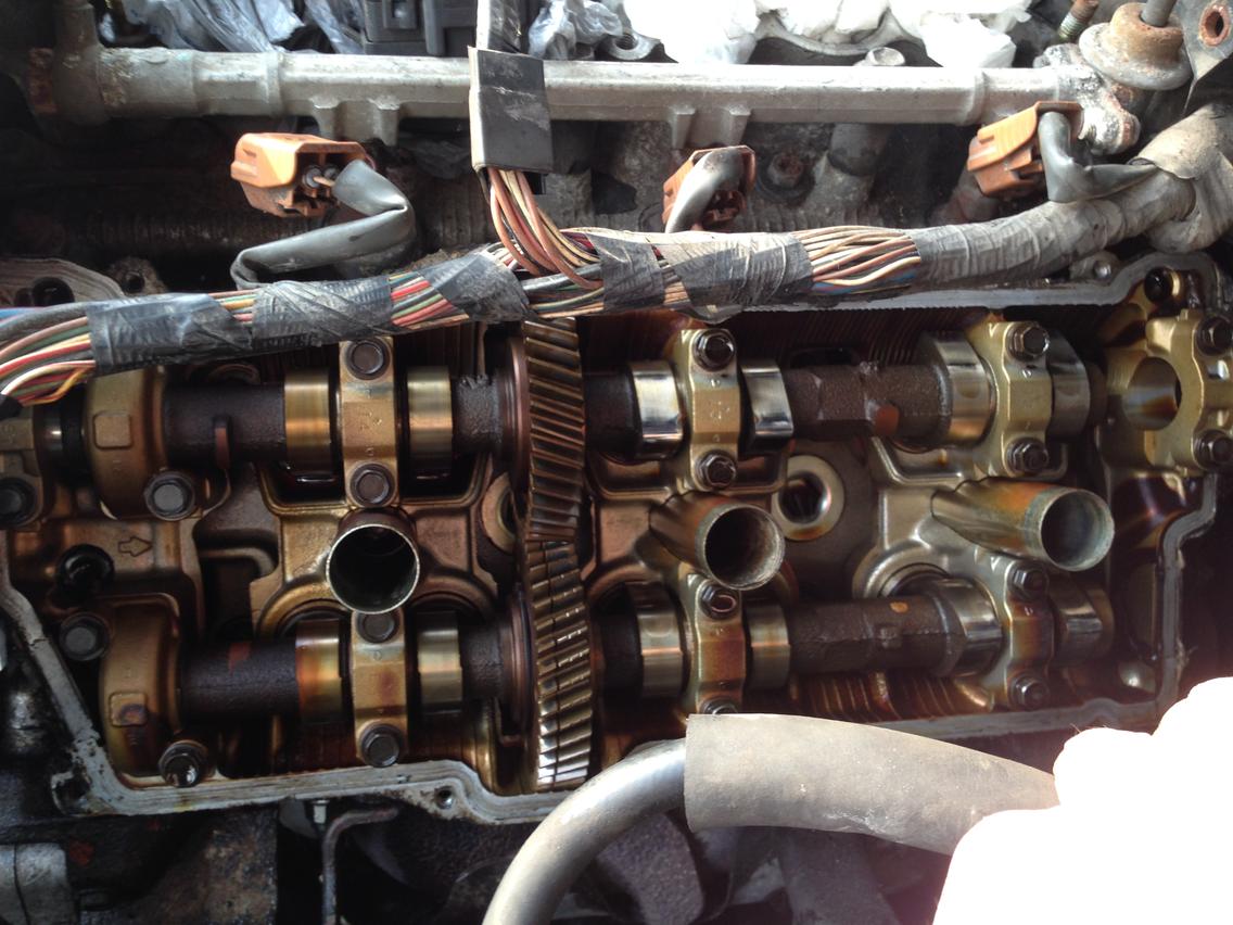

Everything was going smooth until a chunk of old seal packing fell off onto the head then disappeared under the cam shaft into what I assume is a hole above the valve. I can't see the piece anymore. The piece was approx 3mm x 8mm...
If this gets ingested into the cylinder via the valve, do you think this will cause damage or just burn up? I may try to get a shop vac nozzle under there (carefully) and see if I can suck it out.
Any idea how screwed, or not, I am?
its not getting into the cylinder from that side.
if anything it went down an oil passage and could end up in the pan which would be ideal. Not a straight shot though so it might live somewhere in between now.
It would not make it back up the screen on the pickup at that size or anywhere near it so it would sit in the pan if it makes it that far.

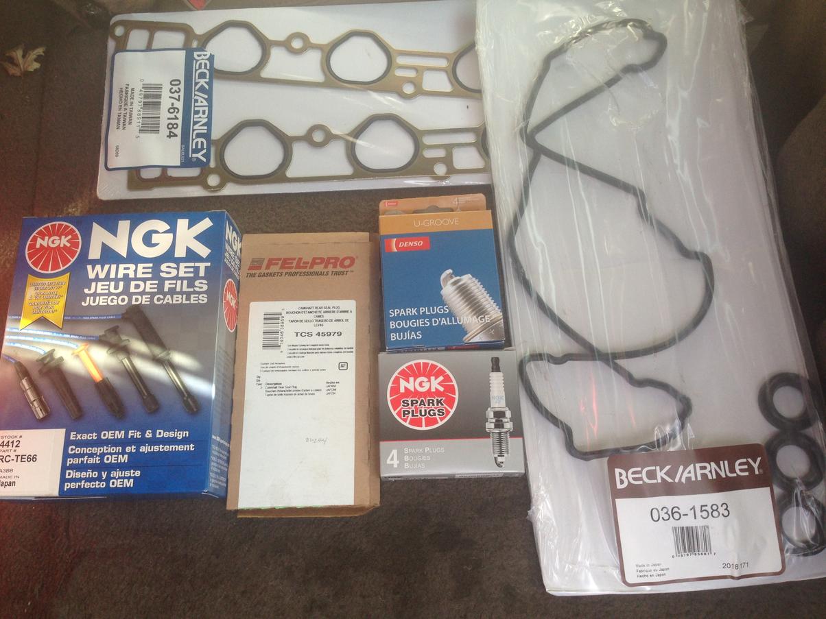

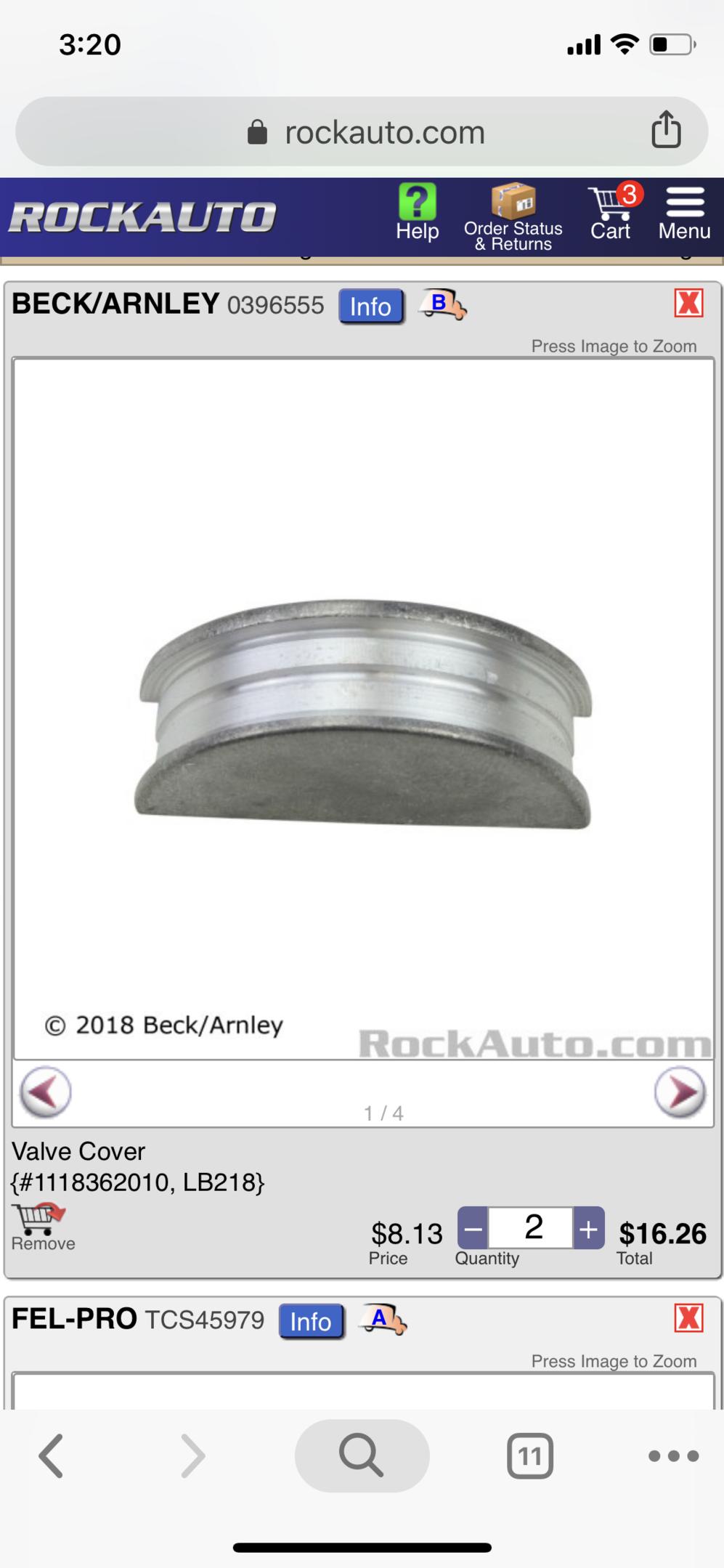

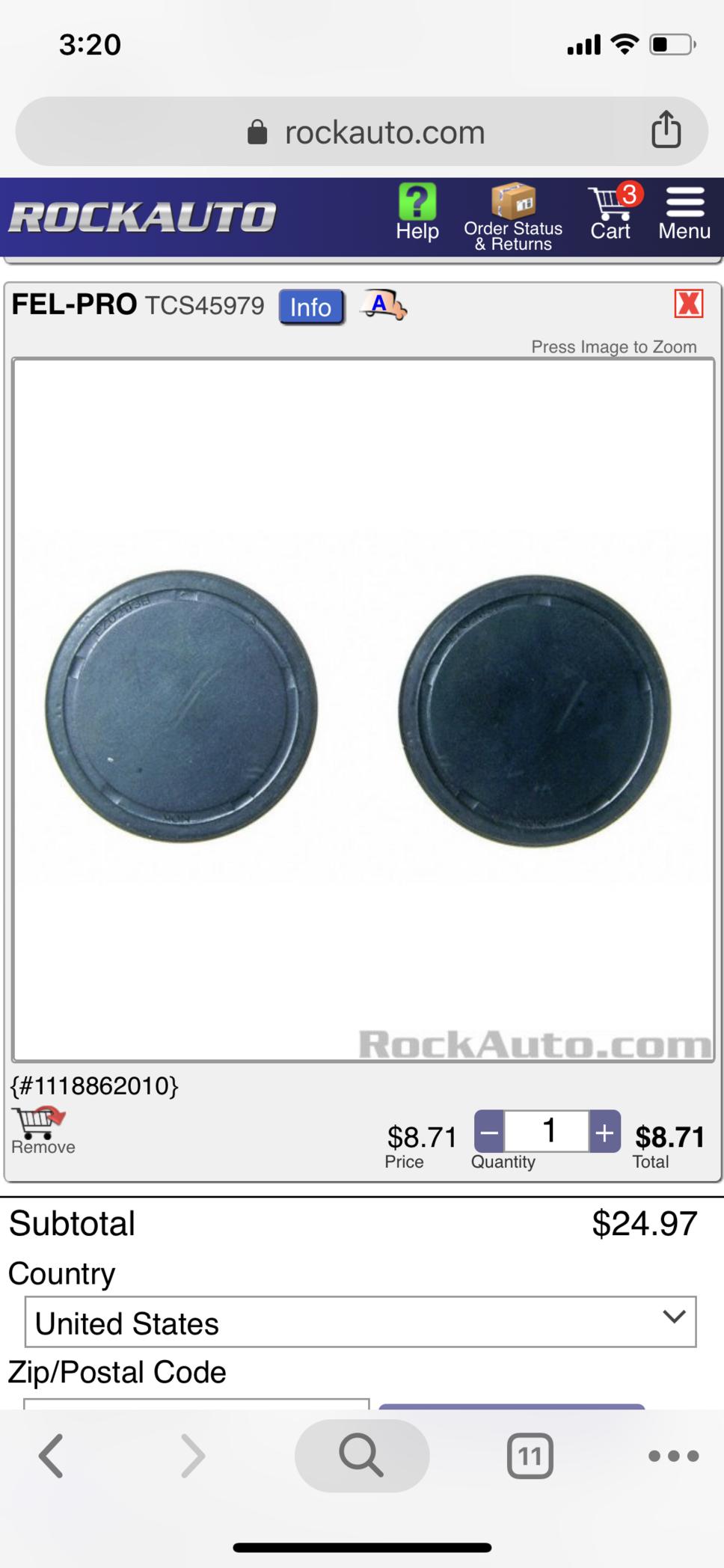

Can someone clarify if the cam plugs come in a pack of 2 or singles from Rock Auto. They show two in the pick which leads me to believe its 2 per pack and I would just need 2 packs.
Also are the half moon plugs single per plug so I need 4 total?
Yes, two cam plugs in pack. Bought those myself. Didn't get the moons halves tho. Mine were fine. Are yours bad or just a precaution?
Parts I used. Both type plugs have the two prongs.
