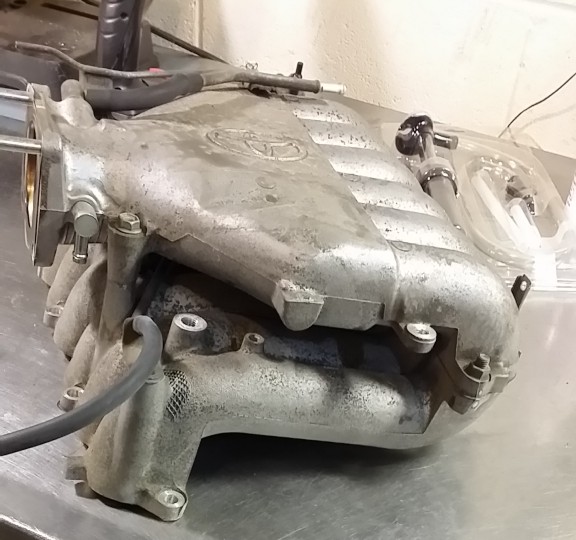

I’m going to remove the plenums in 2 pieces to replace the gasket but I’m curious, has anyone been able to remove them as one piece? Guy a few pages back was the only person I’ve seen that said it can be done. I don’t know if there’s enough clearance for the hidden bold to be removed
That guy did say he did it but I really don't see the big deal of separating the two halves. It's beyond easy and not that much more time.
Yep, it'll come off in one piece if it matters.
It doesn't really matter in my opinion. If you plan on putting it back on like that and you're going to torque the fasteners, how are you going to torque the long center bolt of the lower plenum? Even with a crows foot hooked up to a torque wrench you won't be able to get in there. I still don't understand what this gains, maybe 5 minutes of wrenching time? As part of this job, it's smart to replace both plenum gaskets anyway, so again, I don't see the benefit to removing it as one piece. But hey, to each his own.
Isn't there one long, black bolt you can't get to(or at least is hard to get to) with the top plenum on?
There is John. He had to obviously get in their with a open end wrench or better yet a ratcheting box end wrench to get at that center bolt. I don't get it like I said in my above response. Remove the upper plenum first. It takes like 5 minutes tops.
