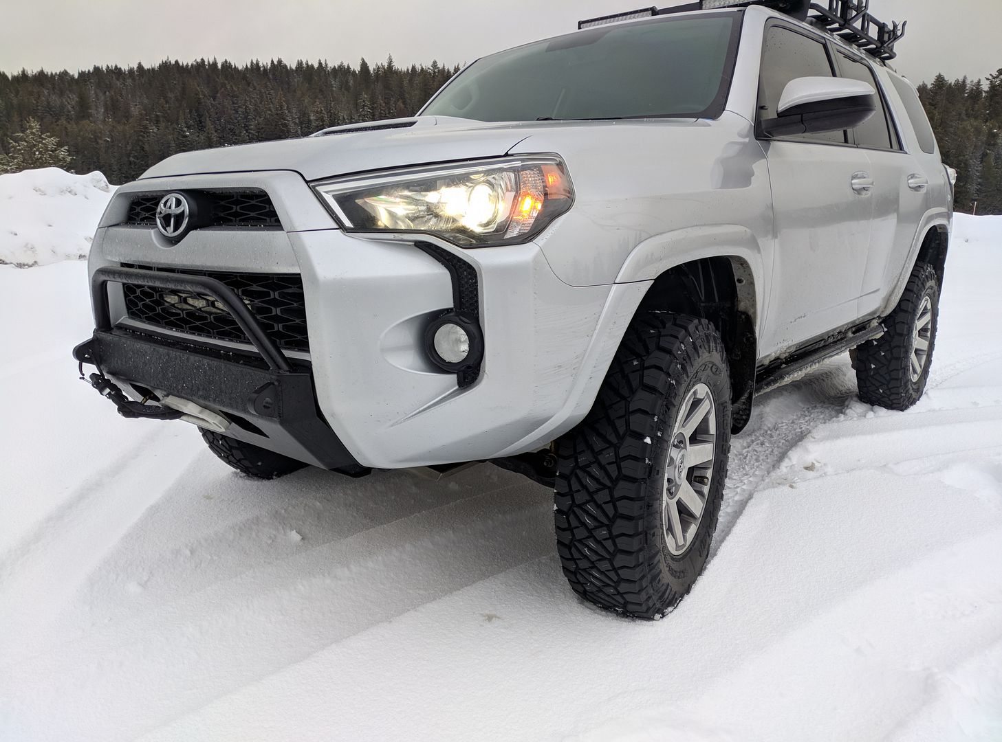

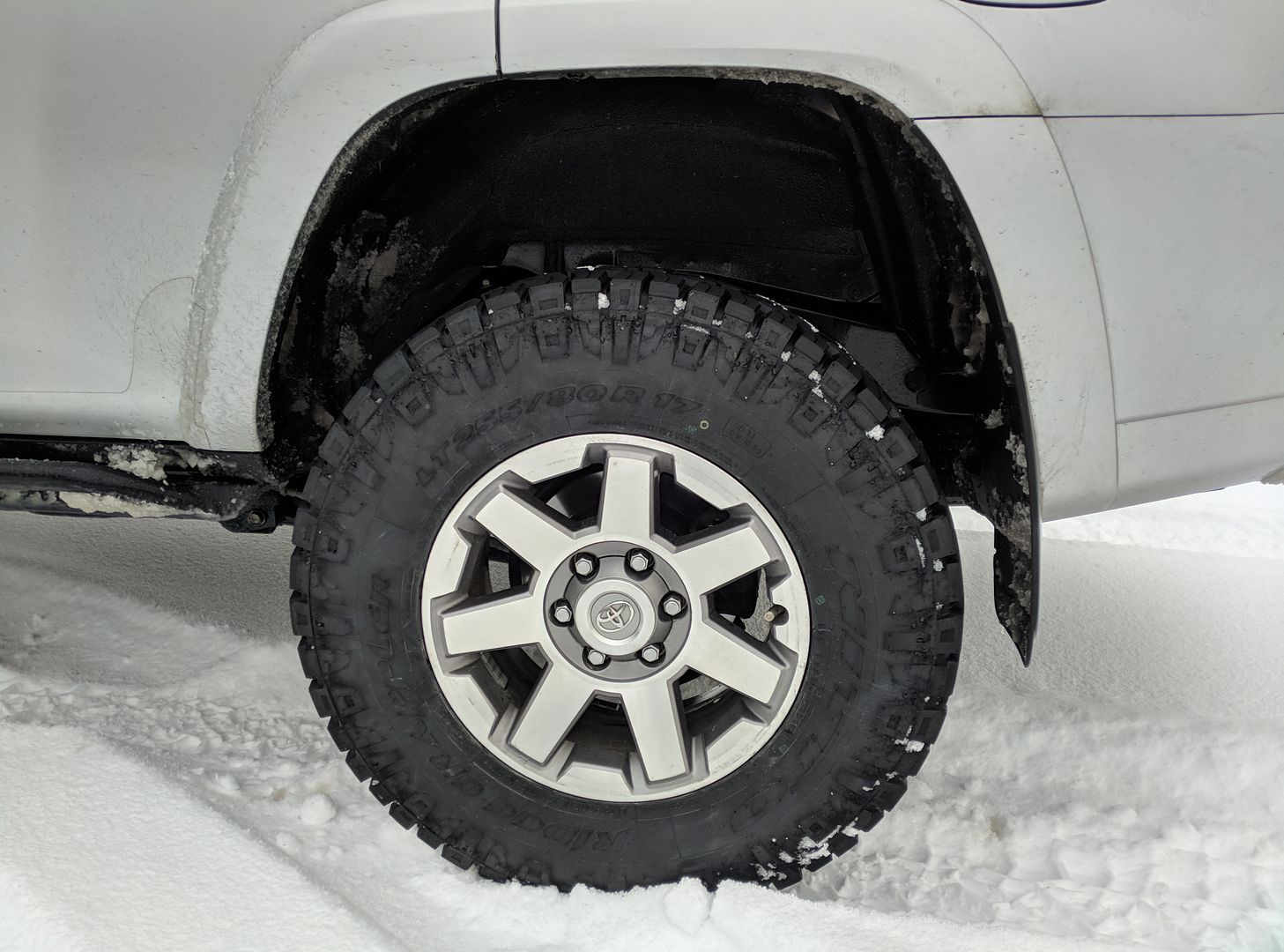

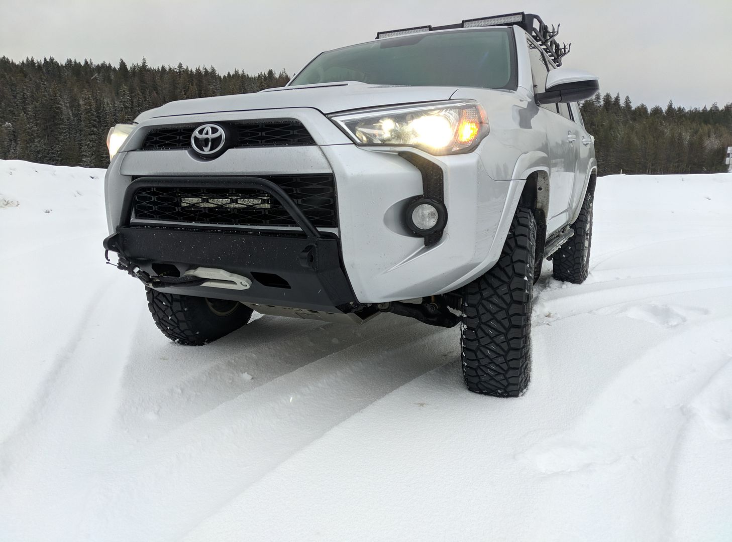

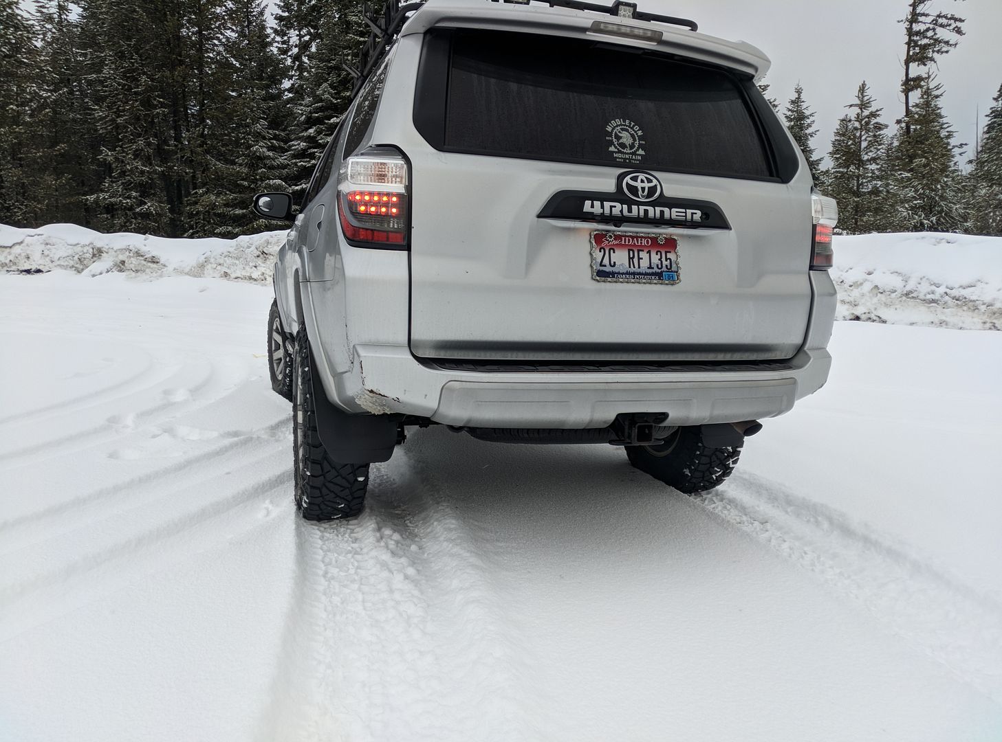

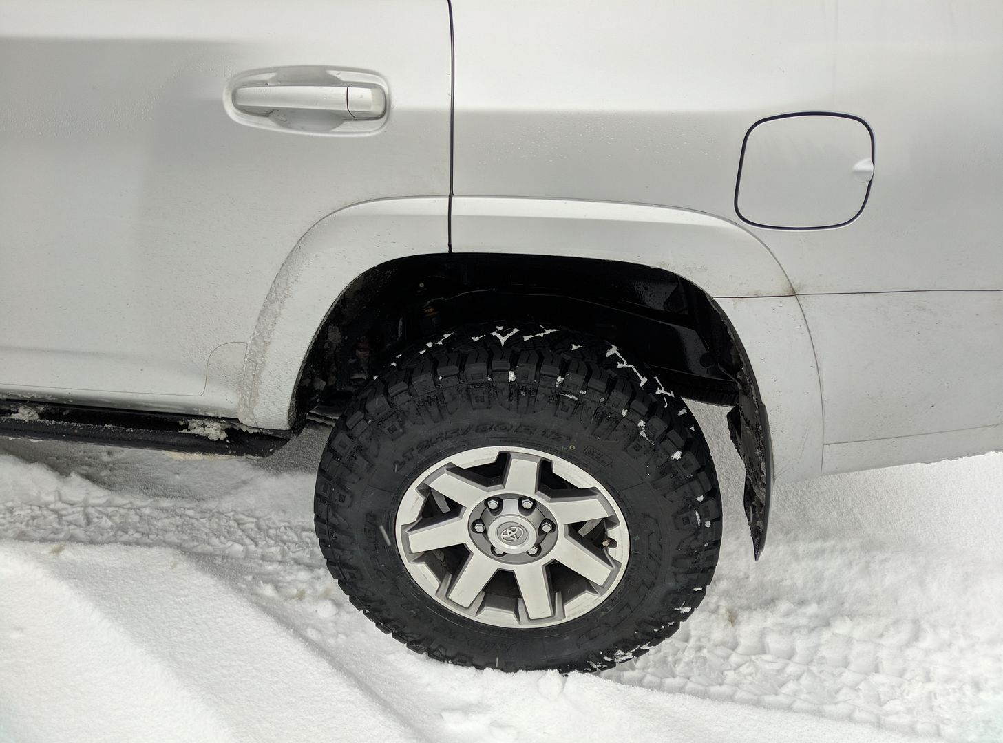

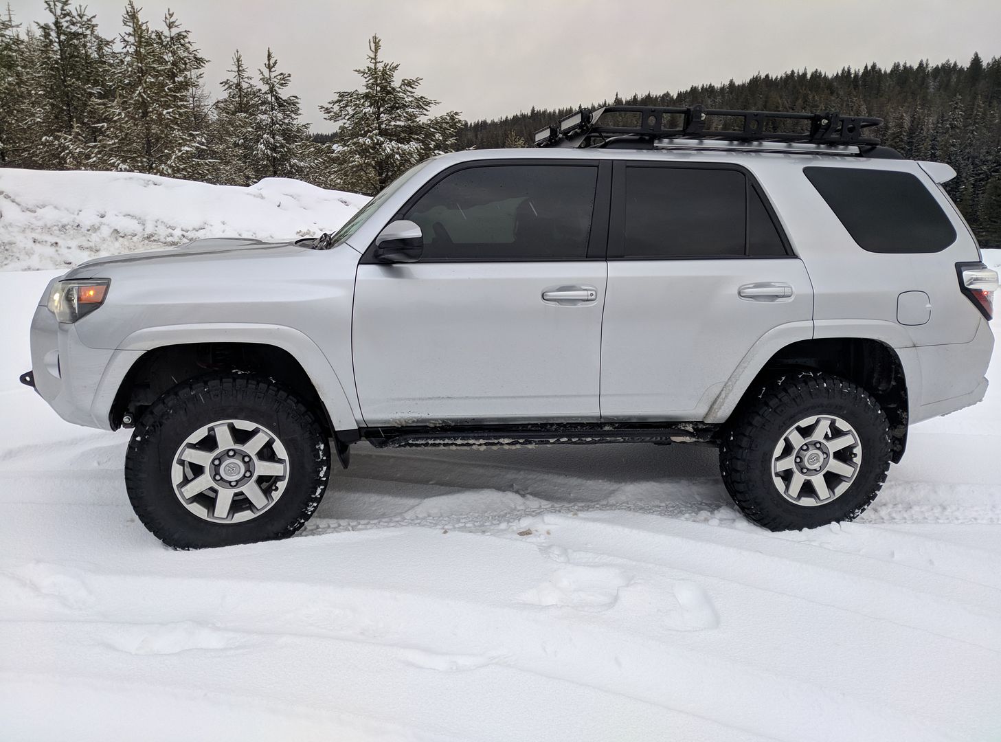

Final specs: the tire raised the height of the truck about 1 1/8". Some of that of course is new tread height + 80 vs 70. Tire height on the ground is 32 1/8".
Next up and final mod, Shrockworks rear bumper.
Here are a couple of pics of the pizza cutter look.
