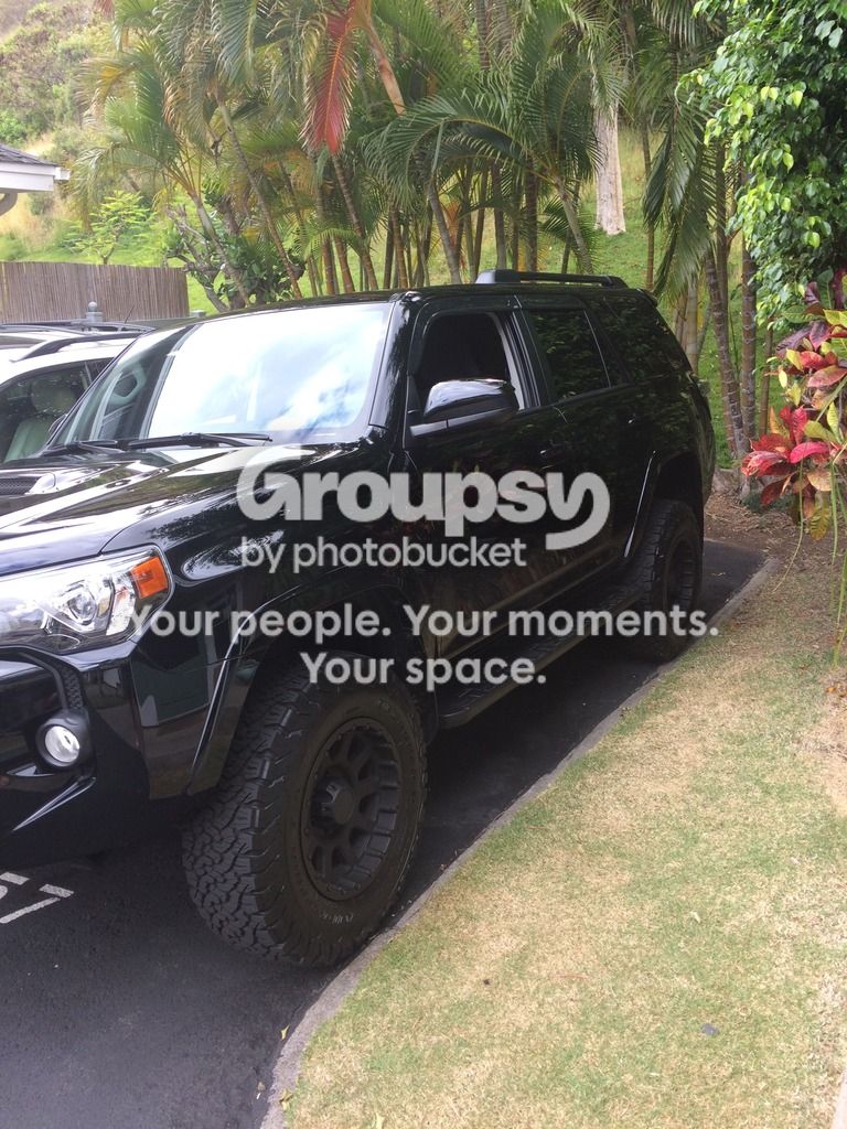

So i had to replace it with a 2016 Trail Edition but I don't like the wheels or lift. I bought it from a guy (had 4k miles on it) who did a 3" coil lift and added the aftermarket wheels (275/75/17). They rub when I'm backing up and it makes me want to punch a baby.

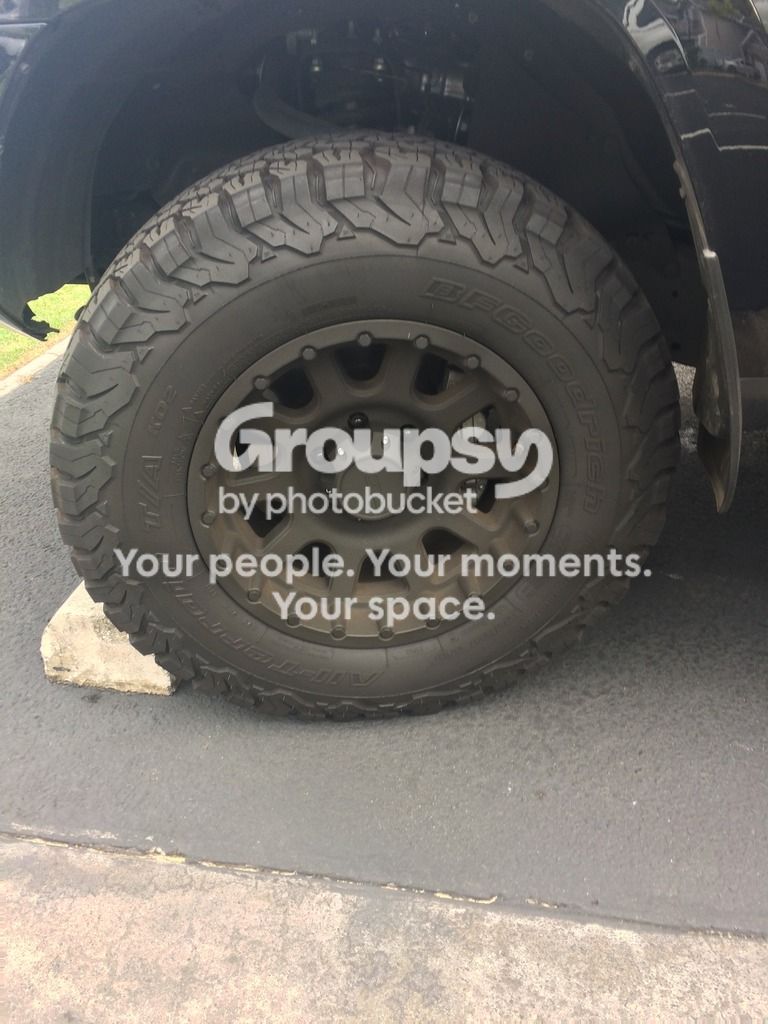

Close up of wheels.

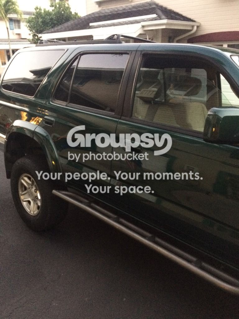

i'm thinking about putting the wheels from the '16 on the '01. I'm guessing they'll clear with a 3" toytec suspension lift and a 1" body lift.

Is the rubbing on the body mount or the fender liner? Do you have stock upper control arms? If not, do you have recent alignment specs?.
your 2001 has 16' rims right? They probably won't clear the 5th gen brake calipers.
Wheel spacers will make rubbing worse.

Thats a great question. I'm not sure if he an alignment done after install. The rubbing is the fender liner. yes, the 01 has 16" rims. I'm thinking of putting the 5th gen after market wheels on 3rd gen t4r.
Ok, the rubbing is an easy fix. http://www.toyota-4runner.org/5th-gen-t4rs/223710-285%92s-2016-4runner-trail-fender-liner-mod.html
It takes 15 -30 minutes an you won't need to punch any babies. I was asking about the alignment b/c you want to max out the caster with a 3' lift getting as close to +4 as possible. This pushes you wheels a bit fwd, away from the body mount. Trimming the fender is cake and cheap compared to a body mount chop.
If the rubbing is the only thing that irritates you, mod the liner and problem solved. The aftermarket lifted suspensions also get rid of the stock nose dive problem. If its the height that gets under your skin, new tires, new rear coils and adjusting the front shock heights will cost quite a bit more.
Also, check to see if the previous owner did a diff drop as you will probably want one to correct the geometry.
16" wheels will not fit any 5th gen. 17" is the minimum diameter to clear the brake calipers. Spacers will not fix the issue. 17"+ only.

I did the fender liner mod to accommodate 285/70/ 17's on a stock suspension while I saved up an purchased a lift. I had rubbing, on the body mount, in reverse at full lock. Not sure if I would have to do the liner mod if I lifted first.
My tires have a 32.7' diameter, yours have a 33.24' diameter and are a bit skinnier, but you still have rub on your fender, therefore same mod, for different reasons.
Spacers can also cause rubbing, so although the reasons for rub are different, the fender liner mod is applicable in all 3 scenarios.
