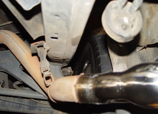

hey momo, since the resonator is attached to a hanger, is it necessary to use the hanger after the resonator is removed?
The exhaust shop used the hanger to help secure the end of the pipe. I think if you did not use it, the pipe would bounce a good bit.
so basically they cut off the resonator, added a piece of bent pipe, and attached a hanger to the pipe to use the existing resonator hanger? did I get that right?
ETA: can you get me a close up shot of the pipe??
thanks

hey momo, I've got an appointment to get the mod done this saturday....any chance you could snap a quick picture of the hanger etc. so I can show them how I'd like it done?
Lou,
I did the same mod as Momo. Take it to a custom exhaust shop that can do stainless. The hanger is straight forward for the shop to figure out. You'll see once it is on a hoist. Hard to get a pic of it from the ground in this weather.

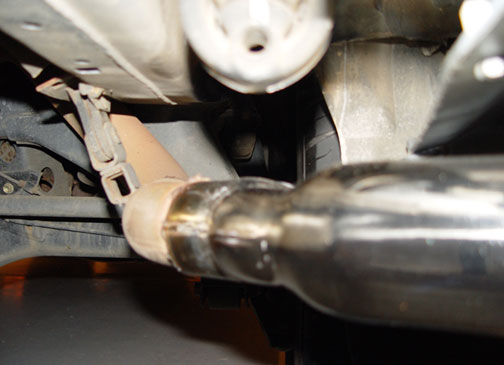

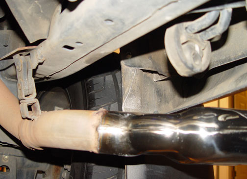

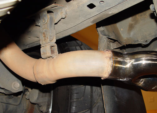

I was wrong. When I got up under there I realized they didn't use the exhisting hanger. You will see in the pics there is a hanger holding it, but I am not sure if that was there before or not. You can see the old hanger not being used. Hope these pics help.
Last one.......Hope these help. Post some pics after you get it back.
I did this a long time ago. You can see see pictures of it by following the link in my signature. By turning out the exhaust, the sulfur smell in thru the back window also was cut down considerably.
