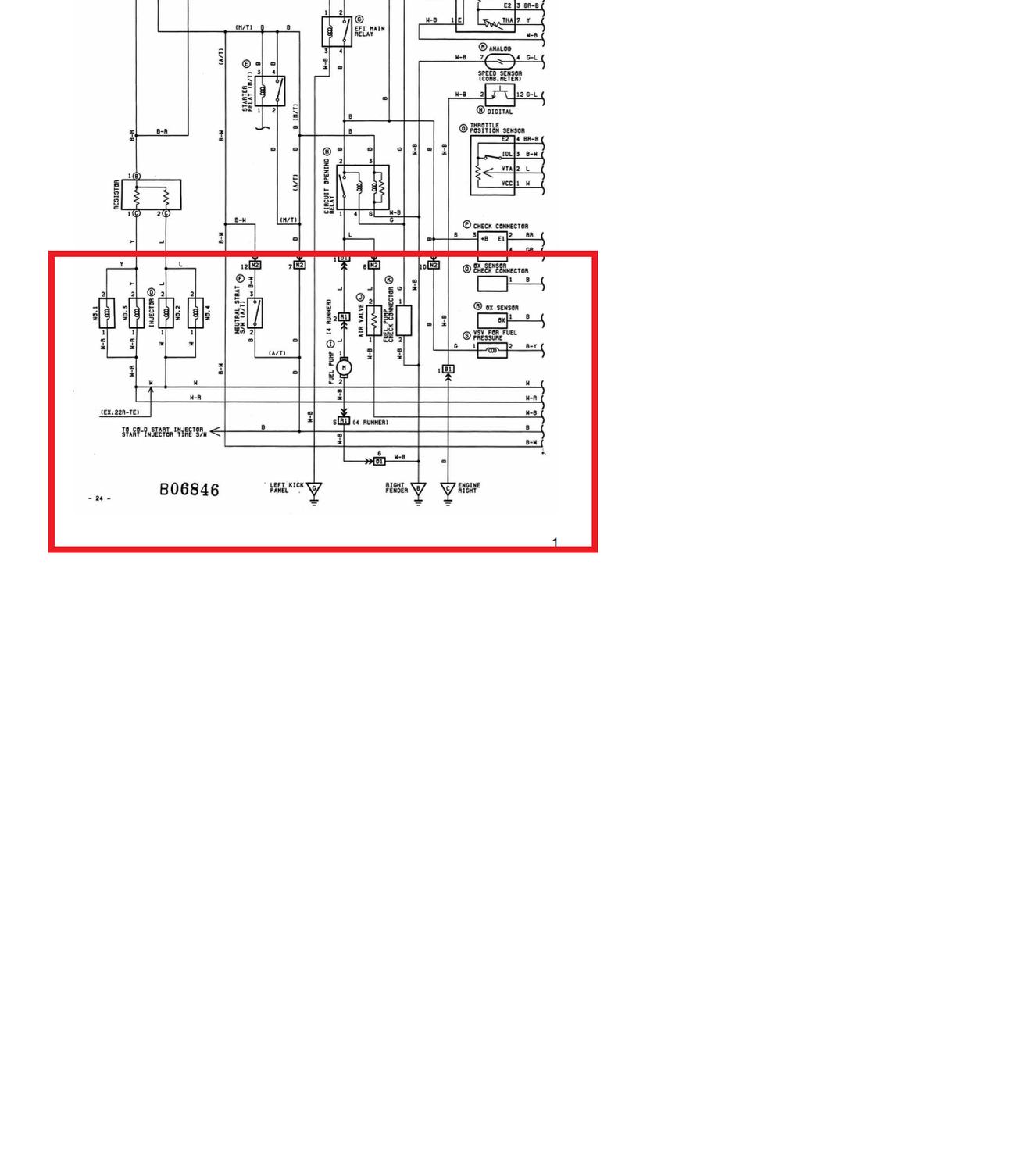

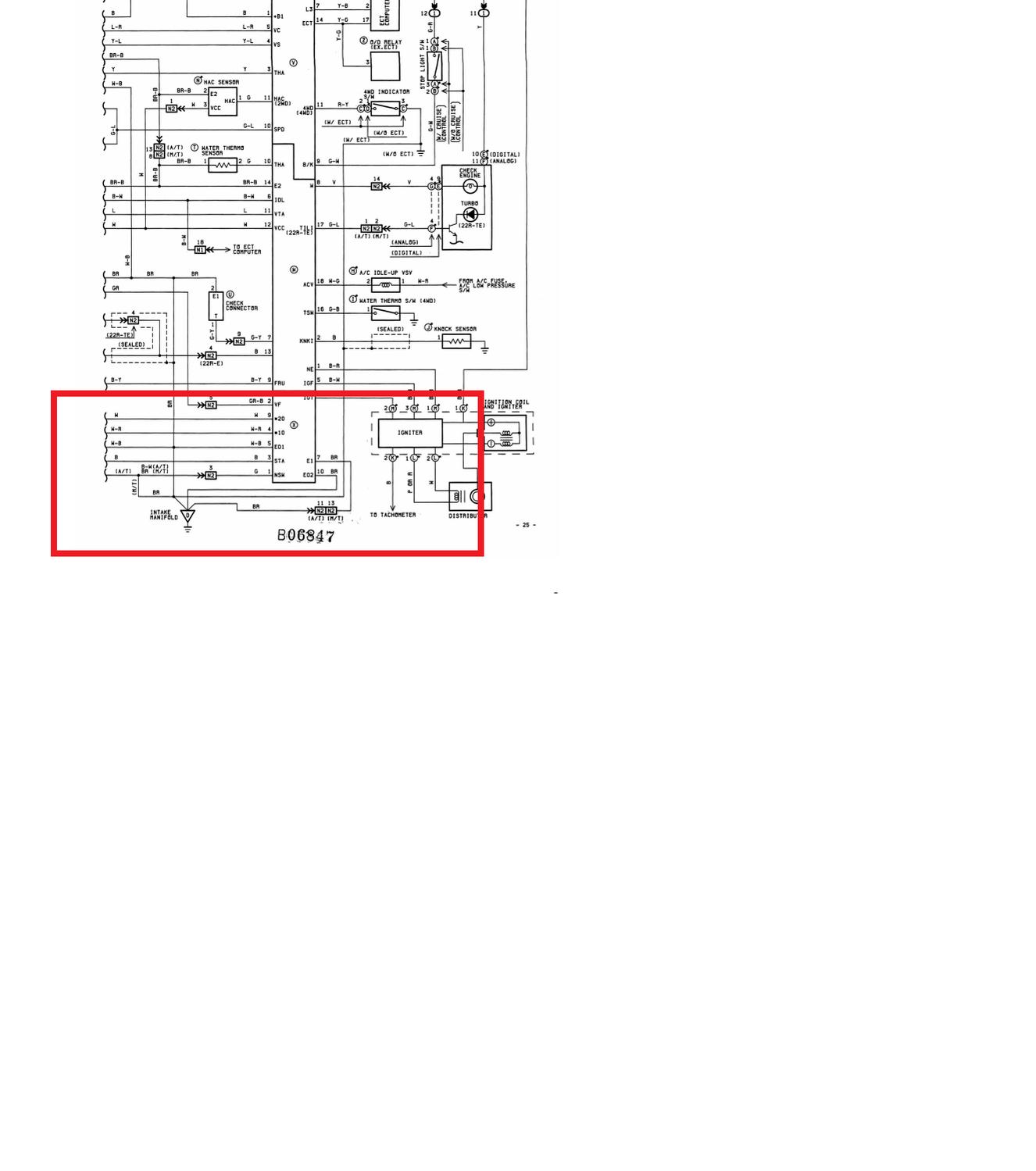

edit: It's been a while since I looked at the wiring diagram but there are two power wires for the fuel injectors. I'm not sure if each wire controls 1-2 and 3-4 or 1-3 and 2-4. Double check the wiring diagram. You may have a wiring issue that is causing your two injectors to not fire.
Definitely a wiring issue. See the attachments below. The injectors are controlled by two wires. You have a bad wire that controls the 1 and 3 injectors. Test the wires and find the bad spot. Replace or splice that wire and you should be golden.
Ok so had a thought when I was starting to track the wires. Shoulda had this thought to start with. I get power to all my injectors. How can it be a wire?
Possibly a broken ground wire but not one of the power wires.
Im gonna check ground wires but if one of them were broken wouldnt it keep power from being read at the injector plug?
It could be a coincidence that your #1 and #3 injectors are bad. But I would be willing to bet you have a bad wire. Where did you test to get power at all injectors? Did you test it at each plug using both terminals on the plugs?
I tested at the plugs. each side individually to the injector ground. I agree that it would be one hell of a coincidence that #1 and 3 went out and it not be a wire
How about swapping the known good injectors with the ones that aren't spitting gas, and see if they spit gas. If so - it will confirm that the wires need tracing.
