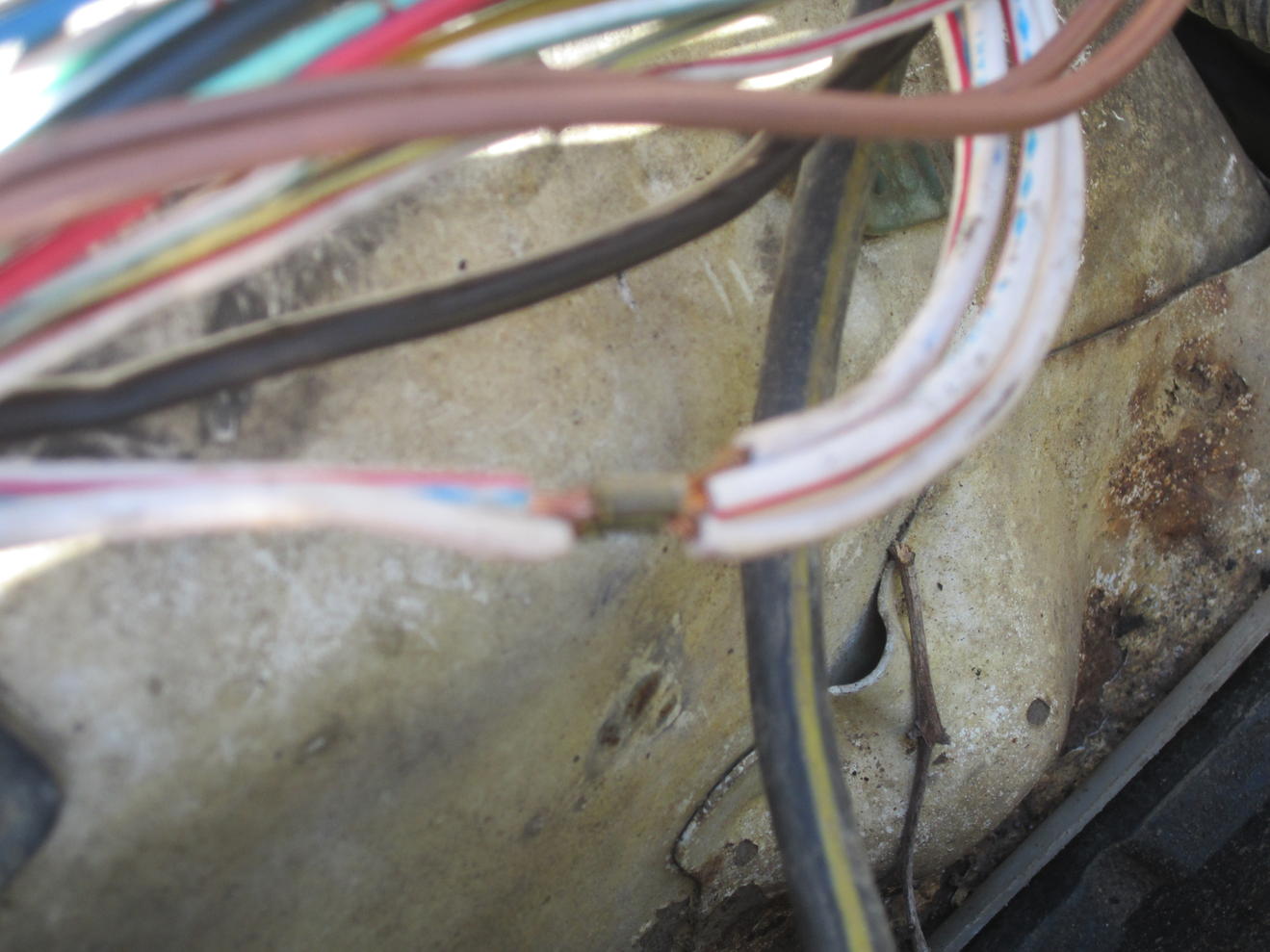

now here is where Im lost. all the power wires come together in 2 places. The yellows stay on their own along with the white. With the yellow wires #3 and 4 come together then join #1 and 2 later. here is a pic of what im seeing. It confuses me. Not the best pic, Im not a photographer
There is no broken wires anywhere.
The Yellow wire goes into the dash. Im guessing to the ignition.
Could that have anything to do with it?
My guess would be no but Im learning a lot here these last couple weeks

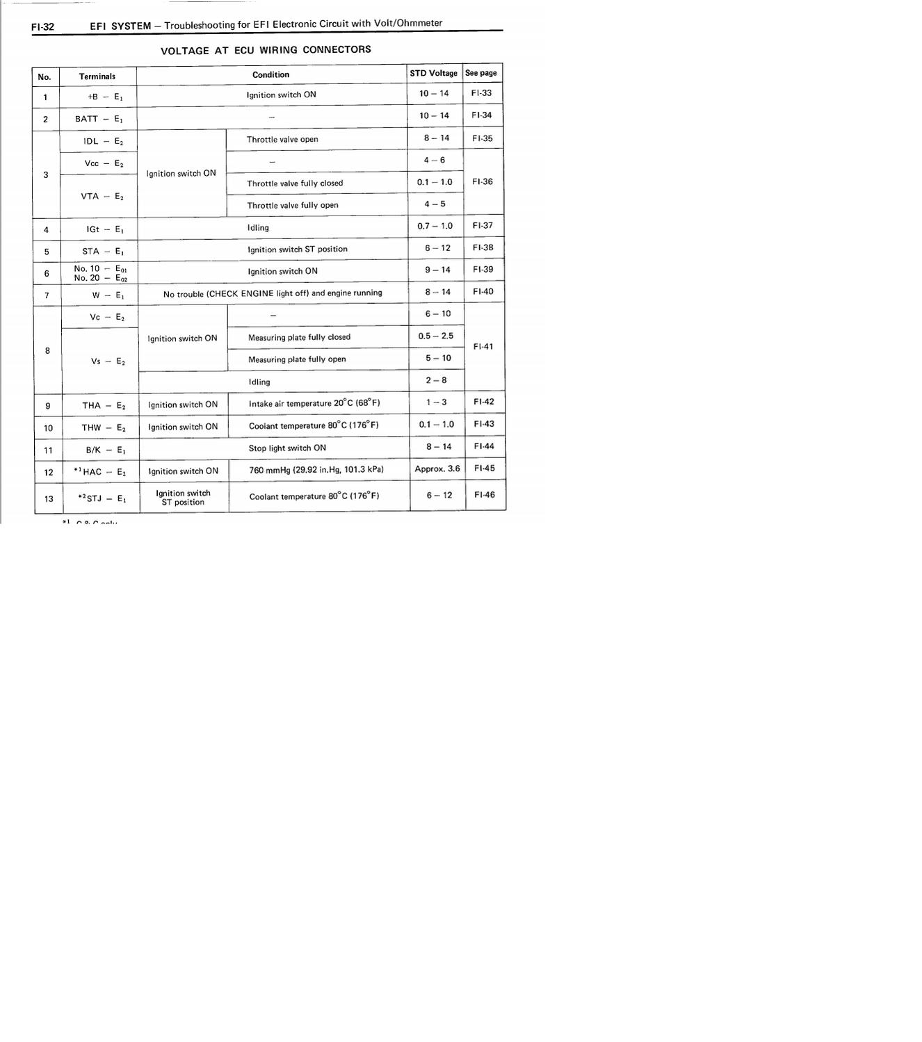

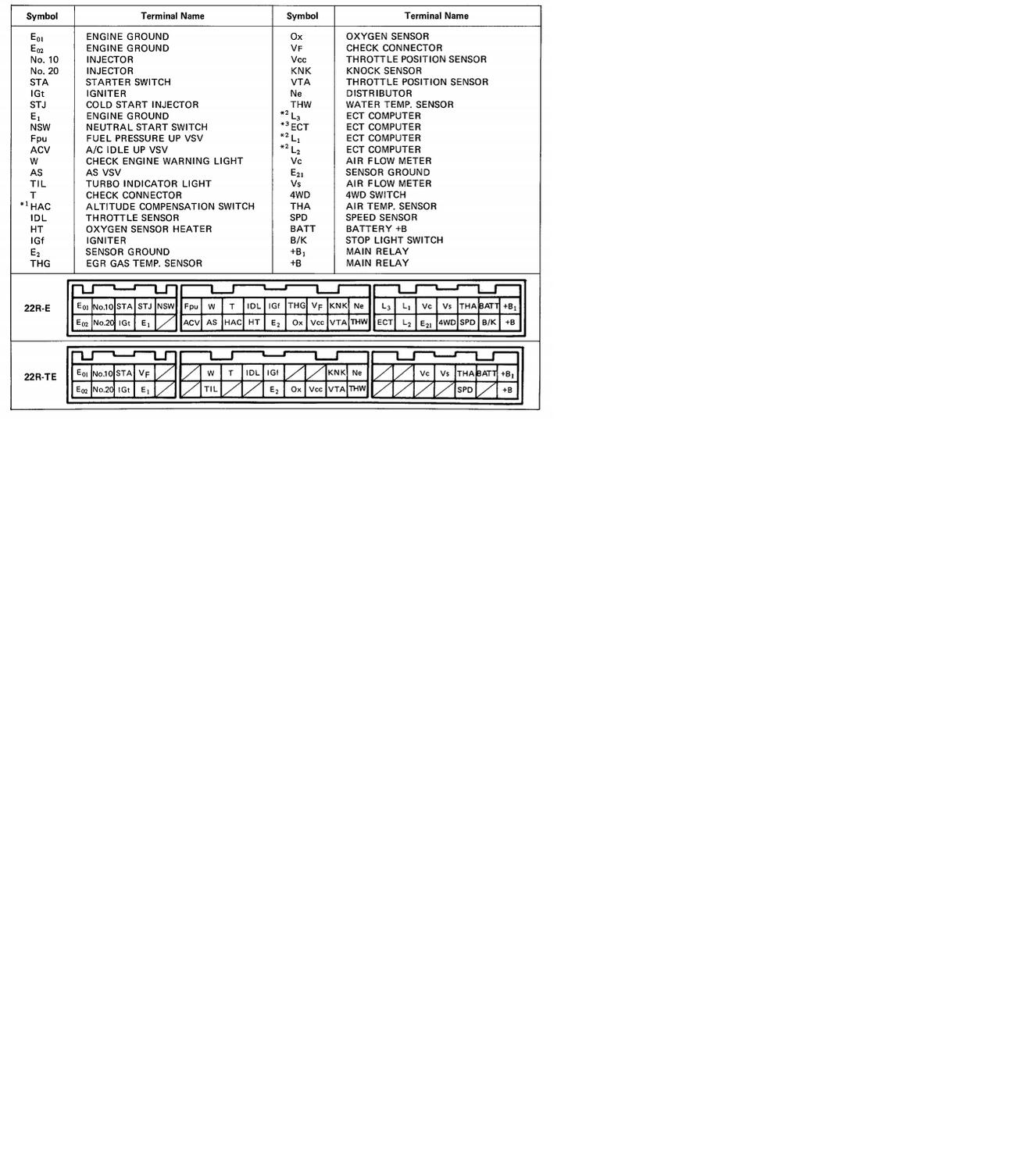

It could be your ECU but you already said that you're getting about 12 volts at pin NO10/E01 and NO20/E02 when the ignition switch is set to "on" right? If so then I doubt that your ECU is bad.
The first attachment is the ECU pinout. Make sure that the pins on e01, e02, no10 and no20 are clean and free of corrosion on both the ecu and harness side. Also make sure that the pins are seating fully when plugging the harness into the ecu.
Next, use a multimeter and do step 6 of the second attachment. If you're passing that inspection then your ECU should be good.

#10-Eo1 failed got 32 millivolts
#20-Eo1 passed got 10.2 volts
Gonna test again later to see if I messed up. In the meantime Im gonna look for an ECM
It might be your ECU. I thought you said before that you're getting 12v at those pins so I ruled out your ECU.
