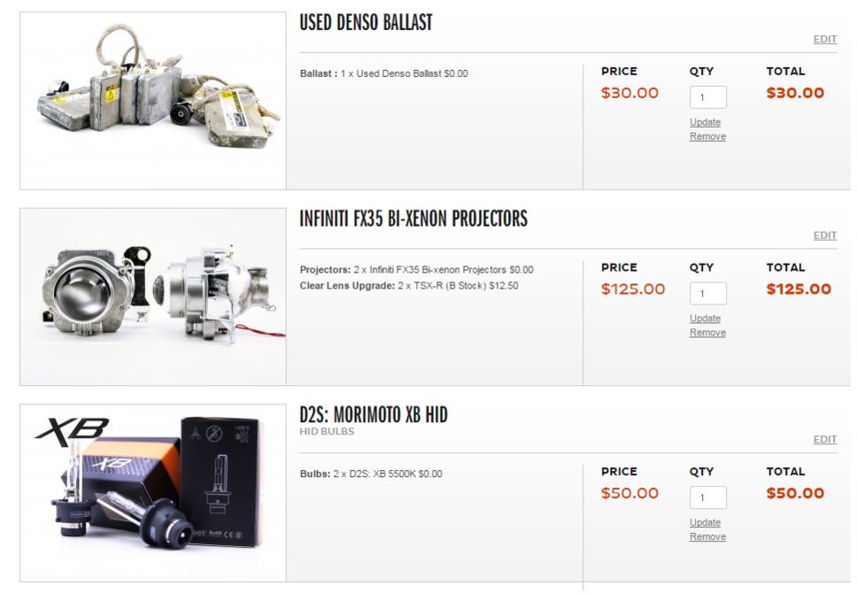

$200 Budget retrofit below ....
:surfer:
If anyone is interested in a budget retrofit I'd suggest PM'm me.

Another tip ..... it is much cheaper to configure a retrofit on TRS's website by using the "Buy as a kit" option from the drop down menu than to add the parts to your cart manually. You save cash when you configure as a kit.
Of course you can save the most cash buy buying discount, clearance or slightly used parts!
