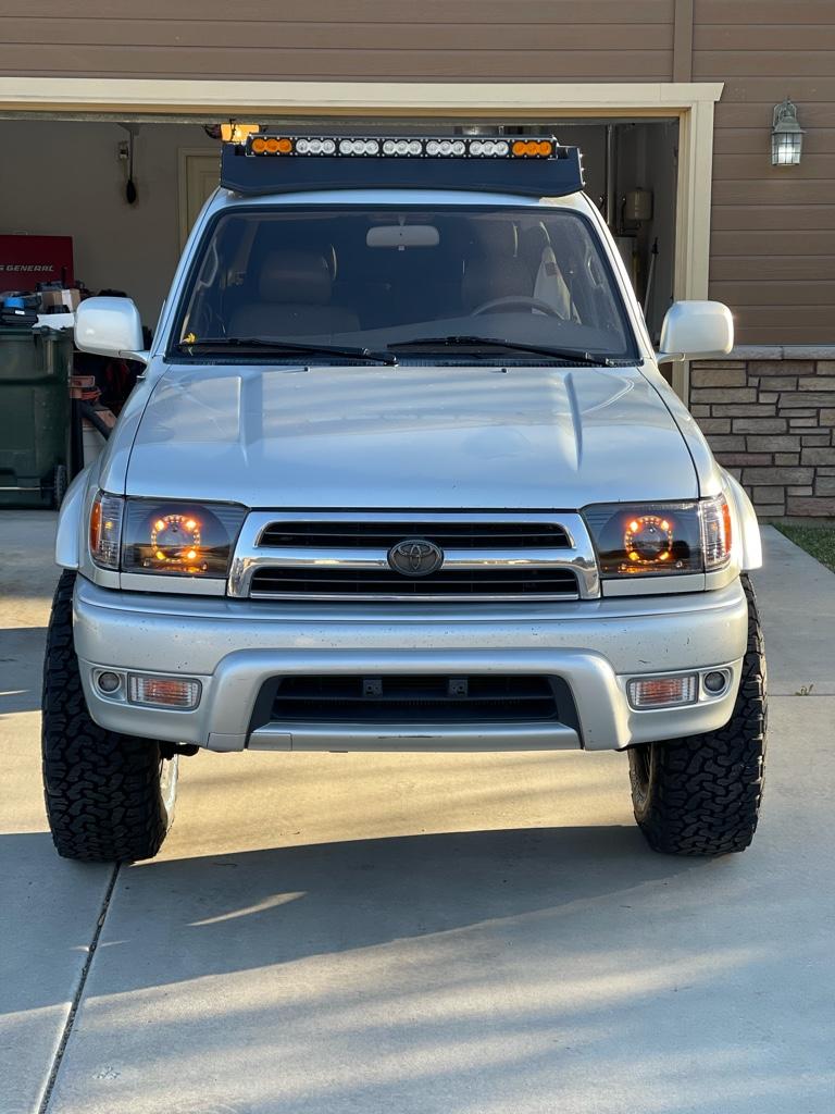

Hey guys making this post to share with you guys my retrofit headlights, i absolutely love these things and they are worth every penny and I think it’s safe to say are my favorite mod. RVS Built is a newer company and I was skeptical about using a newer builder but after talking to him we actually became friends (I helped build his Shopify website also) he was kind enough to actually put a code in the system for anyone who I give the code to it will save them $50 off their purchase. Highly recommend you guys check him out and his work, the paint work is very nice on the inside and he adjusts them for you so when you get them if anything you have some MINOR adjusting to do to the headlights. Great company and a great guy. Lead times are very low since he is a new company and I had my retrofits at my door not 2 weeks after ordering
Use code “RoyT4R” to save $50
RVSbuilt.com
* I’ll put some more up close pictures below*

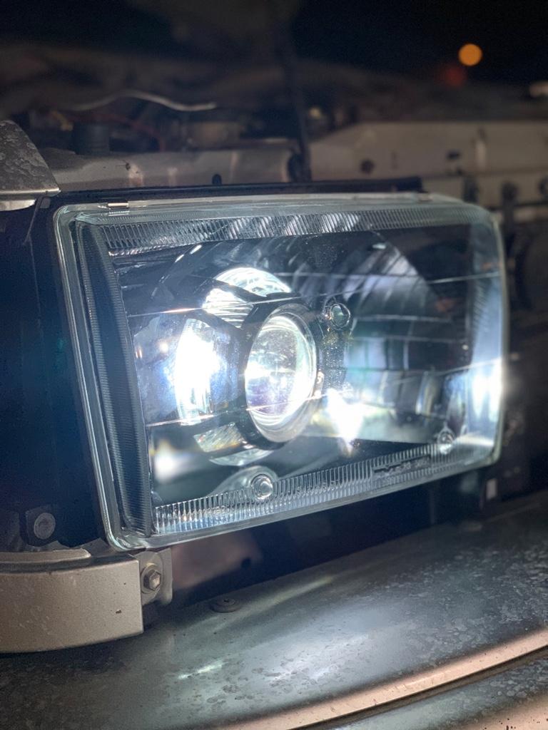

Here is an up close picture, it’s a little smudged from the install lol
Looks good and pretty competitively priced. I would give my third nut for someone to make our corner lights match the look of projectors somehow, pretty much the only thing that's keeping me from getting a pair.
Looks good.....

I agree they look a bit odd, but its hard to argue with the light output of them.
On mine I used a pre-MCA reflector with a post-MCA glass which I think made for a pretty clean look.
Along with blacking out the original chrome reflector areas and shrouds, painting the projector cutoff shields black at the front-facing side helps hide "bug eye" look and does not affect light output. It's known as "passive demon eyes" among the projector retrofit crowd.
Here's an example. The white areas in the lens are just reflections from the table surface; stripped the chrome finish off the shroud by soaking in Purple Power cleaner, glossy black surface was beneath the original chrome finish - I later scuffed with a scotchbrite pad then painted satin black.
