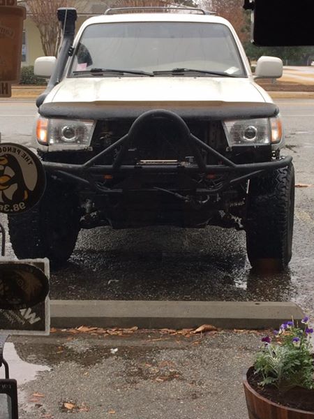

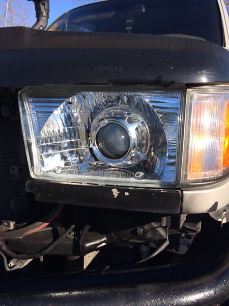

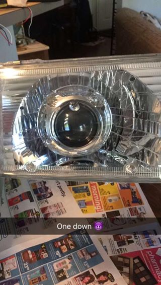

heres some pictures, sorry for the wait, real life drama going on as always. Feel free to shoot me any questions or feedback!
